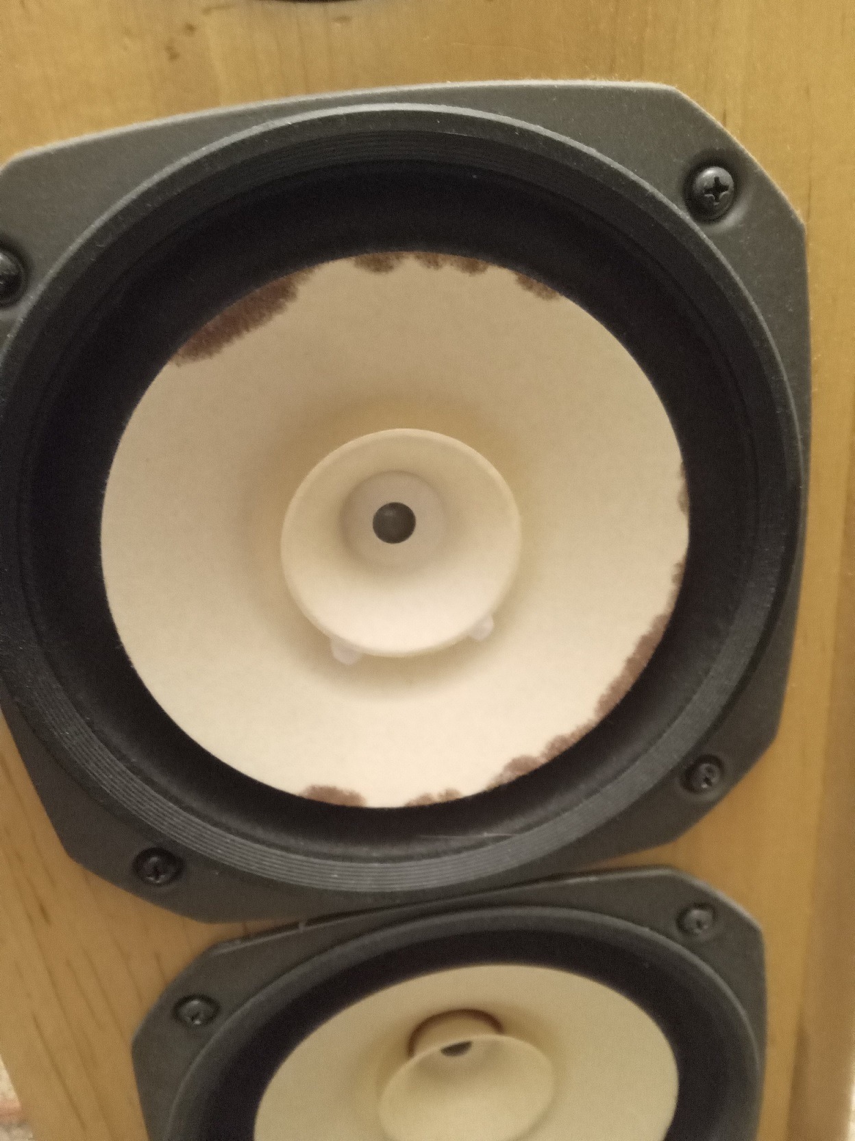

I have a set of 4x FE164 in DIY cabinets that have been stored unused in my living room for several years. Long story short, I moved here to a new job and before I could move fully in the job became very unstable. That insecurity kept me from fully moving in and setting things up so I set them - and a lot of other things - in what I thought was a good place while I waited to see what would develop. My job situation just improved - dramatically - after a lot of hard work, and to celebrate this weekend I'm starting to unpack and really get moved in.
What I found was pictured below. It looks like the cones are molding from the outside in. Probably because I faced the drivers towards the wall to keep my wife's dog from clawing them every time she wanted attention. I didn't store them in the basement that was supposed to be my den because I was afraid of humidity and anyway the "den" has been storage, I thought the living room would be safe.
Am I right that this is mold/mildew and if so is there any way to get rid of it without destroying my FE164's? I feel a little sick right now, should have checked on the things earlier but the last few years have been a heck of a roller coaster ride.

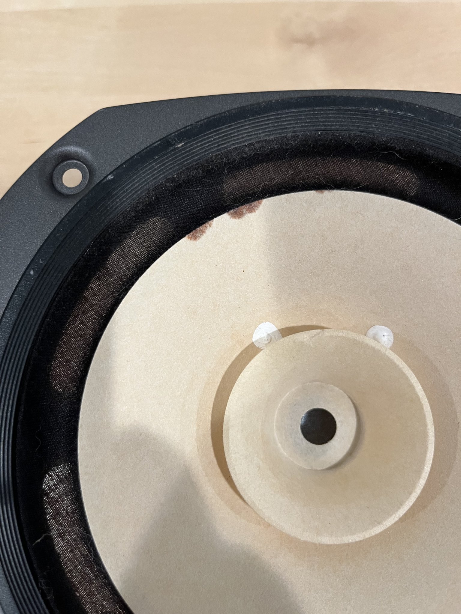

I have an FE164 that is doing the same thing, and the surround on the other has become sticky to the touch. I think what you are seeing is the coating on the surround or the glue degrading over time and seeping into the paper. Also, maybe my imagination, but I don’t recall the surround being see through when they were new.

ModPodge? Just looked it up. Sorry if I'm a little slow on the uptake but the last few years I've not given a thought to DIY audio with everything else going on. So should I coat the cones to fix their appearance and maybe improve them sonically? Or is a reglue of the surround to cone needed? They seem dry, which is why I was so surprised. I reckoned that the dark environment near a window would be the problem.
Hi Rory,
Thanks for the info. Dang, I hadn't even thought of that, but I have had these drivers since some time in the late '90's or early naughts. Do you think its just cosmetic or do I need to implement some kind of fix to make it "right"? Right now I'm in "do no harm" mode while I try to figure out what the heck is going on.

You can add a bit of black arylic paint to the midpodge to make the whole cone black.

Or white if you want to retain more of the original look.You can add a bit of black arylic paint to the midpodge to make the whole cone black.
Black would certainly cover the stains better thou.

Okay, been playing with the FE164's for a few days using a Fosi class D amp. Sounds like they needed to be run in again after all those years in storage (just realized it was almost 2 decades - my last apartment wasn't big enough to set the 2A3 based hifi up). Set 'em up to play for a few hours while I was working upstairs as a test of the drivers. Glue seems to be holding fine, even after I punched up that class D amp with some heavy bass tunes.
Looks like the "running glue/coating" is just cosmetic damage at this point but I'm starting to think dangerous thoughts about putting on a baffle overlay and replacing the FE164's with a single FE168 Sigma per cabinet. 26 liters and I can change the port tuning to about 60hz or so. Modeling with WinISD now. Any opinions on the FE168 Sigma in this application? I'd like to make this my critical listening system with 2A3 SET and CD source. The 2A3 needs some work after all these years too, checking caps etc.
