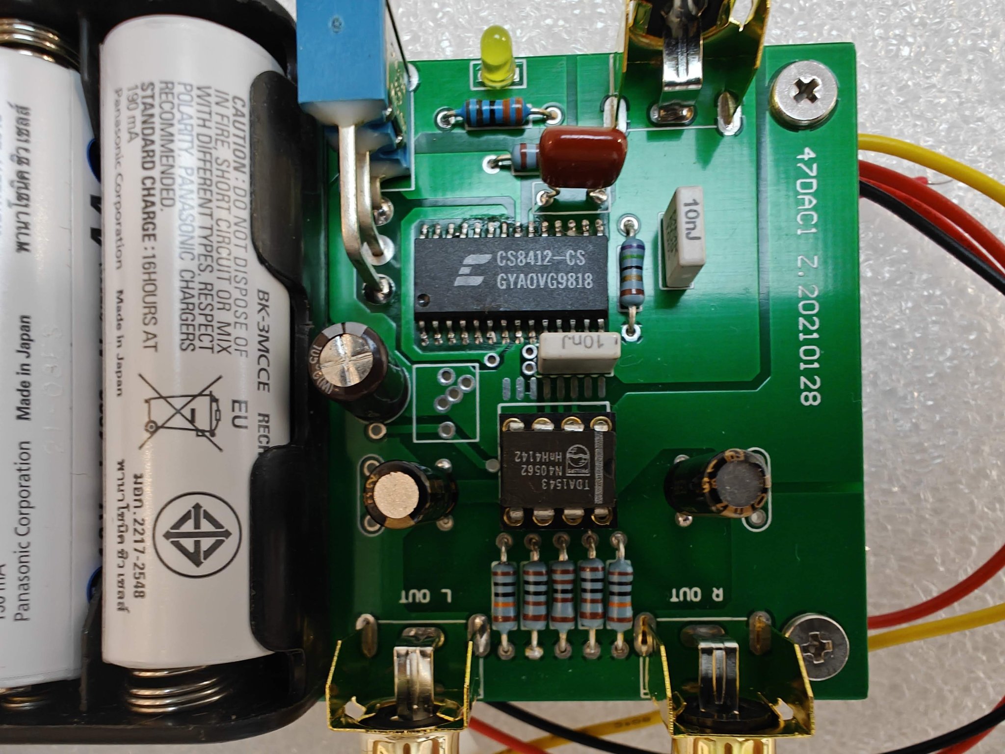

Hi everyone, I'm new to DAC and would like to try different DAC available in the market. Recently I purchased the ProtoDAC, which works directly with Raspberry Pi through the I2S interface, and everything works like a charm.
The ProtoDAC comes with a DAC module, which is basically 8x TDA1387 in parallel. Having checked the datasheet of TDA1387 and TDA1543, both of them use the I2S protocol. Therefore, I replaced the TDA1387 module with the TDA1543 IC by mapping the I2S (WS, DATA & BCK), VDD and GND pins. Unfortunately, I could not get pure music but a mix of music and noise.

At first I thought the TDA1543 was faulty, then I purchased a couple of them from different vendors but all of them exhibited the same behavior, Then I purchased a finished kit which converts SPDIF signal to I2S, and all TDA1543 worked fine.
The converter KIT has a CS8412 which converts SPDIF signals to I2S signals. Again, having checked the Datasheet of CS8412, I confirmed that the output was configured as I2S mode.

Attachment is the converter kit and it works flawlessly when fed with SPDIF signal. Could anyone point me to the right direction? I feel frustrated. Thank you.

My 2 cents you have a mismatch of I2S format - while TDA1387 is OK with it, the other DAC chip expects some different format. Bit-shifted/mixed samples typically produce noisy output yet with discernable music, not working volume control (the MSBs are misaligned).
E.g. TDA1543A is right-aligned, while TDA1543 is standard I2S - this can be adjusted in DTS overlay.
Maybe your I2S has 32bit per sample (i.e. 64bit frame) which TDA1384 may accept and TDA1543 may not - best to use S16LE format for the I2S alsa device to avoid this possibility.
It's good to check the digital format with a 2+ channel oscilloscope and a suitable playback signal which reveals position of the MSB.
