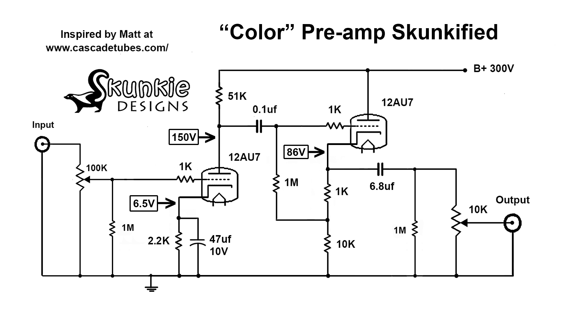

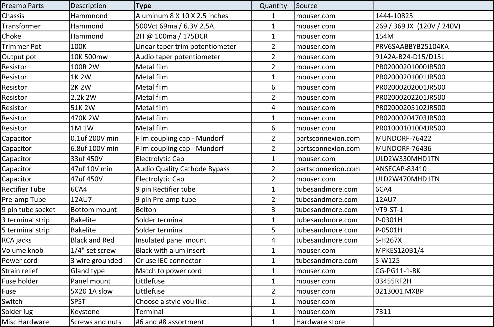

I was wondering if any here on this site could shed some light on The color preamp mod from Skunkie Designs. I ordered using the posted bom but I think I am missing resistors. the diagram shows 6 1k resistors and some 10k resistors but I do not see it on the bom. I am new at this and a little confused.

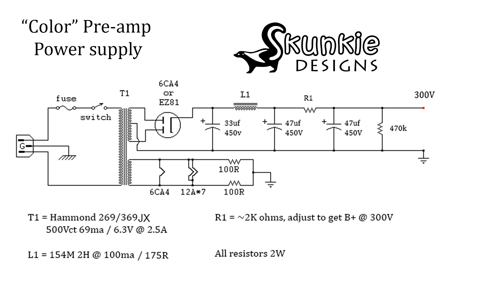

Doesn't compute to me either.
Have the six 1k's been replaced by 2k's ? but then you have a 1k unaccounted for in the BOM. Then there is also the single 470k mentioned.
Either the BOM or the circuit (or both) could have errors at this point as I see it. I see the BOM also has PSU parts on it.
I think you need to question it with the supplier :)
