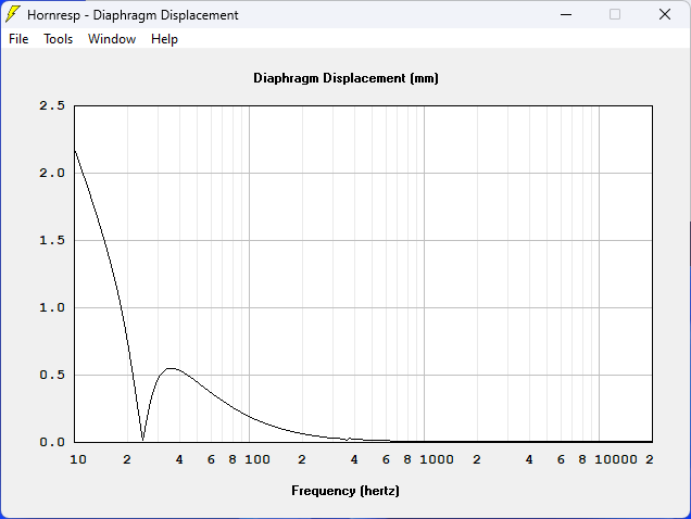

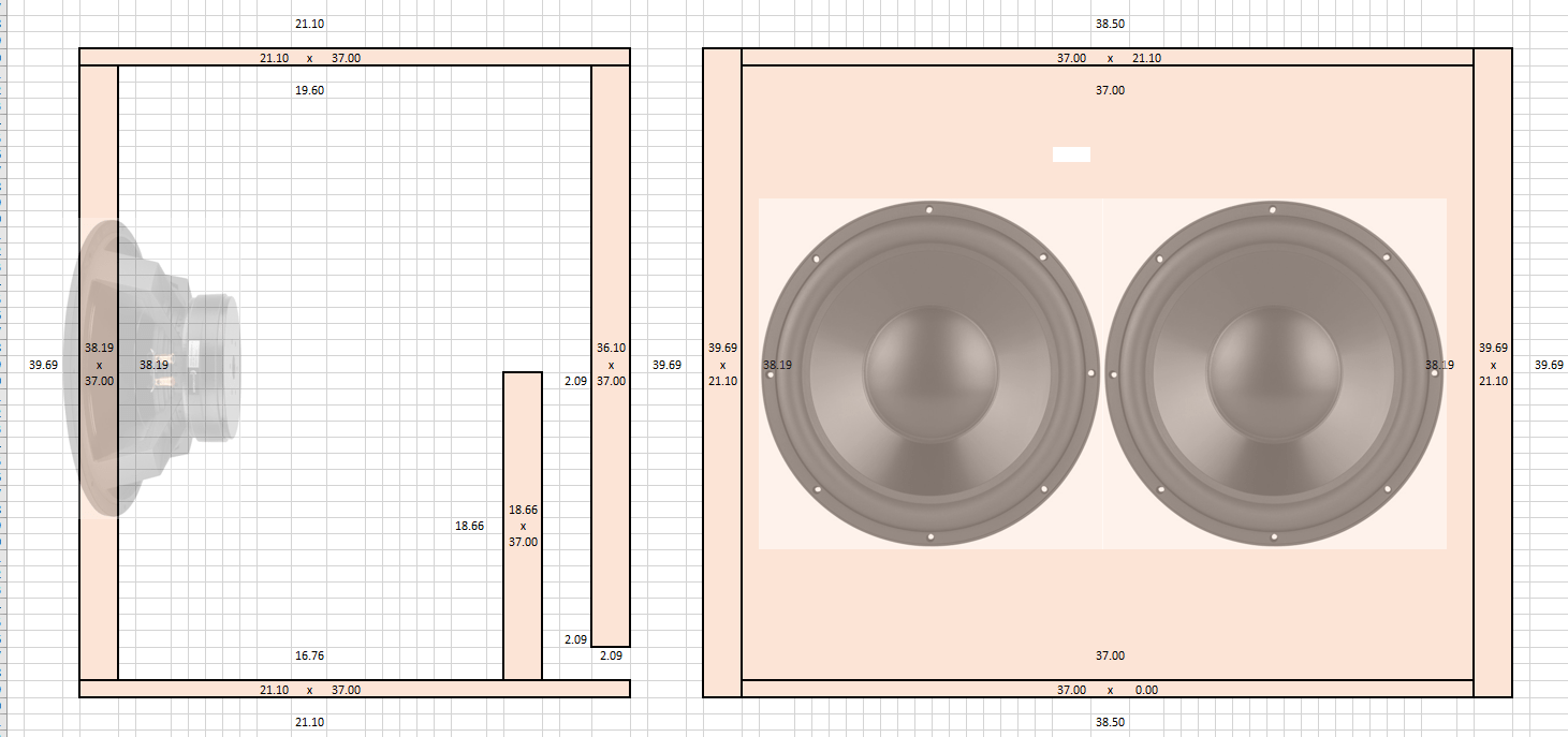

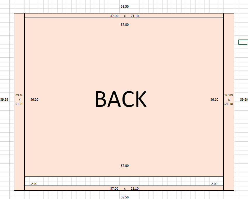

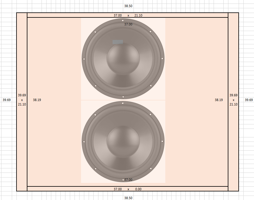

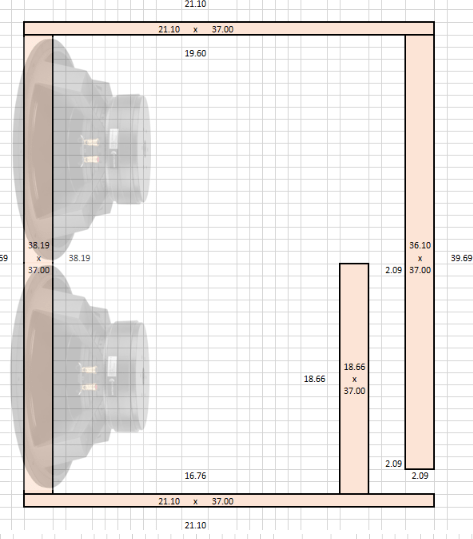

What do you guys think about this? No damping material used
Reactions: 2 users
Nah, just brace the living crap out of it and you'll be totally fine.
Keep an eye on the internal dimensions btw. If you want to play all the way up to about 200Hz.
With an internal size of about 50cm, the first harmonic of the standing wave is about f=344/(2*0.5)=344Hz (without correction).
So you don't want to go much larger or you have to come up with some tricks.
Or lower that upper frequency range.
Reactions: 1 users

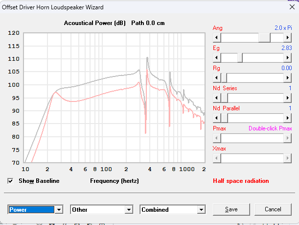

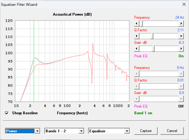

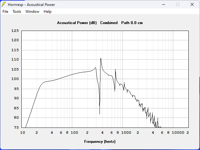

For the Offset TL sim'd above, That works out about right for a ~30inch wide enclosure. Sadly one cannot place 2 woofers one space to create the FR picture, unless side by side I guess. A peak Eq could take care of that peak, as a single woofer enclosure.
This offset thing intrigues me because its the only way to get a response this clean without using damping material, which eats efficiency.

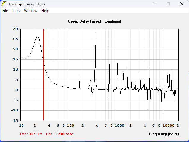

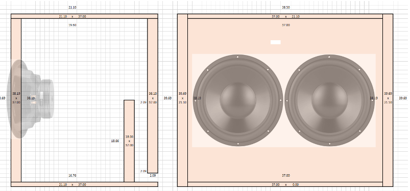

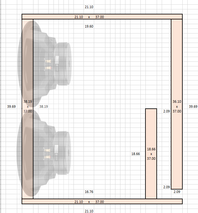

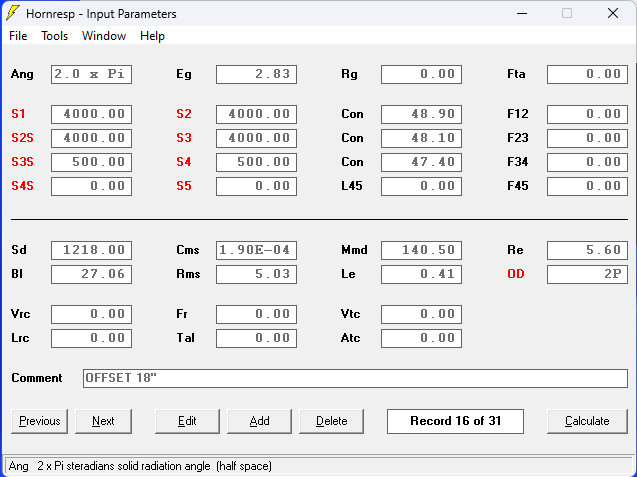

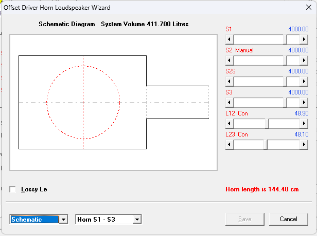

S1 S2 S3 S4 are points along the main body Those numbers are cross sectional areas in cm2. Convert that into inches squared if need be. L12 L23 L34 are lengths in between/along each point in cm.
Technically this might be called an offset mass loaded transmission line. The woofer is offset in way that the reflections from one of the line, line up harmonically, and the end result is a smooth FR versus the harmonica cancellation normally seen in some TL designs before damping material. The unwanted side effect is the larger than normal spike in Group Delay at the tuning note. By placing resonance deep enough I think the negative outcome is mitigated. An even deeper tuning might be warranted and by increasing the length of the main body you can drive the resonance down but size starts to get even bigger, so you might want to decrease CSA. Honestly it'd be nice to get GD down to 10ms by 30hz and let the rest fall where it may.

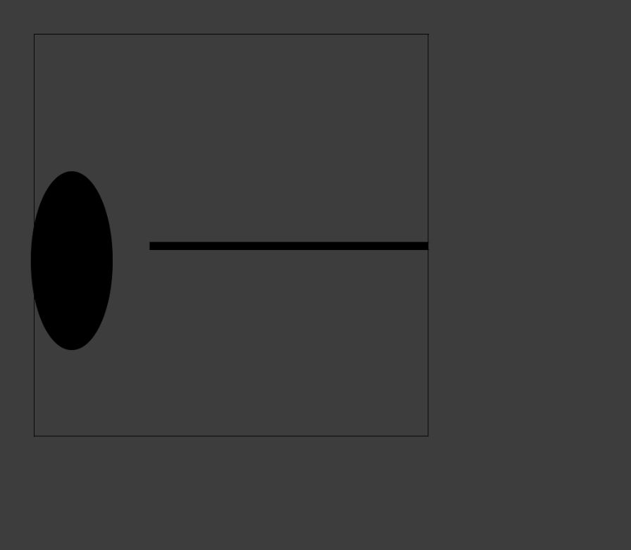

I am intrigued in this enclosure approach but I am scared to build it without more knowledge. For example if I build it like this below... will the FR result the same? I don't know. Then theres a matter of how to get eh port to the front. @GM :unsure:
Well that makes it a lot easier. I didn't know such a thing was possible lol.... Can you explain how to tell when BR ends and TL begins? So basically these guys are acoustical identical.... I guess I should be able to tell by now but tapering and mass loading blur the line for me.
I prefer front ports, what do I need to do?
