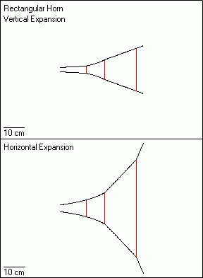

Just letting you know that the Hornresp Tapped Horn Wizard tool has been further enhanced. Throat and mouth areas can now be adjusted from within the tool. Version 19.20 refers.
Please note that each time one of the area sliders is moved to the far right-hand side, the range of all area sliders is automatically increased by 1000 sq cm. The range is also automatically decreased as appropriate to maintain maximum control sensitivity.
THREE SEGMENT TAPPED HORNS
Before selecting the TH Wizard:
1. Set L12 + L23 + L34 to the required overall tapped horn length.
2. Set L23 to the required tapped horn flare (Con or Exp).
Note that the operation of L34 slider has been reversed with the new release. The minimum value is now on the right-hand rather than the left-hand side of the slide control.
FOUR SEGMENT TAPPED HORNS
1. Set L12 + L23 + L34 + L45 to the required overall tapped horn length. Note that the position of S3 is specified by L12 + L23 and L34 + L45 and is fixed relative to S1 and S5.
2. Set L23 and L34 to the two required tapped horn flares (Con and/or Exp).
Note that the operation of L45 slider has been reversed with the new release. The minimum value is now on the right-hand rather than the left-hand side of the slide control.
As always, please do not hesitate to advise me either by e-mail or by posting to this forum, if you find any bugs in Hornresp (no matter how trivial they may seem to you).
My thanks go to Erik (‘Volvotreter’) for encouraging me to include this new feature.
Kind regards,
David

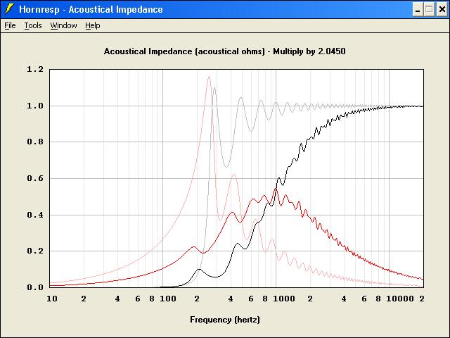

To complete the picture, I have also included Hornresp-predicted results for the above exponential and tractrix horns (Ang = 2.0 x Pi, S1 = 20.27, S2 = 2307.22 and L12 (Exp and Tra) = 55.90). The Hornresp data was exported to Excel and converted to show values of ka (2 x Pi x f / 34400 x 27.1) rather than frequency along the x-axis, to make it easier to directly compare the predicted and measured results.

The attachment below compares Hornresp predictions for the throat acoustical impedance of the tractrix horn measured by John Post against the throat acoustical impedance of a conical horn having the same throat area, mouth area and axial length as the measured tractrix horn. The red and black traces apply to the conical horn, the pink and grey traces apply to the tractrix horn.
We already know that predicted and measured results for the tractrix horn compare quite favourably. The same outcome is likely to be the case for the conical horn.
This means that there will be a noticeable difference at lower frequencies between the throat acoustical impedance of a conical horn when compared to a tractrix horn of similar dimensions. This lends support to the contention that the statement in question does not hold up in all situations :).
Kind regards,
David

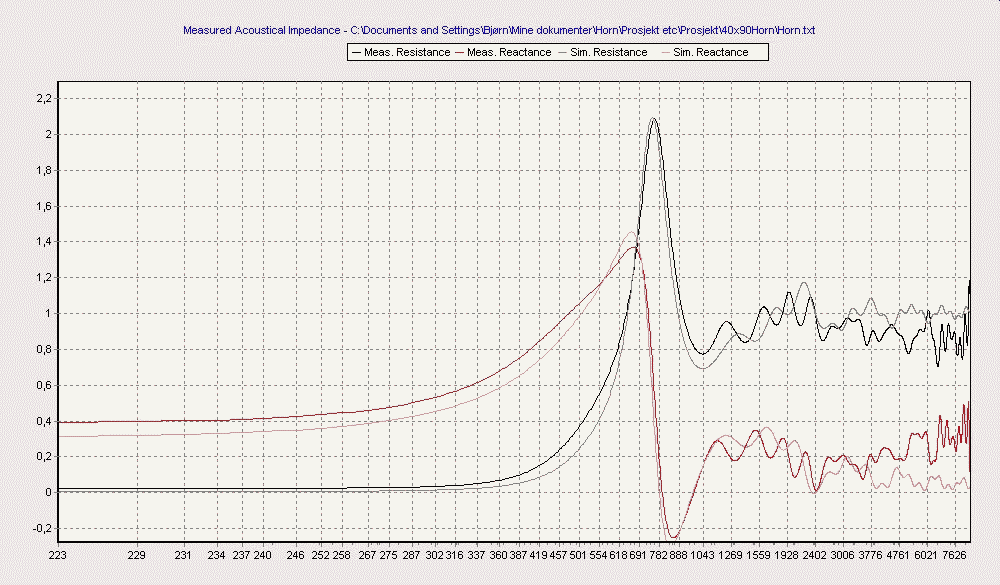

Hi Jean-Michel,
I can see that we agree on a possible questionning about Earl's sentence ;-)
I had a discussion with Earl on loading, efficiency and displacement a while ago here.
Earl's experience seems to be (from what I can see from the AES papers he has published) with mid/high frequency horns, and the exponential horns he has inverstigated seems to have been poorly executed designs. He does not seem to have much experiencie (if any) with bass horns.
One point that I didn't make in the thread linked to above, is that the effects that loading has on displacement does not depend on efficiency, which Earl seems to believe. The relation is like this: Power radiated equals the squared magnitude of the throat volume velocity times the resistive part of the acoustic load impedance (Ra):
Pout = |U|^2 * Ra
Since the volume velocity U equals the diaphragm velocity times the diaphragm area, and diaphragm displacement equals diaphragm velocity divided by 2*Pi*f, we get the relation for peak displacement:
d = sqrt(2*Pout/[(2*Pi*f)^2 * Ra])
So for a given power output, displacement increases as 1/sqrt(Ra).
In the thread linked to, I also show the difference between a big hyperbolic (T=0.65) horn (post #95), and a conical horn of the exact same length and mouth/throat areas. The difference is obvious.
Also note that when using horns with different loading properties on the same driver, just comparing SPL response and diaphragm displacement with the same input to the system does not show the real difference. Different acoustic loading translates to differences in power drawn from the amplifier, and differences in efficiency. The horns should really be equalized to the same power response to truly see the how the changes affect performance.
In the frequency range where Earl uses horns/waveguides (above 800Hz), the differences will be less than for bass horns, since the driver will mostly work in its mass-controlled range. The horns are also usually quite small and rapidly flaring. Directivity also gets increasingly more pronounced.
That there is a difference in loading between different profiles is easily measured. That the differences does not translate to a difference great enought for Earl to consider them important (in the frequency range he is concerned about) does not change that fact. Neither that the Webster horn equation is not 100% accurate. The physical fact is that slower flaring horns do present a high resistive impedance down to a lower frequency than a rapidly flaring horn.
An example: Many years ago I built a clone of the Unity horn. The measured throat impedance of this horn (where the HF driver attaches) was exactly as Hornresp predicted, and started to fall below about 10kHz. Later I reworked the horn, so it now has an about 20 cm long exponential section before the conical section. Loading is now high down to about 5-600Hz. This by adding a slow flaring throat part.
Attached is the measured and simulated throat impedance of a similar horn.
Best regards,
Bjørn

Hi David
Now that the areas can be changed as well as tap points, it would be really helpful if a window showed the total system volume as the sliders are dragged.
Cheers
Ian
Hi Bjørn,
Many thanks for confirming that the Hornresp prediction for the throat impedance of a conical horn is reasonably accurate.
Kind regards,
David
