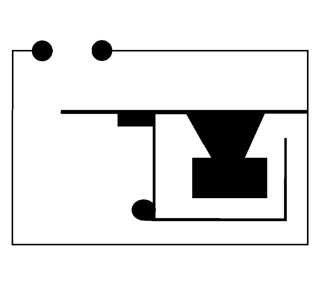

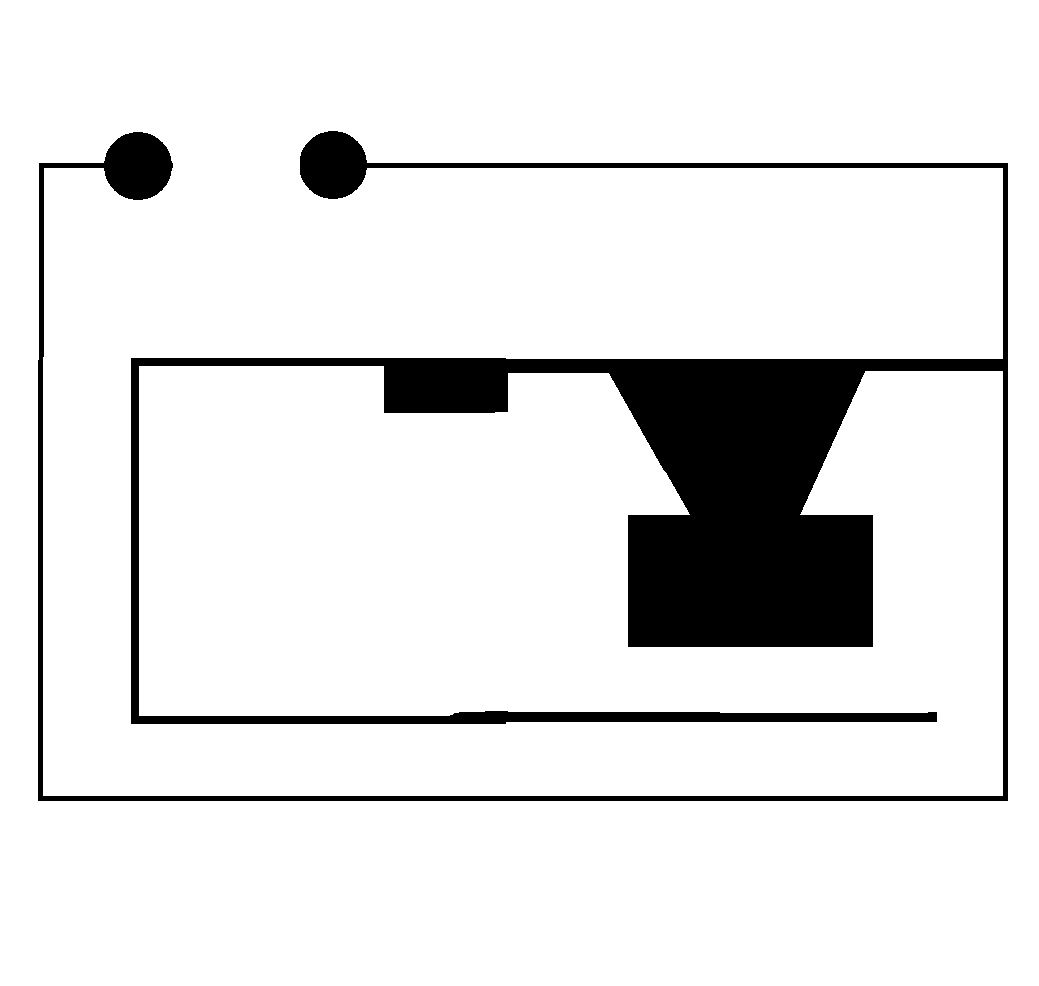

How about a sixth order vented system, an active boost, very rapid cutoff, much less over-excursion of the cone!
Reactions: 1 user
I have already made the first series 6th order pic, but after a lot of modelling, I came to the conclusion that the second design is much better for me.
So I just need to open it up and change it.
But this is a 45kg subwoofer on 8kW and the baffle in the middle is 5,6cm thick, so I wouldn't want to cut it open any more than I have to, because it is structurally important and it would be hard to cut.
So it basically becomes an 8th order box if I don't cut it down any, but I couldn't find an 8th order model in Hornresp that matches this type.
Basically a double chamber reflex with a common front chamber for the second port and driver.
Can anyone recommend a way to model this second enclosure even remotely closer than the series 6th model?

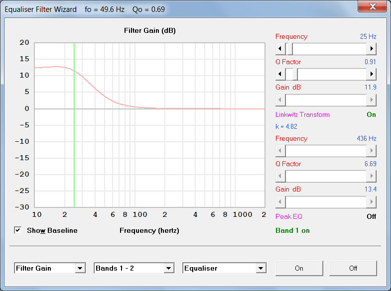

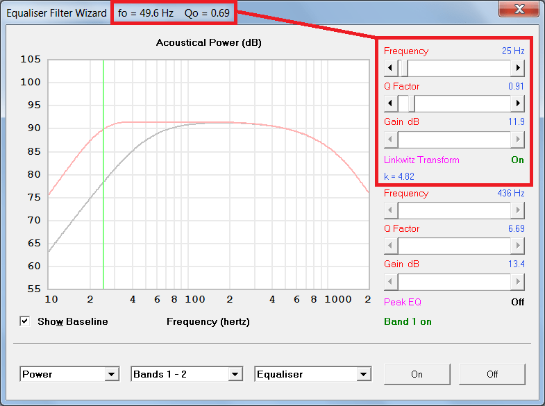

Hornresp Update 5540-240412
Hi Everyone,
CHANGE
A Linkwitz Transform equalisation correction can now be applied to a closed-box enclosure loudspeaker system by double-clicking on the High Pass filter option in the Filter Wizard parametric equaliser filter band 1.
The Linkwitz Transform correction enables the response of a closed-box loudspeaker to be extended to a specified lower frequency fp.
The Linkwitz Transform gain should not exceed 12 dB and the k parameter value should be greater than zero.
Linkwitz Transform input parameters:
fo = Natural fc (system fundamental resonant frequency)
Qo = Natural Qtc (system total quality factor Q)
fp = Target fc
Qp = Target Qtc
fo and Qo values are calculated automatically.
fp and Qp values are specified by the user.
BUG FIX
The problem of not being able to create new data files as reported in Post #14,547 has now been fixed. My thanks to enyerson for making me aware of the issue.
Kind regards,
David

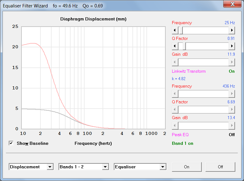

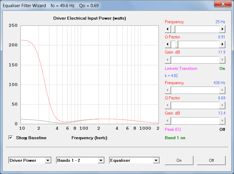

Hi David, would you mind explaining your reasons for this please?
Hi Mazza,
The recommended maximum gain was set at 12 dB simply to keep input power and diaphragm displacement to reasonable levels at low frequencies.
Another update is required to address a few things that were missed in the initial Linkwitz Transform implementation and after thinking about it some more as a result of your post, the 12 dB reference will be removed from the Help File as part of that update. It will be left to the user to decide what is an appropriate practical gain for a given design.
Kind regards,
David
Reactions: 1 users
To illustrate the effect, the attachments below show input power and diaphragm displacement with and without a Linkwitz Transform applied. The same closed box example as before is used, with Eg set to 8.94 volts (10 watts into 8 ohms).
Red trace - Linkwitz Transform On
Grey trace - Linkwitz Transform Off
Practically I usually don't even recommend going over 6dB.
Another good reason not to prescribe an arbitrary 12 dB limit...
