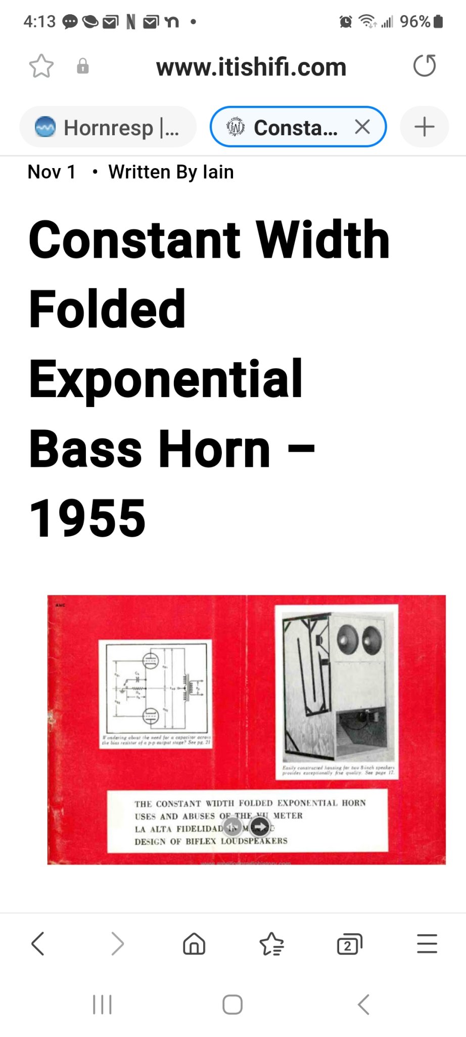

A stretched out version of more of this I think??
this book is so intersting! I wish I was smarter😝
