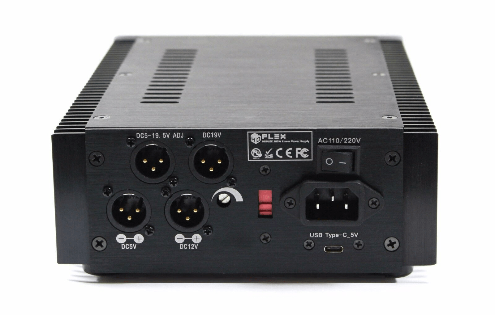

Hi, I think the PSU on my Hypex DLCP has failed, (no lights on either board).
I have a couple of HDPlex linear PSU's a 100w version and 200w version. The latter has a adjustable output so can put out 18v.
Would these be at all suitable for powering the DLCP?

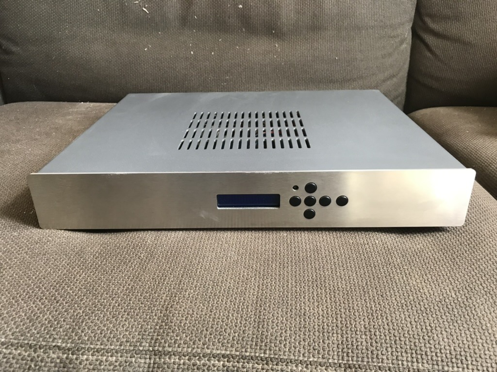

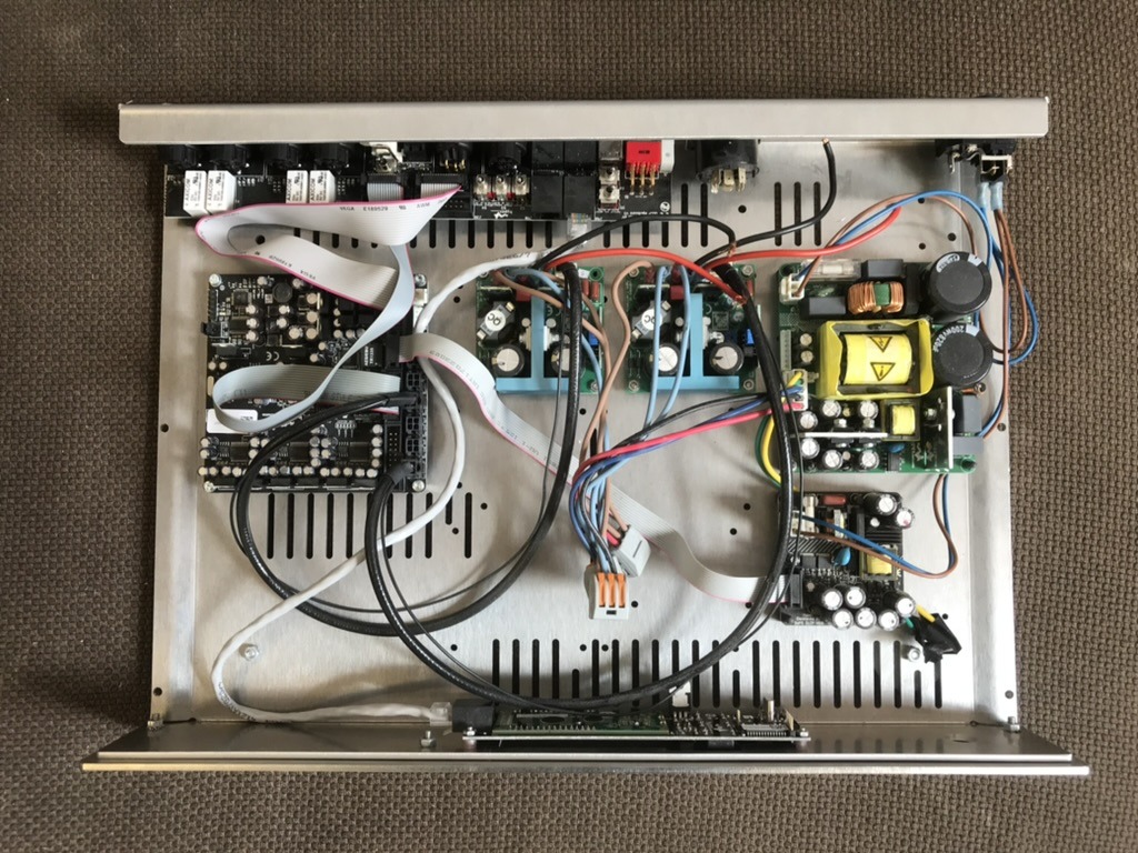

Its currently in a case with a pair of UCD and a single power supply SMPS1200A180 for the amps, which seem to be fine.
Do you have any more info on the all in one UCD amp?
Here is a pic of the 200w linear power supply, it has lots of outputs, a fixed 19v which was driving a intel NUC, but the adjustable can be dialled in to 18v.

I suspect we have the same UCD - mine's a UCD32MP v3, I guess yours may be the UCD36MP. Incidentally I've never actually hooked up the power amp side of it, only ever used it for the balanced 18V outputs, that's a useful feature from mains in. And though it should make no difference, there was a level of peace of mind using a hypex psu with a hypex board.
