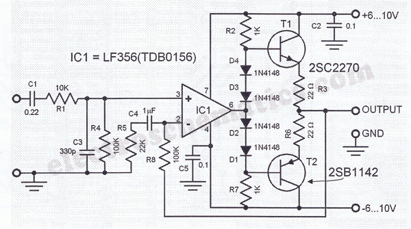

i "need" to build a headphone amplifier and im limited to these active components, the headphones(iem's) i want to drive are the kinera celest gumiho, the issue i have with them is that theyre 8ohms and my dongle cant keep up current wise during the bass notes.

Then maybe you can rig up an op amp front end with complimentary bipolar outputs.
But you'd have to design the circuit. Something along these lines, adapted for your parts.
You'd use two 9V batteries, not one.
