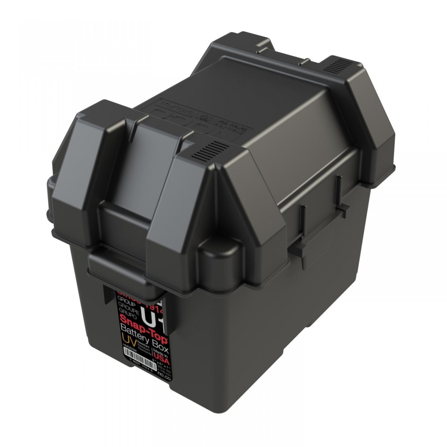

The speed bump and the reason I was going to email you today was the legacy UcPure MKI power button snapped off when I was troubleshooting days ago. So today, I tried a power switch on/off button with the UcPure with no luck. I was waiting for 2.54mm terminals so it will be cleaner, but since it is a legacy board I decided to try to solder the power switch on/off button wires to the PCB. I get confused because there's blank labeling on the UcPure and there's blank labeling on the power switch on/off button. I think this is normal Industry practice for power switches, so I have to research. I got the UcPure to constantly blink the power on LED, but that's it. I'll experiment another time and just physically pull the DC Power plug from the UcPure as needed. Since it is a legacy PCB, it's too much trouble to repair so since I was planning on adding a power switch on/off button anyways since the UcPure is in a Battery Box it should be fine with no original power button.

Okay. It's very, very low priority so if I need one day I'll let you know next time I order more parts. Maybe Summer Project would be the earliest.
As long as I can troubleshoot by using a small screwdriver to flip turn on/off it's workable.
I just have stiff solid wiring and I use a Battery Box for the UcPure that complicates, but it's fine as I just unplug / plug the laptop charger when needed otherwise it's 24/7:

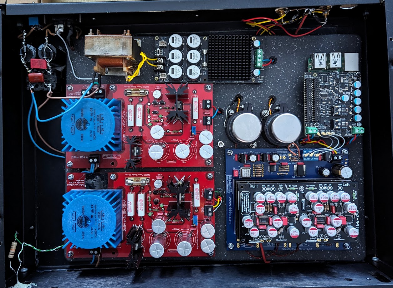

I‘m progressing my build with GB parts and have a few questions regarding the continuous output of the UCPure. While replicating your setup from the post
https://www.diyaudio.com/community/...eapon-to-fight-the-jitter.192465/post-7478491 I was wondering if the continuous output runs 24/7 would it be ok for the fifo board if terms of wear when other boards get switched off. How UCPure will get recharged if continuous output will drop below threshold? Would sync control connection make sense if a single UCPure powers both FiFO synchronously and DAC switched as shown in your setup from the quoted post?

FifoPi clock side has no problem power 24/7. When turn off, you will still have the continuous output, but the charging circuit will be connected too so the voltage will not drop. SYNC mode work for continouse output.
Continuous mode has the best low ESR performance and and will be even more clean than the switched output.
Ian
