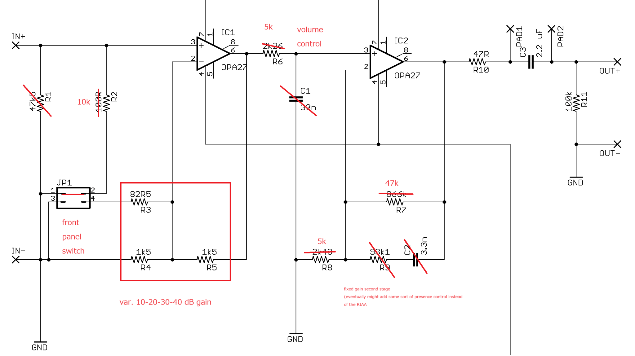

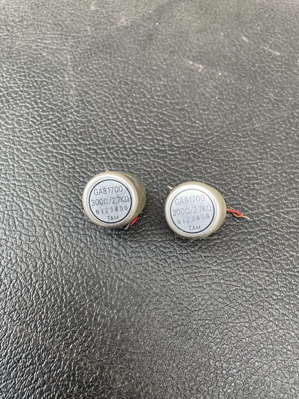

Bought this pair of Tamura microphone input transformers off yahoo.co.jp auctions for 3000 yen.
They are nominally 300 ohm / 2.7 kohm, meaning a 1:3 turns ratio, and, for my 250 microphone, a nominal 2250 ohm output impedance.
I plan to make a functioning "mule" from the Emerald circuit board, leaving out the RIAA filter and replacing the jumper gain setting with a stepped attenuator. I'll provide the 48 V phantom from a separate circuit board.

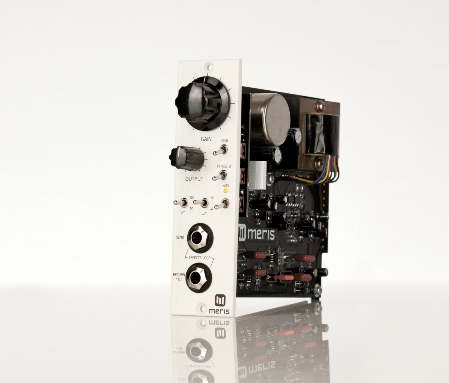

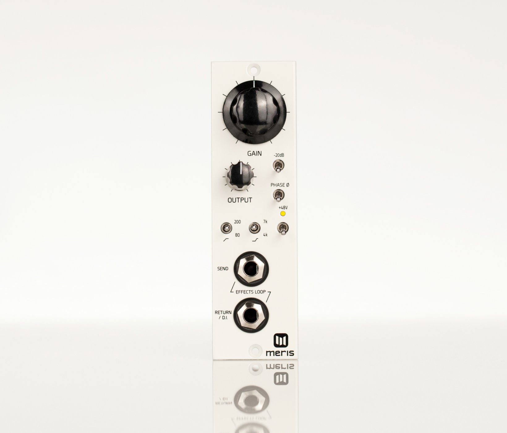

As inspiration, here's an example I found of "what I would build if I could". The Meris 440 Mic Preamp.
I love the straightforward layout and the classic instrumentation look. Those Bakelite knobs, toggle switches perfectly match the cream-white faceplate.
You can see the input and output transformers on the card.
In terms of features, there's the usual phase reverse and 48V phantom switches, as well as a -20 dB attenuator (pad). Then there's two 3-position EQ switches, tremble (off-1-2) and bass (off-1-2), an finally an external loopback for adding effects.
I note the gain control structure is divided into three parts, a "gain" control for the input amplifier, an attenuator (volume control) for the output signal, usually right in front of the output buffer, and somewhere a flat 20dB cut is also implemented.
I really need to get my hands on some schematics to see how all this is usually done.

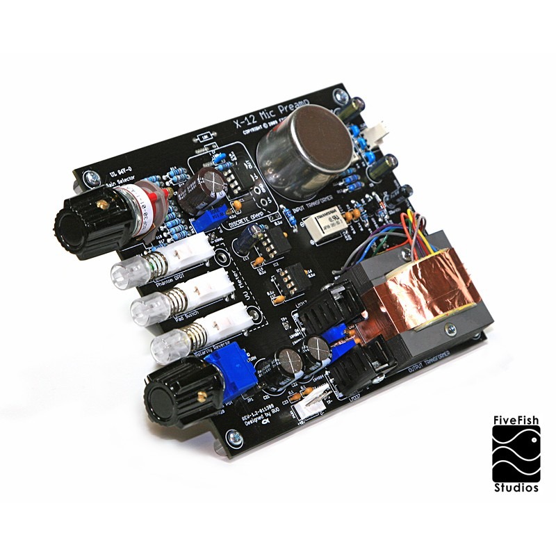

Huh. There are people selling kits. Although the board layout closely resembles the Meris 440 above, the X-12 from Fivefish Audio uses OPA134 op amps with the option of a discrete op amp in a 2520 package. The tone controls and effects loop are omitted, but the phase switch and pad are retained, along with the split gain/attenuation structure. This is really close to what I intended to build.
