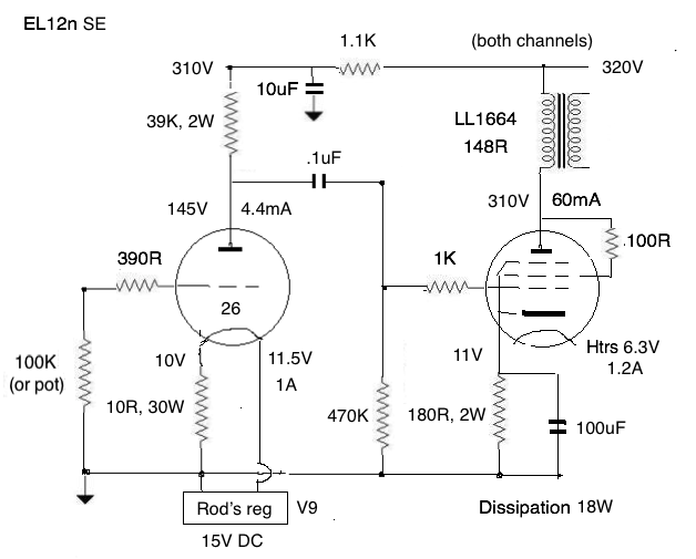

I used to use 300b and 2a3 but got better results with EL12 or EL12n in the output stage driven by a DHT in a 2 stage SE amp. I like the 26 but you could use a 10Y. The gain of the EL12 in triode is 18 so a DHT drives it OK, and 2 stages always sound cleaner to me than 3 stages. The DHT in the input gives the whole amp that special DHT quality. It's a much better driver than all the 9 pin tubes you can throw at a 300b.

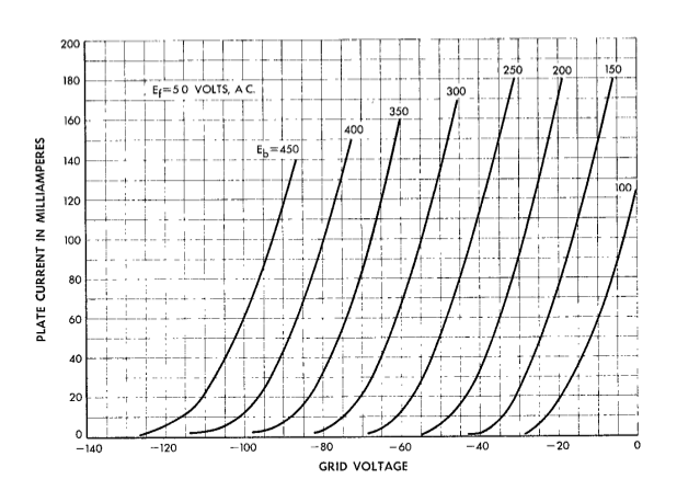

First of all: in the "classic" operating point of 300B (350V, 60-70mA) the grid (to cathode) voltage is -72 ..75V.
The requiring grid swing (up to A1) about 150Vpp.
The NC20 is 1:1 interstage, so -if you want two stage amplifier- at least 26x gain requiring (if the input is 2VRMS= 2.828Vp for maximum power).

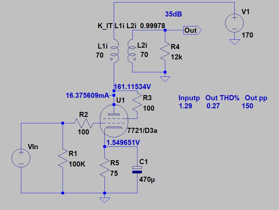

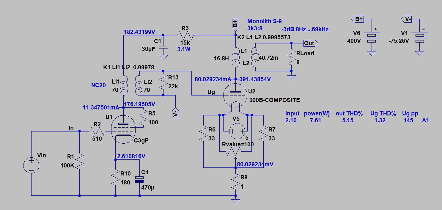

I would rather choose high gm trioded pentode. I prefer D3a, or C3g which are have enough low output impedance for such interstage.

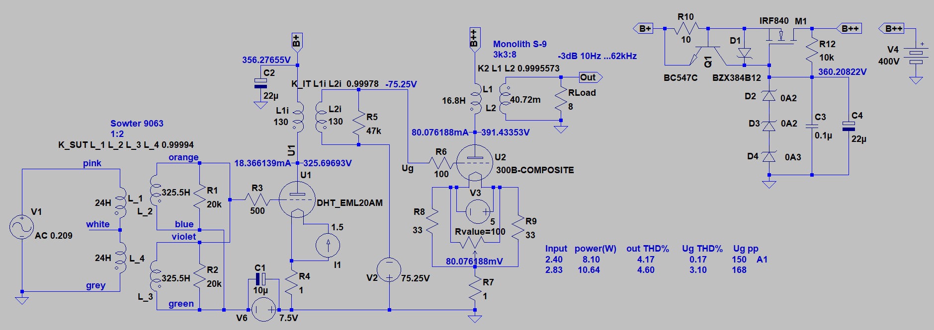

If you insist to use DHT VAS stage, 1:2 SUT, EML20a(m), NC20, 300B is feasible.
Sample (higher op. point):

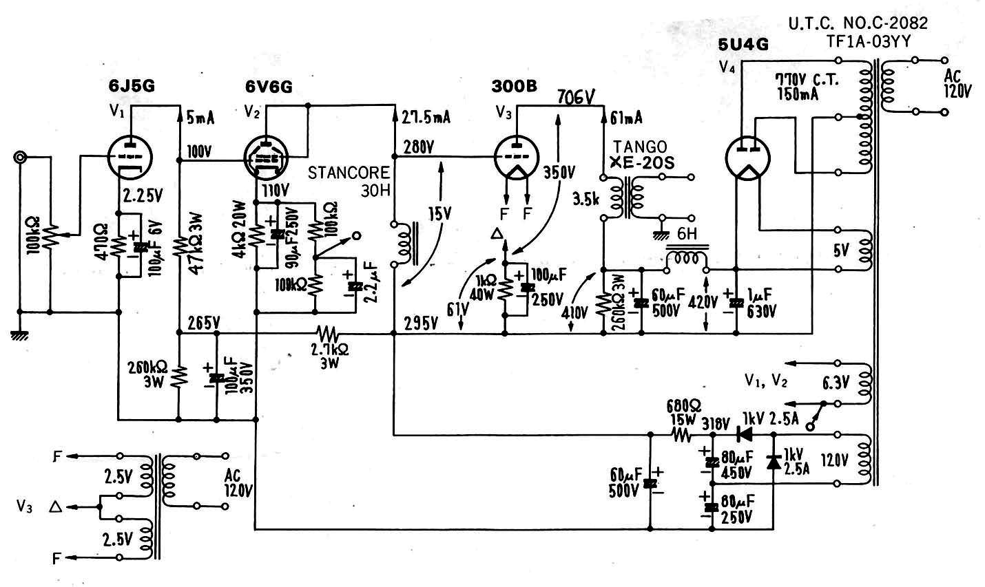

Sorry it is a classic circuit, but not using a NC20 as driver (have to wait to post until after coffee). The triode connected 6V6 is choke loaded and the supplies are "stacked" to allow direct coupling of the driver to the 300B.
You can still ape the circuit with interstage transformer without using a stacked power supply and keep it more conventional. It will end up looking similar to the Shishido 300B amp in the second schematic which indeed uses a Tango NC-20 interstage transformer.

D3a seems to be getting quite some praise and the schematic looks simple enough that it warrants trying it as one of the options.
D3a (or E280F) and C3g (or rare C3o) as triode are perfect VAS tube for two stage amplifiers.
Both have low distortion even at large swing, and harmonics distribution results "good tone".
Sample:
