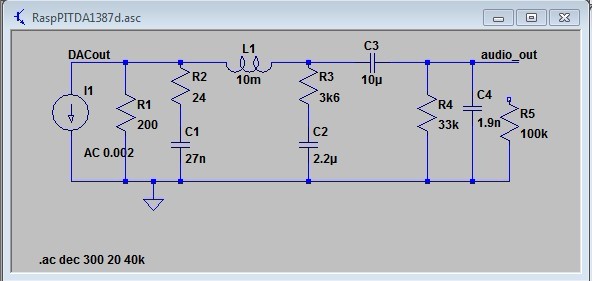

I'll have a look at increasing the damping of the filter - that way you'll get the benefit of the rejection of images at higher frequencies but not have the rising HF response needed for NOS eq. I think its going to be simply tweaking a resistor value....
Attached the revised schematic - I took it that you'd settle on 100R for the I/V resistor and adjusted the other values accordingly. It looks impressively flat now :)

I'll go back to find the original circuit and have a play to see if the filter can still work with twice the output impedance from the DAC. I assume you wanted the 'flat' form of the filter - for 2X OS or higher?
200R I/V resistor...
Turns out that with 200R for the I/V I can't get the response I want - it requires changing the inductor to 22mH. The nearest fit with L=10mH is with a roll-off at a higher frequency (30-40kHz). Here's what I've got . If you stick with 100R you'll get a nicer response but your output level will be rather low. You could of course solder an extra 4 chips on top of the 4 you have....

Would it be possible to draw up a schematic of the output section? I can't follow along well enough from the textual description to picture what's going on. For example 'RC' means R and C in series or in parallel?
<later> Added schematic - do I have it correct?
