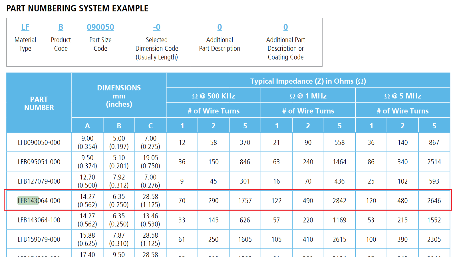

You could experiment with "low frequency optimized" ferrite cores around the power cable. The good news is, they are cheap (USD 2.57) so the cost of an unsuccessful attempt is negligible. The bad news is, they are not snap-on, split cores. You'll need to cut your IEC power cord in the middle, slide on one or more (!!) of these ferrite cores, then splice the cut and insulate it well.
Laird Performance Materials part number LFB143064-000 (link to Mouser sales page) . Datasheet performance shown below. Extrapolate the semilog axes plotted curve, back to 20 kHz. Looks promising for so little money.

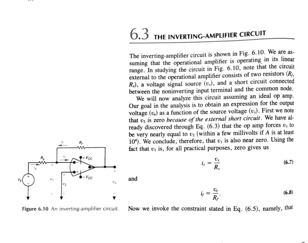

Assume Rf = 10K, Rs = 1K. As shown, there is no load RL.
Pedantic to discuss bias currents.
Vs = 1V. Therefore, Vo = -10V.
Power delivered by the source = 1 mW.
Power delivered to the load of infinity = 0 mW.
Power therefore has decreased from input to output. Is this circuit therefore an inverting-attenuator?
Voltage has increased from input to output. Is this perhaps why it is called an inverting-amplifier? What does power have to do with the behavior and identification of the circuit?
Sure, the opamp itself is providing power to the passives surrounding the opamp, and this goes to the point in post 31 that power lost to efficiency is independent of the behavior of the circuit to amplify (increase) while perhaps consuming power in the process.
But let's not try to redefine a century of accepted industry practice of identifying the circuit attached as being an amplifier.
Or maybe we need to re-write all our textbooks to use the terms "inverting-converter" and "noninverting-converter". That will help further progress and make things so much more clear...
