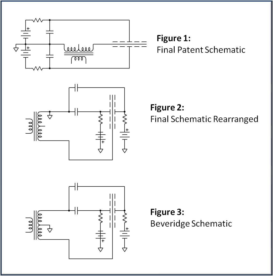

The Beveridge drive system is equivalent to that used by Final, only the ground reference location is changed. Both use low resistance diaphragms and have driving forces that are inherently non-linear.
The advantage of the Beveridge circuit is mainly in its use for direct drive systems where the same output can be achieved with amplifiers having half the HV requirement.
See also: Beveridge-vs-Final-ESL-Configuration

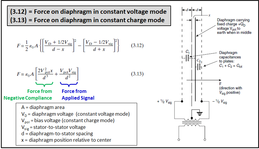

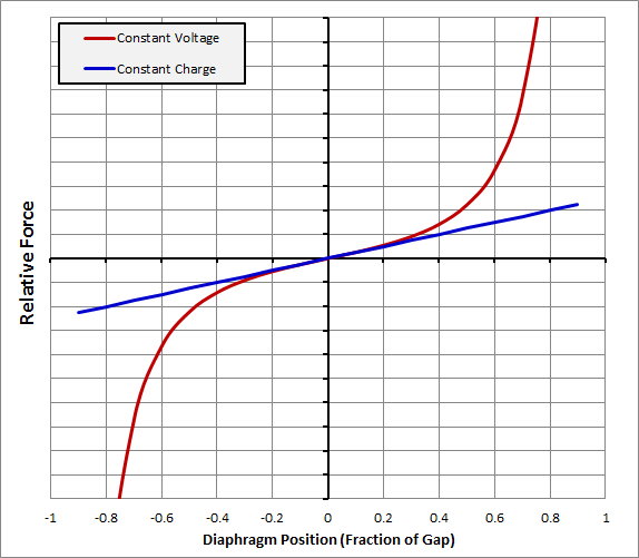

Looking at the Force equations for the Constant Voltage Mode compared to Constant Charge(taken from the Baxandall paper golfnut mentioned), you can see the source of the odd harmonic distortion in the squared terms, and the even harmonic from diaphragm offset. If you just look at the Force generated when the diaphragm is positioned at different points in the gap, you can see that distortion will be reasonably low if excursion is less than 10% of the gap. As excursion passes 20% the distortion increases exponentially.

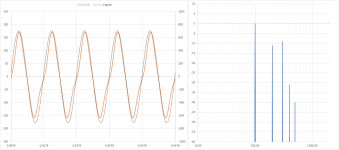

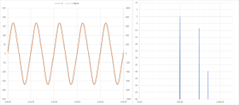

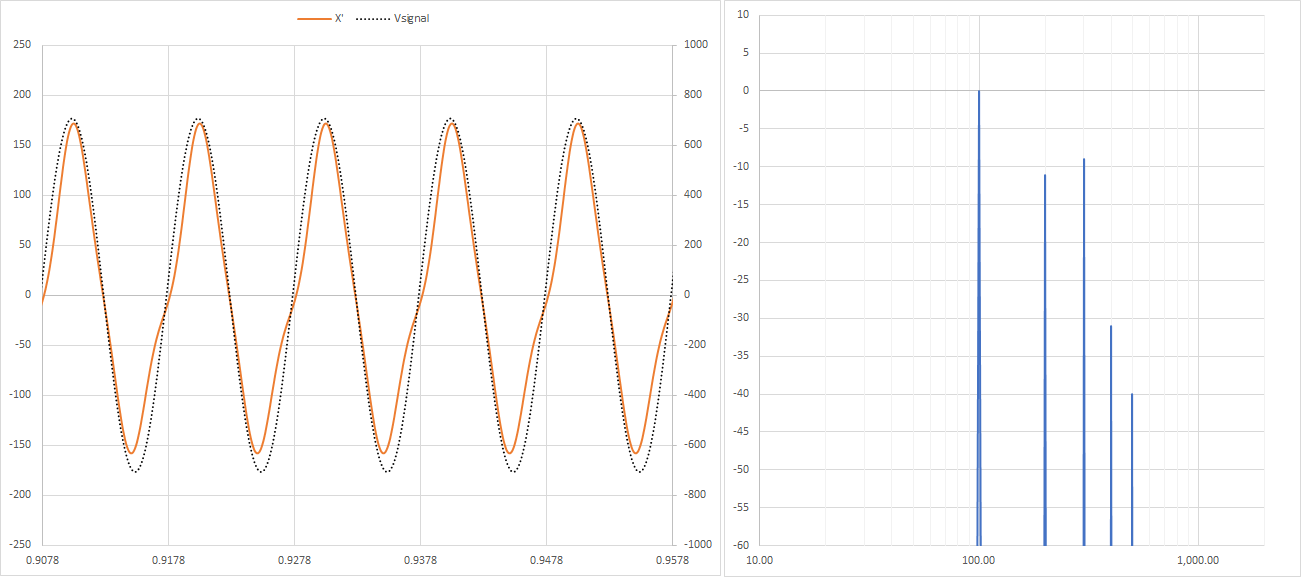

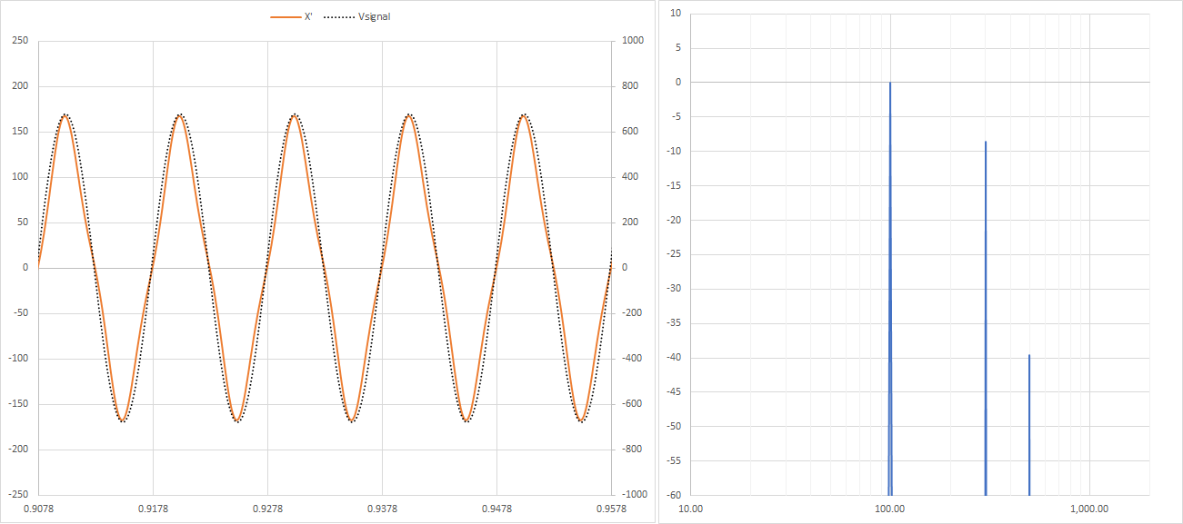

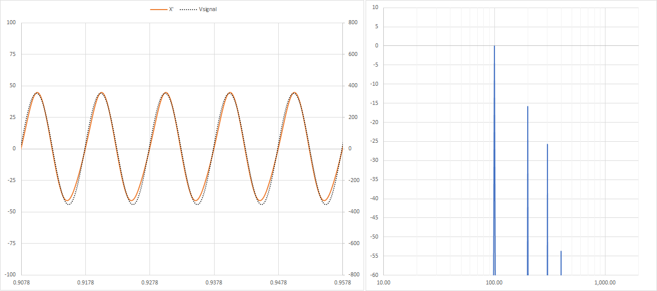

If numerical methods are used to solve equations of motion with the constant voltage driving force, you can see how distortion products are affected by different parameters.
  • With theoretical perfect symmetry resulting in no diaphragm offset, only odd order harmonics are generated
  • When diaphragm is offset from center as in all practical ESLs, even harmonics will also be generated.
  • The ratio between even and odd harmonics depend on
    • magnitude of the diaphragm offset
    • magnitude of the diaphragm excursion
    • ratio of Vbias to Vsignal
To illustrate, attached are 3 examples.(magnitudes are normalized to make comparison easier)
1) No offset with excursion of 30% of gap
2) With 5% gap offset and 30% excursion
3) With 5% offset and 10% excursion

...This distortion can be quite high, and almost entirely second order...
I would be very interested if you can recall what publication had the measured results you describe (8% dominated by 2nd harmonic). When testing constant voltage ESLs, the only time I saw 2nd harmonic dominate was at higher frequencies where excursion was low. As soon is you try to produce lower frequencies where excursion exceeds 20% of gap, odd harmonic always dominated and the sound of test tones would take on a decidedly "fuzzy" sound.
*** I wonder if the measurement was taken near-field with mic in the middle of diaphragm where the offset would be the largest and thus 2nd harmonic more prominent.

I found the old post from Harold Beveridge his on quite interesting, seems to be quite similar with the statement you made about the HV requirement.
"A reverse esl would be to have a constant charge on each of the stators and the membrane carrying the audio. This would make the stators passive and the membrane would do all of the work. In that case, the amount of voltage necessary would not change.
In a Beveridge system, there is no passive component. Both the stators and the membrane are active. All three carry the audio. The benefit of this is that it reduces by half the amount of voltage necessary for the same amount of sound pressure."

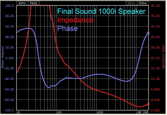

There are some other things that are funny. At 1 kHz / 90 dB, the 2nd harmonic is 60 dB down, at 10 kHz, it is only 50 dB down. If excursion was the problem, we'd expect it to get better at 10 kHz.
Most likely the distortion increase you are seeing at 10kHz is not from the ESL itself but from the driving amplifier or transformer. You can see that at 10kHz the impedance has dropped to less than 2 ohm. Almost all amplifiers have distortion profiles that increase with frequency above 1kHz and also increase when driving lower impedance.
The transformer may also be contributing additional distortion at 10kHz if there is resistance in series with the primary.(pretty typical to have 1 – 2ohm). The increased current draw from the low impedance at 10kHz will result in more voltage drop across the resistance. If the current is distorted due to hysteresis effects, this distortion will show up in the voltage drop and thus passed on to the ESL stators.
Similarly, at 100 Hz, 2nd and 3rd are 34 resp. 30 dB down, at 60 Hz (from the DIN IMD test), they are 38 and 47 dB down, again not what we would expect.
This reduction is distortion is likely because 60Hz is approaching primary diaphragm resonance. Motion amplification at mechanical resonance is inherently low distortion which will compensate some for the increased distortion of the driving force.
