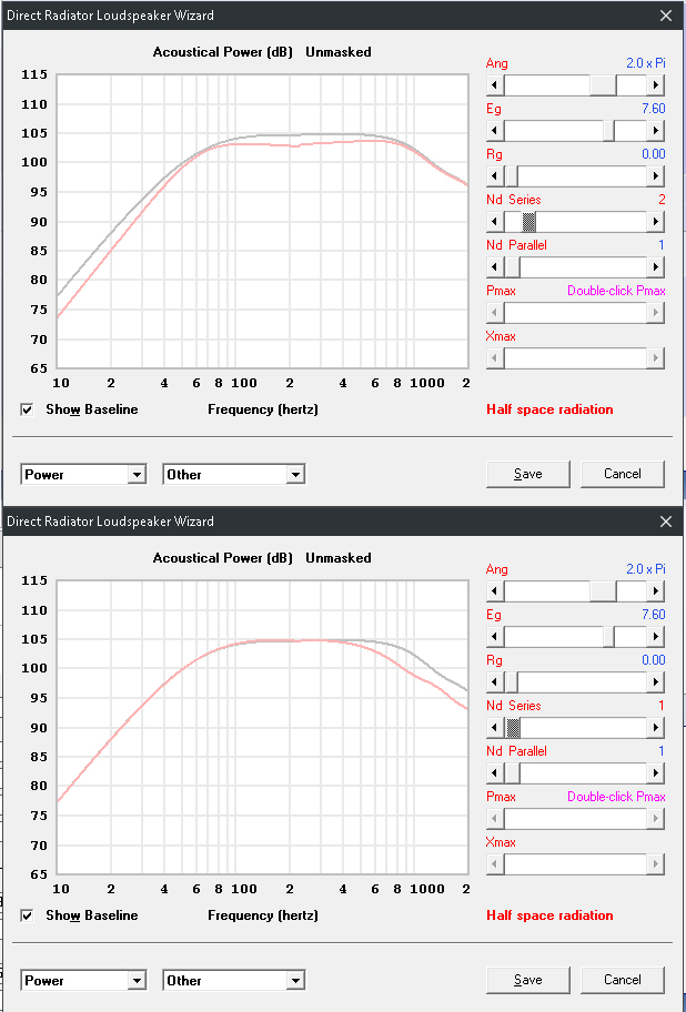

2 in series should dbl inductance and thus lower Hf sensitivity youd think
No I do definitley not think that ! And I bet many others don't think that either. I let you guess why this is the case before giving you the reason.
But HF response wouldn't improve either. And one has to be careful when using two drivers for the same frequency range when it comes to the reproduction of short wavelengths due to lobing.

Two drivers in series, dbls Le. How this affects Hf performance...not sure, I just go off of what I can see in HornResp. Higher Le gets, Hf sensitivity lowers. If I dbl woofers in series Hf doesn't really change...
HornResp has a glitch, in editor, where you may get different responses when you should not.
In the pic, the lower box, notice how driver count is one but the response never goes back to the grey line.

fHVC upper rolloff corner (-3 dB) frequency due to the effects of driver voice coil inductance acting alone
Fhvc [mH] = Re/[pi*[Le*1000]]

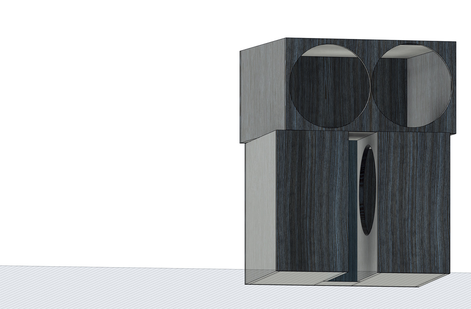

Do you guys think I could pull off twin side by side midwoofers?

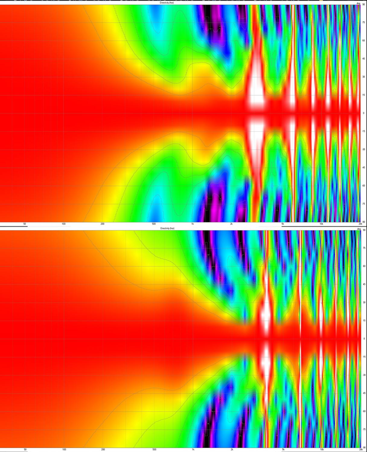

I mocked up the horizontal polar at 1 meter in Vituix. If the ~36" wide elliptical tractrix horn ever works out, along with the potential success of a 300-400hz xo...higher directivity from mids would improve clarity aside from the benefits of more Sd and powerhandling.
Sure! Though at your seeming level of desired excellence that rivals the best W.E. could come up with, then IIRC you'll need a ~8 ft square horn termination/mouth [W.E. 15A horn] tuned to ~50 Hz.
Camplo said the cutout is for the countersunk woofer, which would be approximately flush with the cabinet face.
After a short period struggling using a pair of side by side 15" with a JBL 2385/2445 above, we cut the 11 stage monitors made in that configuration down to single 15". Need for EQ dropped considerably, and the horrible off-axis horizontal response was eliminated. Lesson learned.

Okay, maybe it’s me not getting it because the way I understand it, you have the mounting flange which is part of the driver basket and you can either mount from behind or on the baffle. The thin slice of baffle between the two drivers looks too thin dimensionally to be of use.
- Yeah this, is the diameter of the holes you see...there should be another panel directly behind this to mount the drivers to.mounting flange which is part of the driver basket and you can either mount from behind or on the baffle
A pair of 15" is also overkill, considering the 15" is only keeping up with a pair of sealed 18" used for low frequencies.
Where did you cross it at? If I cross at 300hz, thats only 100hz away from optimal ctc spacing 200hz.
