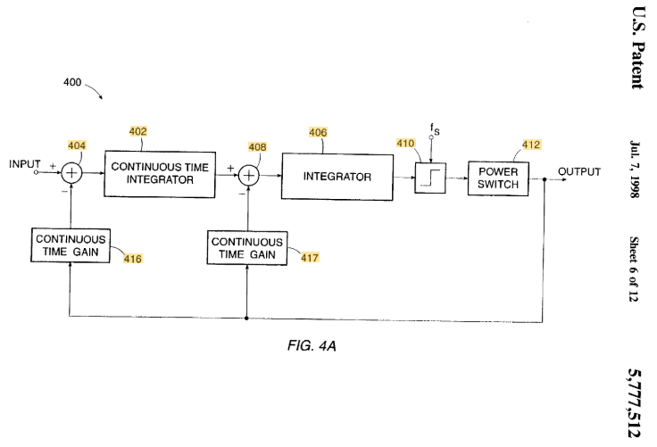

I don't want to be accused of calling anyone's baby ugly...just want to point out how the technology has evolved, and why there might be reasons to embrace the newer designs.
The Tripath amps are designed like a Delta-Sigma DAC with a power stage. So read the Wikipedia article on Delta Sigma Modulation, and note the discussion about reducing quantization noise by using second order and higher-level modulation, about half-way down the article. Then look at the block diagram described in one of the Tripath patents issued to Adya Tripathi, which is probably what is used in those products released around 2000.
https://www.diyaudio.com/forums/attachment.php?attachmentid=814562&stc=1&d=1580942204

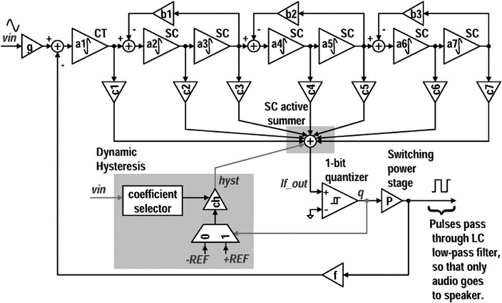

Then look at what Analog Devices did for the AD1994 chip about 6 years later:
https://www.diyaudio.com/forums/attachment.php?attachmentid=814563&stc=1&d=1580942345
The design of the AD1994 chip was described in an IEEE article that requires a login, but it's worth a read if you know someone with access. It uses the same Delta-Sigma modulation scheme as the Tripath, but with a 7th-order modulator, resulting in greatly improved performance. The AD1994 is obsolete now, but this architecture survives in the SSM3302-series devices, which is what I used for this monstrosity.
I haven't compared a SSM3302 with a Tripath chip and I don't intend to. I'm sure the Tripath sounds fine and is suitable for many applications, but why would anyone use this older technology when devices with better specs and that are easier to use are available? I don't think the Tripath is "ugly"--but I think that there are much better alternatives for new designs.

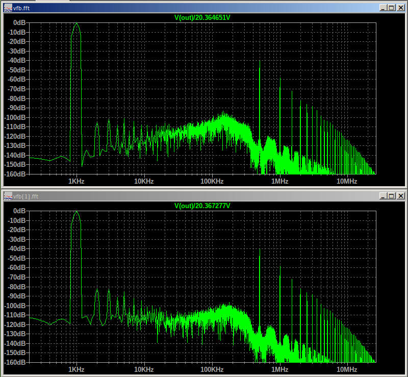

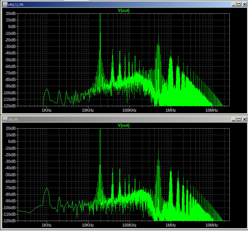

Diogenio mentions an amplifier with 40dB of negative feedback. Fair enough we might not know where that comes from but...
The Purifi amplifier appears to achieve its performance including extremely low distortion, by implementing an additional integrator in the feedback loop. One of the reasons, or claims, as to why this works is that the additional integrator, perhaps including part of the rest of the loop, is knocked out as or when the loop begins to lose the plot and this is achieved in a 'transparent' manner.
Objectively, and presumably measurably, the words make sense....? Perhaps other people who implement high order loops futz things up. But, of course, you can measure this so if your measurement does not show a problem the problem is not there. So you invent a test for IMD...
Matey Tinman blathers on about his requirement that all amplifiers shall have a monotonically falling set of distortion products. Does Matey Tinman know something or is that his subjective preference. How did he arrive at that preference and identify the reason for it. Does he know the source for that reason?
It's not a brilliant demonstration but the attached picture shows the result of including an integrator in the loop, top, versus knocking that integrator out, bottom. The integrator improves my distortion numbers by up to 20dB, should be a familiar per decade number and you can see that slope.
Otherwise whilst it might not completely satisfy Matey Tinman the distortion products in the bottom plot are falling whilst those in the top plot are rising. Subjectively it would appear that Matey Tinman does not like amplifiers that include the extra stage of integration. Objectively in as much as you can see there is a difference you have to accept there could be a reason for that subjective preference.
Does harmonic distortion distribution matter versus total harmonic distortion. Can you hear the difference between a Major and Minor chord. What if it is augmented or diminished. Then what happens when it's played across different frets.
Objectively from the pictures can you state that you could hear a difference. They certainly measure differently. Subjectively do you think you would hear a difference and would you be able to identify the reason. Objectively can you state that someone else would not be able to notice the difference either with or without you being in their face asking them. Objectively given the structure of the harmonic distortion would you be able to give a subjective opinion as to how the amplifier might sound.
