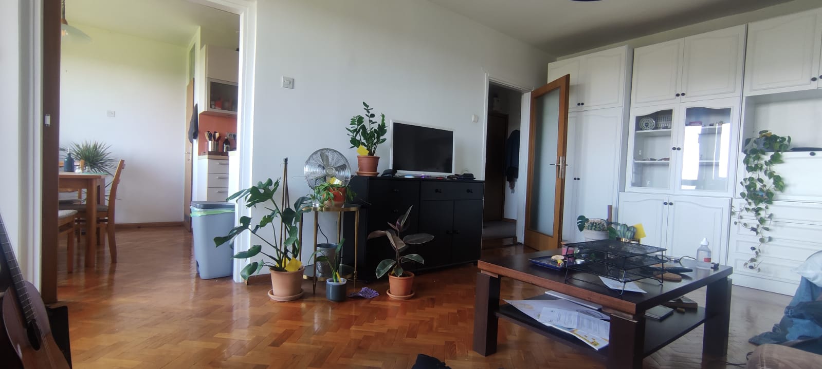

@Davor D Sorry for not being more specific I guess an image in the attachments would describe it best. I'd put them on the side of the TV. I'd move the plants and center the television so there is equal space around it. I don't know how the openings on the side of the wall would effect sound. I'll probably move one or two more times in the next few years so I'm not too set on the room specifications. I also tend not to listen to music too loud since I'm in an apartment building. My music taste is all over the place and changes on the monthly basis so I wouldn't go by that as well. I think I like realistic reproduction and neutral since that's what I always went with with my headphones. If you have any more recommendations please go ahead

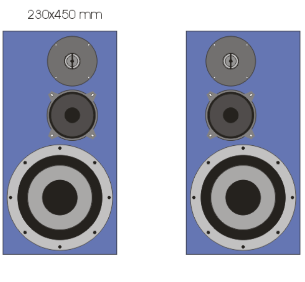

@Lojzek Bok Lojzek! Do you have anything else in mind? Also, where did you find that design?
Hey there, the design is my own. I'll have a look what might suit your needs.
I appreciate the vote of confidence, @Guerilla .
I have been pondering a higher performance version of that speaker.
Dayton RSS265HF-4 10" woofer
Satori MW13TX-4 5" mid driver
Satori TW29DN-B 29mm soft dome
Increase the box volume to 34 liters by increasing the depth from 222 to 278 mm. The width, height, and baffle stay the same.
All active, with a Hypex FA-123 amp... or a MiniDSP with 3 channels of whatever high quality class D amp the end user wants.
