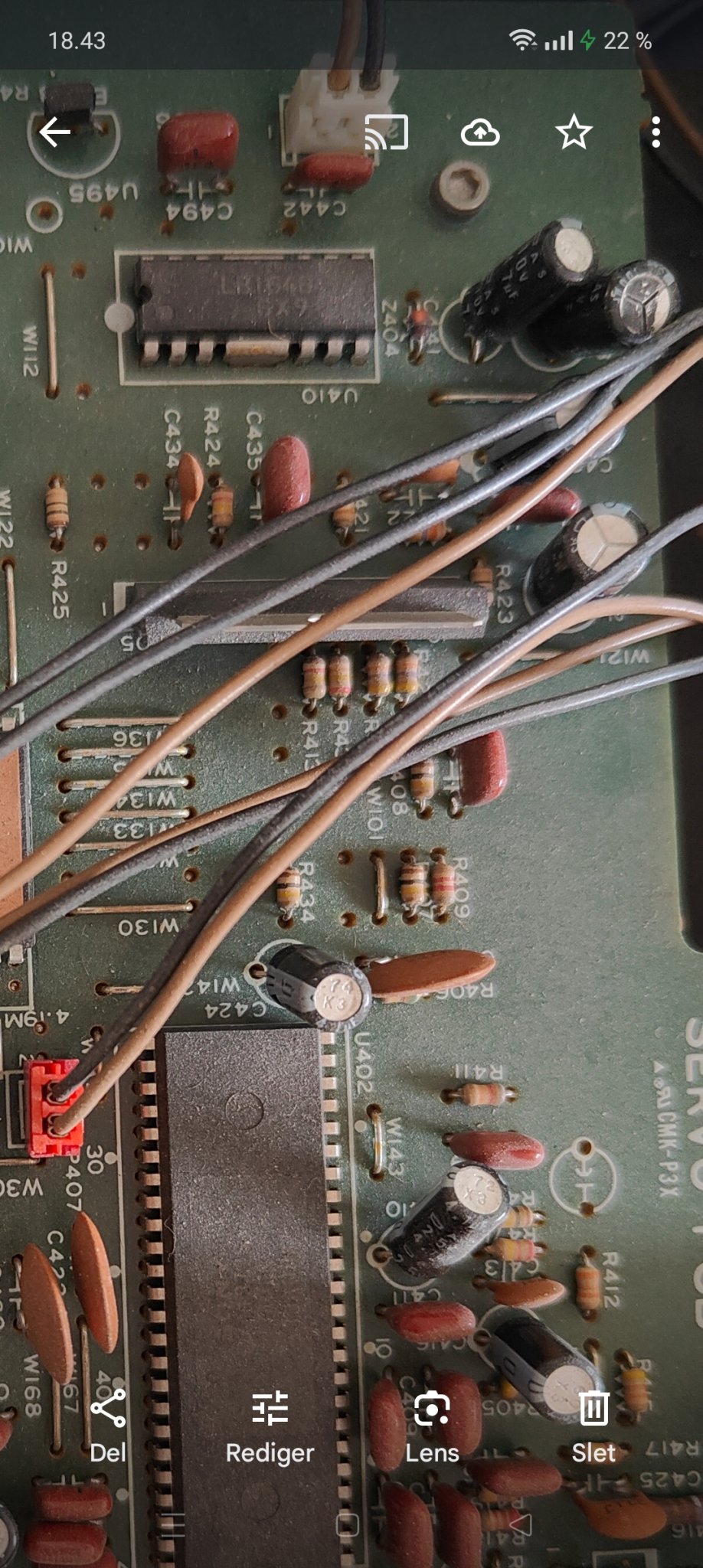

I have a Kav-300 Cd player and when putting the cd in, the cd mechanism start spinning the cd and after 5 sec, it stops.
The player hasnt been used for many years and i suspect there are a few bad capacitors.
I tried to find the service manual and i cant find the correct one.
Any help?
Fix: replaced the laser
Hello Ladies and Gentlemans
Any help?

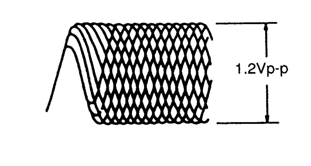

You are assuming a bad capacitor without any indication this is the case.
What we know is the laser is getting a focus lock, and the disc is spinning. You haven't told us if the speed is stable, too fast or too slow.
Do not adjust anything, or replace anything yet. You may create additional issues, and waste money in the process.
What does the eye pattern look like? Can you post it please?
I had an Bang & Olufsen cd player last week and it did the same. Spinning and stops after 5 sec. I found a website indicating that the caps on the servo board needs to be changed , which i did and it solved the problem, it was only 6 caps, so it was an easy one.
The cd-player were given to me for free so i dont have so much knowledge about age and usage.
An other issue on this player were that the cd eject mechanism didnt worked as the belt were too weak. That been also changed and that part works.
So im guessing the cd player havent been used for several years.
The cd spins normally and i can hear the laser to move but its not reading and it moves away and then cd stop spinning.
I do not have a oscilloscope, allthough i have multimeter but that wont help on the eye pattern.

This cd player should use SONY KSS-240A pick-up. Check whether its lens is stained or fogged, or try to enhance the luminescence of the laser diode. This should be able to confirm whether the KSS-240A is damaged, but this is things you do without an oscilloscope. If you have an oscilloscope, first confirm the eye pattern but you may not be able to see the eye pattern because the pick-up focus fails.
To observe the eye pattern, please use a CRT-type oscilloscope. I am not sure that the digital oscilloscopes on the market can see the eye pattern.Perfect!
Please post a picture of the eye pattern.

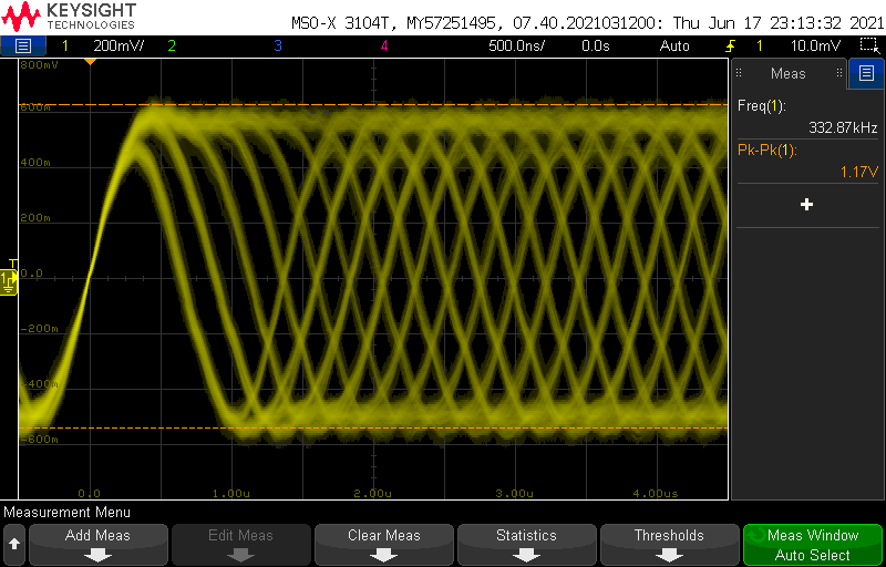

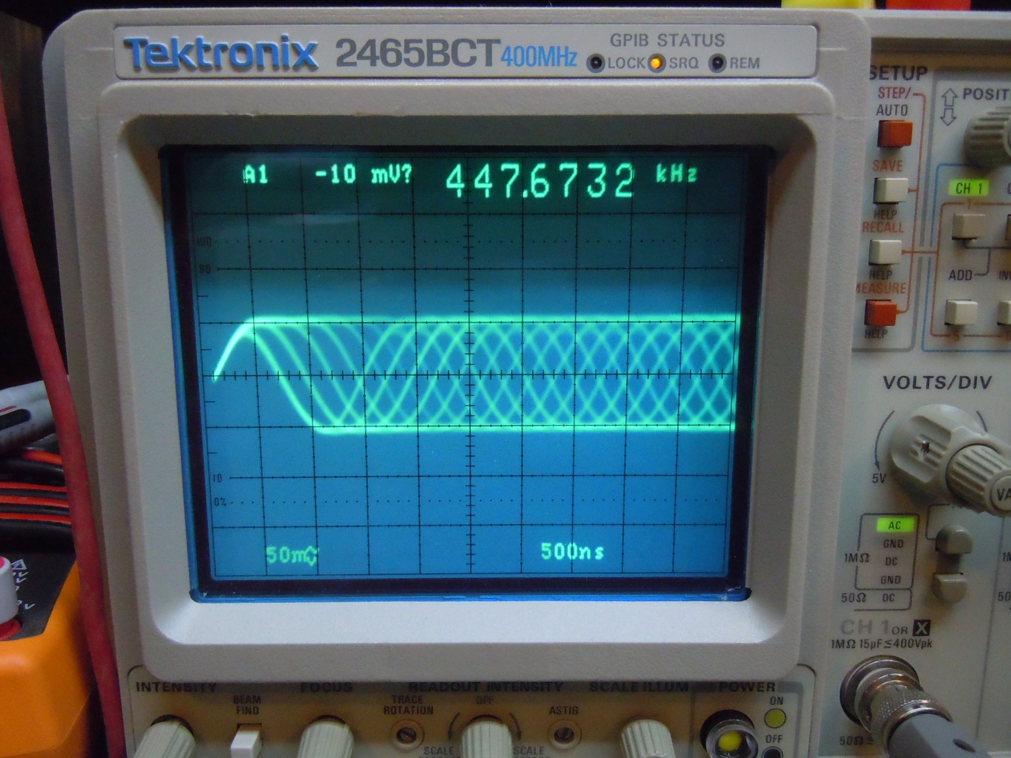

First shot, analogue scope.
Second shot, very expensive digital scope (direct capture).
It took me to get to a Keysight 3000 series 1 GHz scope to get eye patterns I could use. So I always recommend a decent analogue oscilloscope for audio work. I keep my analogue scopes for this reason, although the Keysight operates very well.
