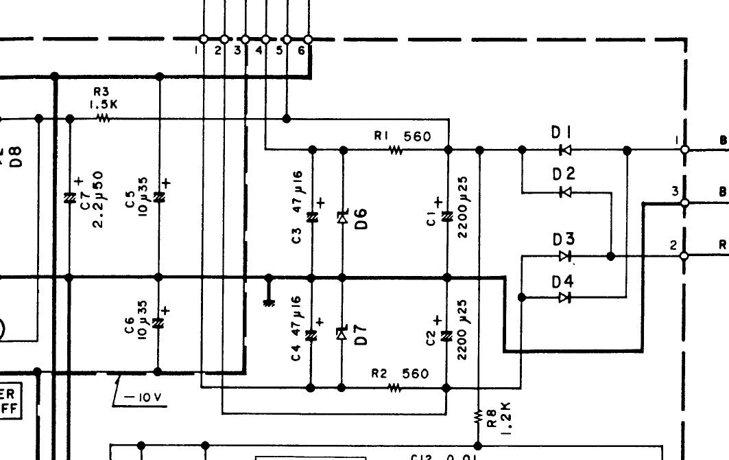

Hello,
I'm restoring a Japanese Kenwood KP 7010 and need a little assistance from someone who knows with this unit. I have the service manual which lists everything except the resistor located at R2. The main caps leaked so badly I couldn't identify the resistor by color or bands. I've attached the manual, the board schematic is on page 9.
Other than the leaky caps, a damaged dust cover and missing main counterweight I can't wait to get it running and see how it compares to my KD 5066. I appreciate any help or info someone can provide.
Thanks so much, Scott

560 ohm, same as R1 (from your own file)?
