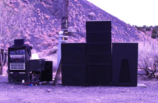

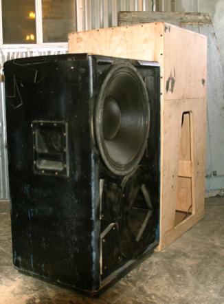

Photos of finished Keystone Subs and the bass reflex (BR) cabinet as it was used for testing are in post 1039.

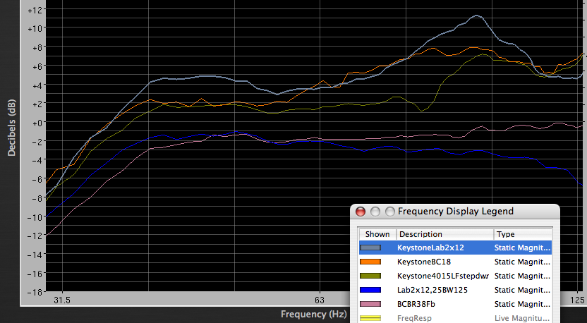

Comparative tests using the Keystone Sub loaded with an 18 inch B&C18SW115 (four ohm nominal), a 15 inch Eminence 4015LF (eight ohm), and two Eminence Lab 12 (6/2 =3 ohm) were conducted in March of 2011.
The same 16.6 inch diameter cut out was used in each case, the 4015LF used a “doughnut” adapter, the Lab 12s used an adapter that centered the two speakers on the cut out and provided a stand off so they would not slap at high excursions. The Lab 12s have a "saddle shape" frequency contour, the 96 Hz peak needs to be removed with EQ for flat response.
There are a few other peaks and dips in the response curves due to very windy conditions, often requiring waiting minutes between gusts to record responses. Test day was literally a sand storm, the bottom of the cabinet was filled with coal dust and tumbleweeds after.
All the speakers were driven with the same level. The 4015LF is actually about the same sensitivity as the 2x12 pair, since it has about double the impedance minima.
A BR (bass reflex) LAB 2x12" (36 FB) cabinet, exactly half the size of the Keystone sub is shown in the blue trace, it’s upper response is slightly reduced due to a Butterworth 125 Hz filter, all the other subs used a BW 1000 Hz filter.
As can be seen the 15.5 gross cubic foot Keystone Sub TH loaded with the B&C18SW115-4 sensitivity averages 6 dB greater than a 8.75 gross cubic foot BR.
Twice the power and drivers in a pair of BR cabinets weighing at least 40 pounds more, and occupying 2 cubic feet more trailer space are required to equal the SPL output of one Keystone Sub. The pair of BR would be capable of few dB more output below 45 Hz, the Keystone Sub +3dB or more SPL above 45Hz, more "punch" where you may want it.

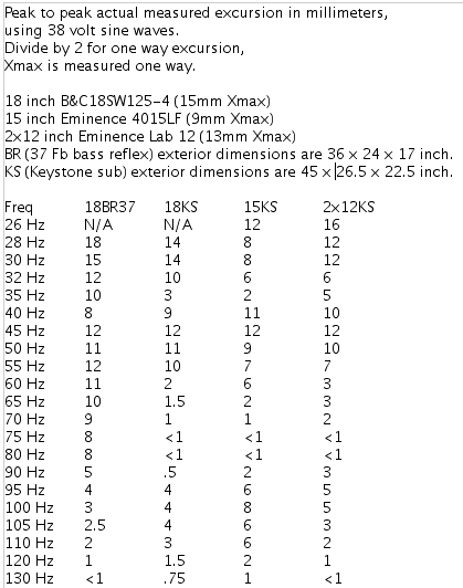

The Eminence speakers used in the tests are a bit more sensitive, the 4015LF would be the best “bang for the buck” output per watt/cost for low power applications. Making a slightly wider cabinet would allow two 15 inch speakers to fit, which would probably allow about 3 or 4 dB more output at the low corner, and 5 or 6 dB more upper level with only about 20% increase in cabinet size. The Lab 12s sound cleaner, and with the same voltage applied are louder than the 4015L. For those with limited amplifier or AC power or budget, the Eminence speakers are good choices for the Keystone cabinet.
Looking at the low excursion of the Keystone vs. BR in the region from 50-90 Hz, it is evident that the cone is under a lot of stress, quite audible sounds of distress may be heard at high drive levels using lightweight (low Mms) cones.
The very stiff cones of the Lab 12 and the B&C18SW125 can take the stresses and sound clean, when pushed hard the 4015LF sounds pretty awful.
The B&C18SW115-4, though less sensitive than the Eminence speakers, will go a lot louder with a cleaner sound given more power due to its greater linear excursion capabilities, more even BL curves (the magnet "pushes" harder further), more power handling with better cooling, and a super stiff cone and suspension.
Using Hornresp simulations at rated Xmax values, (and impedance minima) average level from 35-100 Hz, the Keystone has these output levels:

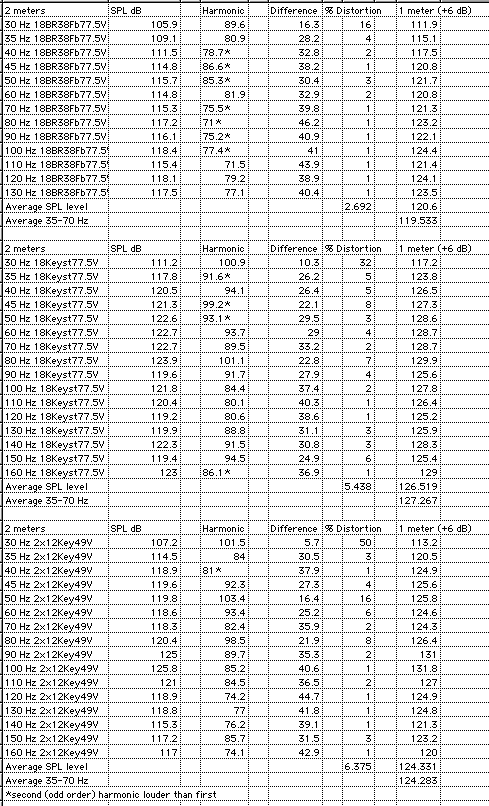

Distortion Tests
You are the OP :D
Is there any more info you will be sharing with us?
Below are distortion figures for the BC18SW115-4 in the BR cabinet and the Keystone, and a pair of lab 12 in the Keystone, using sine wave tests.
The 6 ohm Eminence Lab 12 is rated at 400 watts, tests were done at 800 watts, 49 volts into 3 ohms.
The B&C BC18SW115-4 is rated at 1500 watts, it was tested with 77.5 volts into 4 ohms.

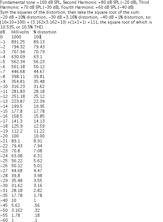

Distortion was taken as the nearest whole number from the “distortion calculator” chart below, no attempt was made to sum all the various distortion harmonics together.
More detail in the methodology and distortion readings for other speakers can be seen in this thread, page six sums up most of the information:
PSW Sound Reinforcement Forums: LAB Lounge => JBL SRX718 - Basic Distortion Measurements
My test computer was carried away by a gust of wind yesterday, suffered a four foot drop, breaking the screen :^(. An expensive gust that occurred just before the last test I was going to attempt before it started to rain.
Unfortunately I will not be able to post any distortion screen shots until the computer is repaired.
The BC18SW115-4 BR 38 Fb averaged 120.6 dB, 2.69% distortion.
The BC18SW115-4 TH averaged 126.52 dB, 5.438% distortion.
The 2xLab12 TH averaged 124.33 dB, 6.375% distortion.
In a previous test, 2xLab12 in a ported cabinet averaged 117.12 dB, 6.25% distortion.
So much for “ tapped horns are cleaner than BR” myth.
Especially since the TH have more distortion up high, the 80 Hz harmonics march right up into the 320 Hz and above range.
Of course, if the BR were given enough power to be the same level as the TH, it’s distortion would be higher, though the upper end would probably still be clean.
The 2xLab12 TH is about 2 dB more sensitive than the B&C TH, so should have been within a dB of it with half the power, but the B&C was 2.188 dB louder overall.
Other than below 30 Hz,( all the cabinets need a 28 Hz or so filter) the B&C probably would be OK with at least 3000 watts peak.
The overall margin of level difference between the BC18SW115-4 in the BR compared to the TH is 5.92 dB, about the same as the sensitivity difference was in the magnitude response.
However the BR has lost LF relative to HF in the high power sine wave tests compared to the Magnitude Response tests, perhaps to port compression.
The B&C TH is the inverse, the upper 90 Hz area peak has gone away at high power sine wave testing.
Port compression is well known, the loss of upper frequencies, that is kind of “different”.
The Lab 12s, however, retained their more prominent 90-100 Hz peak, the only frequencies that broke the 130 dB one meter barrier, assuming I have Smaart SPL calibrated correctly.
I think it is within a dB or so of reality, and the BK-4004, used for the tests is rated for 148 dB at less than 1% THD.
Comparing the frequencies from 35 to 70 Hz:
The BC18SW115-4 BR 38 Fb averaged 119.53 dB.
The BC18SW115-4 TH averaged 127.27 dB.
The 2xLab12 TH averaged 124.28 dB.
In the lower range, the TH is louder than the BR by 7.74 dB, and the BC18TH has beat the Lab 12TH by 2.99 dB, using about 3 dB more power. The Lab 12s were pretty well maxed out at 50 Hz, while the BC18SW115-4 could still take another 3 dB or more overall, probably achieving 5- 6 dB more output.
I did high volume magnitude response tests to see if these frequency response differences show up with pink noise, using an amp capable of 85 volts just at clip level, the response curves for the BC18SW115-4 looked almost identical at their curves at -10 dB.
The Lab 12 had a slight dip in the range from around 45-60 Hz at high power compared to low, the power level was enough to cause power compression, as evidenced by the 45-60 Hz dip still evident even at low power until the voice coils cooled down.
During testing, at times I noted the Lab 12 magnet structure getting fairly warm compared to the ambient temperature, and a fair amount of heat coming from the vent, while the BC18SW115-4, getting almost double the power of the two Lab 12,
The amp used for the test was a Speaker Power “Torpedo” SP1-4000-DS, a “plate amp” designed to be put in a speaker cabinet, it is a good power match for the Lab 12s, (and will power four in Paraline without problem) but a bit light for the BC18SW115-4.
All this testing is expensive, I blew up a QSC PL3602 comparing it to the SP1-4000-DS, then broke my computer yesterday.
And after all the testing with the BC18SW115-4, although it will definitely put out more level than the Lab 12 or 4015LF speakers, unless I get some more powerful amps, I’ll hardly see any increase in the LF output of my system.
The many pleasures of DIY.

All the TH research, design time and testing have occupied most of my time since the beginning of February.
Not sure what you mean by the TH being “less damped” neither the TH or Thiele BR use any damping material in the cabinet.
Acoustically, I would think the TH dampens the speaker more than a BR.
The Keystone TH is almost 6 dB more sensitive overall than the BR, more in the upper region of the pass band.
To get that sensitivity, seems both sides of the cone are “working harder”, the extra loading stress seems to translate to more distortion.
The Lab 12 had a bit more distortion than the BC18SW115-4, but it’s distortion figures did not change as much between BR and TH. The BC18SW115-4 is a very stiff cone, but the Lab 12 is cone is even stiffer.
The Lab 12 suspension is looser than the BC18SW115, it is probably a bit above Xmax at the 30 and 50 Hz tests.
I did not test the distortion of the 4015LF in the Keystone, but from my listening tests it was obviously more distorted than in the BR cabinet I measured it in previously.
The 4015LF cone feels almost “mushy” by comparison to the BC18SW115.
Stiff cones seem to help lower distortion in TH.
The Eminence 3015LF is popular in TH, it is lighter (and therefore more sensitive) than the 4015LF. I’d expect it’s distortion to be higher also.
Frequency, phase and transient response differences all make for different sounding speakers. Distortion is one of the “big four” regarding speakers, yet is seldom mentioned.
It’s funny to see people worry about .01 distortion in amplifiers, when good speakers, pushed to rated power levels, frequently exceed 10%.
The testing I did can easily be done by anyone with an RTA, it would be interesting to see more results from different DIY and commercial cabinets.
Art Welter
