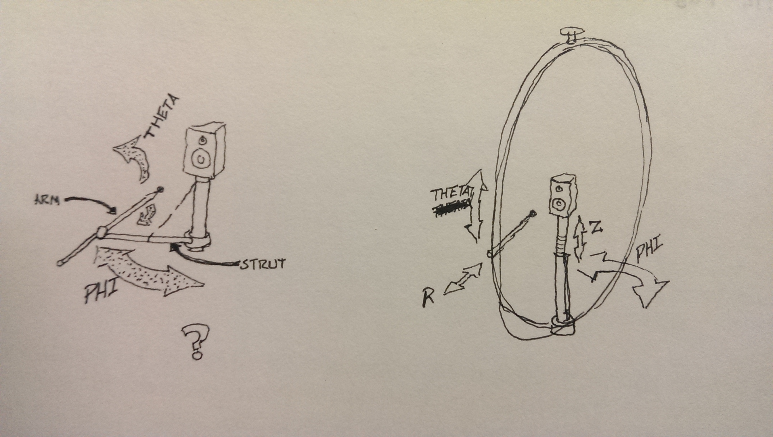

I like the simplicity, but I'm not sure I'm picturing it correctly. I sketched how I saw the description (the one on the left). Clarifications are welcome.
The one on the right is one of my early ideas for the scanner hardware.

I sketched how I saw the description (the one on the left). Clarifications are welcome...
Almost, the strut and tie is correct
Now put the strut out to the side of the speaker.
On the end of the strut is a pivot and arm to scan in theta
The arm is a quarter circle that follows the equator to the front of the speaker.
The mike is perpendicular at the end of the arm, pointed at the speaker.
The mike could be manually moved in and out, to do a 2 surface scan.
That makes the mike mount very small for minimal disturbance, and one simple adjustment when necessary.
Picture later if this is not clear.
The rationale is that there is minimum structure and simple pivots, much cheaper and easier to automate than linear slides.
The Klippel mechanics seem quite clumsy, to be honest.

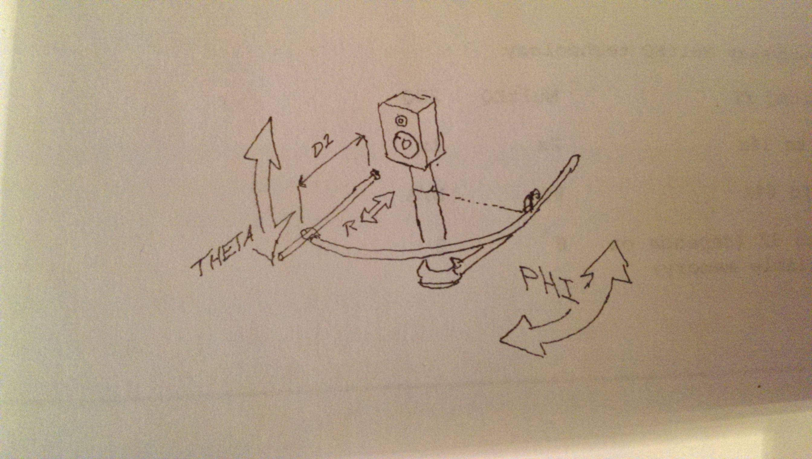

Ahh, I think I've got it now. See attached (I didn't sketch the pivot for theta very well, but it's at the side of the speaker). I like the simplicity of it, certainly preferable to trying to do something like Klippel's Z axis.
I'm thinking the length of the microphone mount (D1 in the sketch) can assist in reducing the acoustic disturbance; with enough distance a long enough impulse window can be had to remove any reflections from the hardware but still provide enough resolution to provide detail down to around 1kHz or lower... dimensions depending, of course. Making those dimensions favorable to a long IR window could easily make the whole thing awkwardly large. I'm supposing that a two layer scan with field separation would help even more, we just have to get to that point.

...See attached (I didn't sketch the pivot for theta very well, but it's at the side of the speaker). I like the simplicity of it
Thank you, I think it's a pretty neat solution, if I may say so myself.
...impulse window can be had to remove any reflections from the hardware...a two layer scan with field separation would help even more...
It should be possible to have cleaner IR than the Klippel structure and still keep the size reasonable.
Even without 2 layer scan the results should be as accurate as any other technique short of an anechoic chamber.
