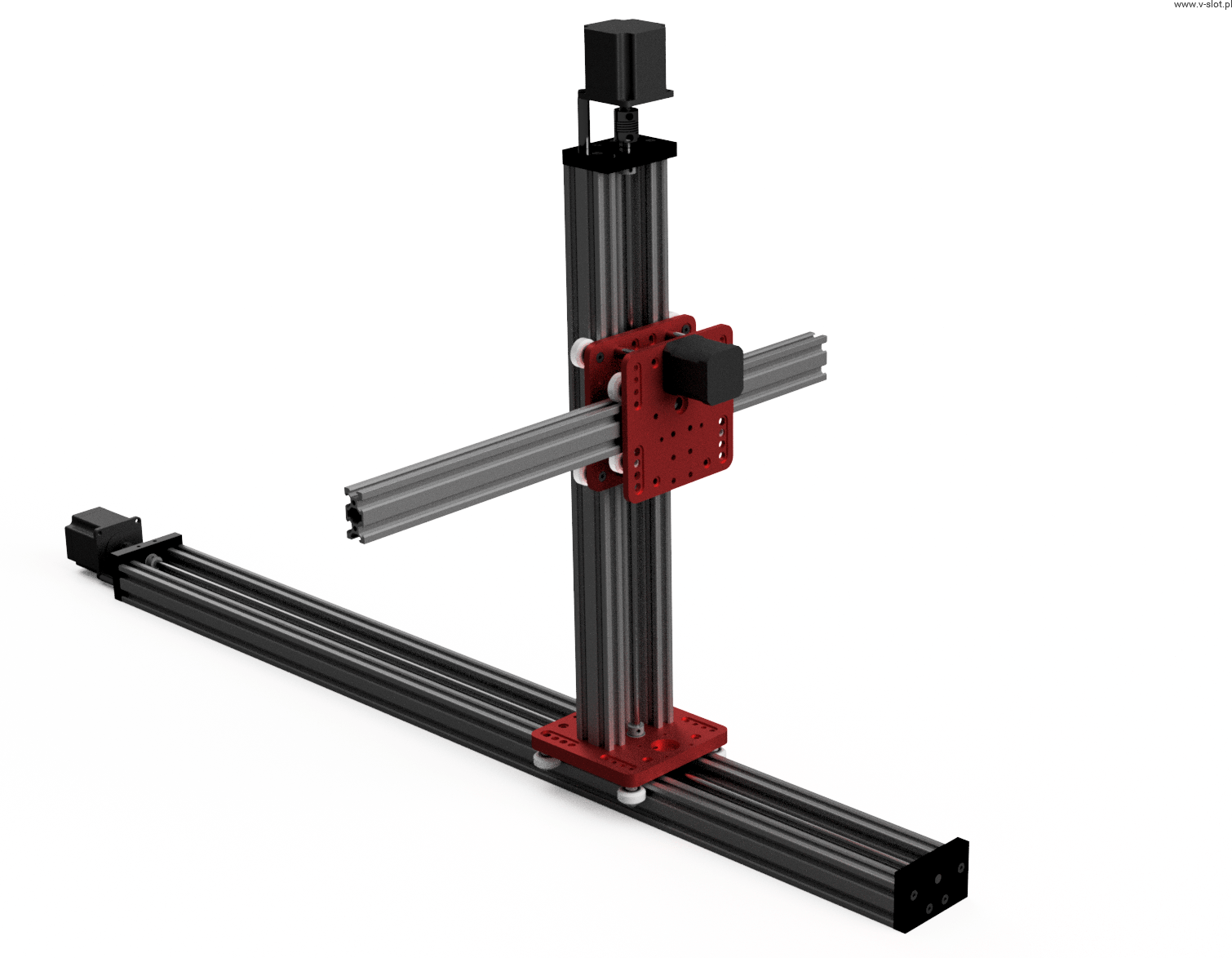

We are all thinking roughly the same. I'm deliberately making a small version, so I'm going to be a bit stubborn: I'm thinking about 2040, but 4040 is too big for me at this stage.
This looks like what I have in mind:
https://vslot-poland.com/en_US/p/MANIPULATOR-KARTEZJANSKI-XYZ-ROBOT/7014
But of course a U in one plane and I only need 2 steppers.
Reactions: 1 user

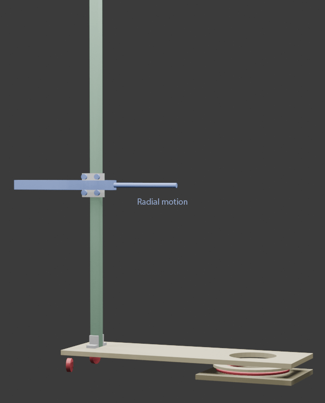

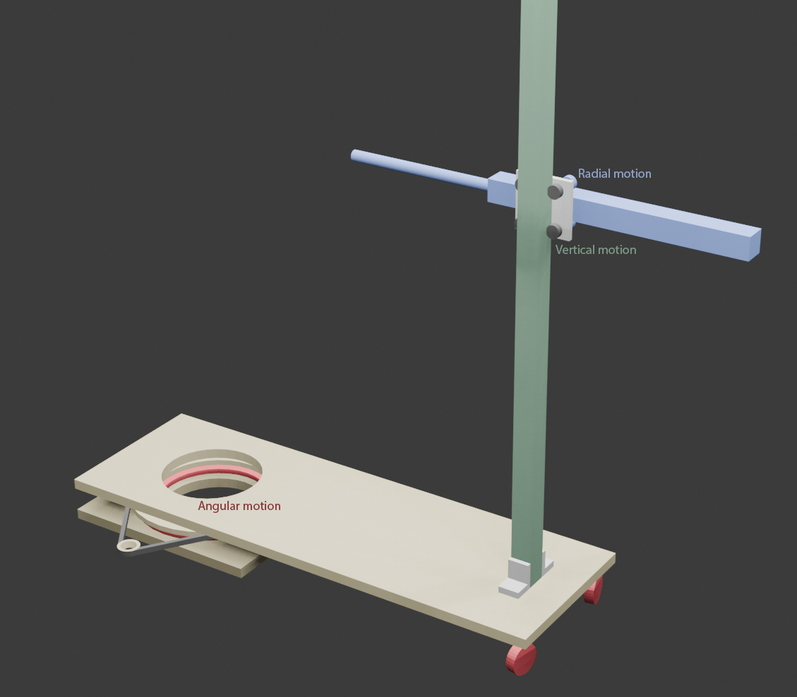

Here's an attempt to clarify what I tried to describe back in post 1338. I'm not pushing anyone in this direction, I just figured I'd post the images since I now have them. The mic would be inserted in the end of the blue cylinder, which extends from an aluminum V-extrusion that rides on four wheels for radial motion of the mic. Another four wheels (see second drawing) provide vertical motion along the green extrusion. Angular motion is centered around the red lazy Susan which supports a piece of plywood. The other end of the plywood is supported by two small red wheels. A belt driven by a stepper motor wraps around a plywood disk concentric with the lazy Susan. A pedestal of suitable height could fit through the hole in the lazy Susan and plywood.
Few
Reactions: 3 users
I didn't start out envisioning a plywood platform but came around to it when trying to keep open the possibility of some tensioned wires to keep the vertical post from wobbling. Only a test assembly will determine if those wires will be necessary; aluminum extrusions throughout would certainly look more elegant!
Reactions: 1 user

I have an idea that may or may not be helpful. For the radial movement, have two arms connected to the vertical piece, one holding the microphone, the other holding a weight that weighs the same as the mic. When the mic moves in, the other arm would move out the same distance. This keeps the total weight on the vertical piece at the same place, thus it will not bend or change position due to the mic changing position.

The motor for the vertical motion would have to stay on to maintain position unless there is a well-balanced counter-weight to fight gravity. Not having a weight swinging on a string would be nice, if possible. A brake is another option, but that's another complication that would be nice to avoid. A motor that can hold its position quietly seems simplest.
Regarding the V-wheels vs. linear rails: for a CNC router, with all the cutting forces, heavy spindle, and need for accuracy down to tens of microns, V-wheels would sure seem inadequate (I'm surprised such systems persist on the market). But to hold a mic in position, and locate things within a couple of mm? Seems like the much lower weight and cost of V-wheels and Al extrusions are a good option.
