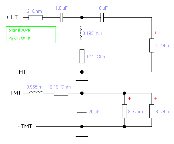

After a lot of back and forth, I decided to follow Danny's general recommendations. I designed several concepts of potential crossovers/filters. From the two-way system to the three-way to the two-and-a-half system, everything was included.

All subsequent designs now largely took this circumstance into account, but I managed to fully compensate for this inherent HT driver problem in the 2+1/2 or 3 way concepts, even if the measurement report and the simulation gave a different impression.
Every new crossover (also completely independent of high-priced component quality) and concept could not convince me. Yes, the last 2+1/2 scenario generated pretty good frequency response records, and the impedance curve was also smoothed later.
However, this technically more perfect overall result was only convincing in the immediate vicinity. At somewhat greater distances, the speaker no longer really reproduced anything, it was no longer able to captivate and create a spatial effect - it even lacked liveliness and punch.
So I put the project on ice again.
Really disappointed, I decided at some point to fully restore the original concept and filter.
Without any verifying measurements and with slightly different components, the cheapest bipolar electrolytic capacitors and air coils, slightly different capacitance values - for simplicity and availability - I got to work 8 days ago.
For 7 days now, the ancient Klipsch has been playing flawlessly again - just as I would expect from an entry-level Klipsch.

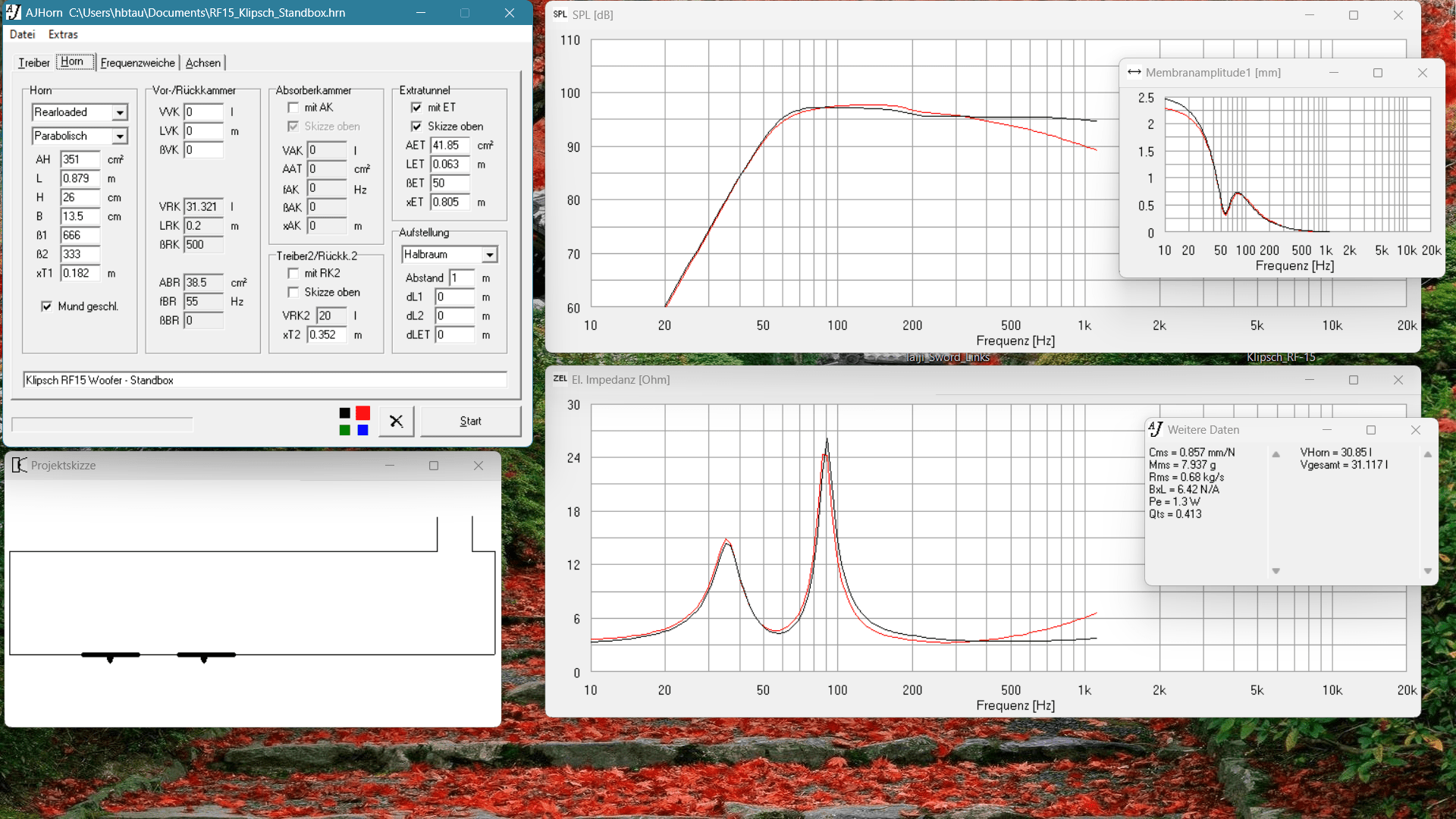

Maybe the TSP of my woofers, determined after more than 15 years of daily use and a break in the basement.
No1
No2
No3
No4
No1
- Piston Diameter = 110 mm
- f(s)= 60.46 Hz
- R(e)= 6.108 Ohms
- Z(max)= 64.28 Ohms
- Q(ms)= 4.617
- Q(es)= 0.4848
- Q(ts)= 0.4388
- V(as)= 11.16 liters (0.3941 cubic feet)
- L(e)= 0.6825 mH
- n(0)= 0.4851 %
- SPL= 88.96 1W/1m
- M(ms)= 7.874 grams
- C(ms)= 0.88 mm/N
- BL= 6.139
- K(r)= 0.335
- X(r)= 0.3468
- K(i)= 0.007056
- X(i)= 0.6986
No2
- f(s)= 59.92 Hz
- R(e)= 6.25 Ohms
- Z(max)= 74.02 Ohms
- Q(ms)= 4.543
- Q(es)= 0.419
- Q(ts)= 0.3836
- V(as)= 11.36 liters (0.4012 cubic feet)
- L(e)= 0.7164 mH
- n(0)= 0.5564 %
- SPL= 89.55 1W/1m
- M(ms)= 7.873 grams
- C(ms)= 0.896 mm/N
- BL= 6.65
- K(r)= 0.3507
- X(r)= 0.3483
- K(i)= 0.008953
- X(i)= 0.6817
No3
- f(s)= 63.83 Hz
- R(e)= 6.124 Ohms
- Z(max)= 66.08 Ohms
- Q(ms)= 4.34
- Q(es)= 0.4432
- Q(ts)= 0.4022
- V(as)= 10.01 liters (0.3537 cubic feet)
- L(e)= 0.7265 mH
- n(0)= 0.5601 %
- SPL= 89.58 1W/1m
- M(ms)= 7.871 grams
- C(ms)= 0.79 mm/N
- BL= 6.604
- K(r)= 0.4816
- X(r)= 0.3193
- K(i)= 0.004103
- X(i)= 0.7493
No4
- f(s)= 59.92 Hz
- R(e)= 6.157 Ohms
- Z(max)= 65.31 Ohms
- Q(ms)= 4.527
- Q(es)= 0.4711
- Q(ts)= 0.4267
- L(e)= 0.688 mH
- n(0)= 0.4948 %
- SPL= 89.04 1W/1m
- C(ms)= 0.896 mm/N
- BL= 6.224
- K(r)= 0.3592
- X(r)= 0.3416
- K(i)= 0.009942
- X(i)= 0.6678
And you ended up disappointed?
Difficult to answer, because technically speaking and also confirmed by measurements, the modified speaker was better. At close range and optimally positioned, it was actually perfect, except for the small level difference in the treble range between the two channels. Perhaps it should also be mentioned that in my case the speakers are not positioned with their backs to a wall; their backs face another, open room. The acoustics are not easy to handle, but at some point I figured out the trick (around 1996).And you ended up disappointed?
Danny R. is absolutely right, but in the far field and moving freely around the room, a modification simply doesn't fit.
The crossover, which has now been evaluated quickly and not yet by measurement, brings everything back into balance more lively and with a seemingly better fundamental range.
It actually corresponds to the original.
There may also be something fundamentally wrong with the 2+1/2 concept per se, in terms of sound, i.e. a completely subjective assessment.
