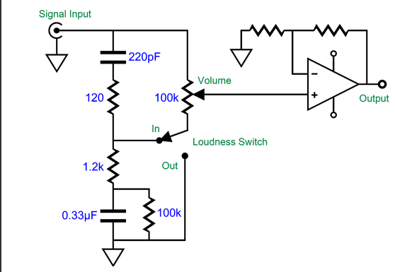

On the topic of loudness filter - I was looking at R.Slone's favorite preamp design from his Audiophile Project Sourcebook and I am struggling to understand how his loundness desing (below) is intended to work. With loudness 'IN' at volume turned down to zero the signal is not shorted to ground and the loudness network provides a voltage divider that gives already a significant signal for mids and further boosted for low and high frequencies. And indeed when I put it together and tested with line level input, it is not really usable without an additional pot between volume and opamp which will attenuate the signal. Could somebody explain if I am missing something? thx

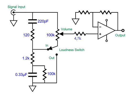

OK, I've doubled checked and the original design has a 4,7k resistor between volume pot and opamp (like below) but still at min volume it playes quite loud... I guess I should increase the value of that resistor to get a desirable level at low volume of this design?
There are pots with a 40% tap for loudness capacitors to go. If you have a stepped resistor pot a tap point may be available.
Your schematic should work. If the switch fails volume goes to max.
Yes, I am aware of designs with center tap pots. Was just curious how this can be a recommended design.... and yes, I've used a loundess switch which turned out to have a zero center position and got some really nasty surprise when first switching loudness in/out :)
