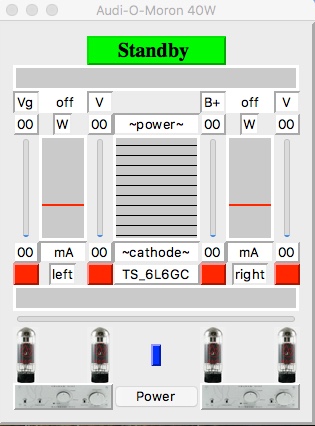

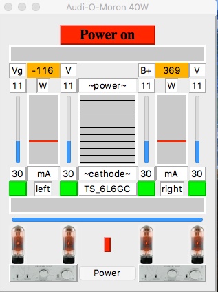

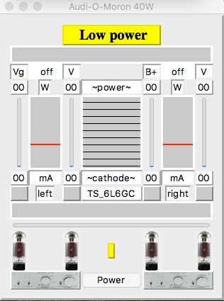

I used a RPi in mine - messing about with micro's and tubes..
This amp is still in breadboard phase, it has turned out to be great fun, but I doubt it adds that much value to the sound, but has been interesting being able to plug in a variety of tubes and the micro sorts out the bias automatically.
I have recently written a graphics GUI that can control/monitor the amp remotely.
Here is a video of the warmup sequence. The coloured squares show the relative emission of the 4 tubes (green > 80%) YouTube
And a video of the GUI while music is playing. The micro does not control bias when audio is detected. Unfortunately the recorded audio is poor, I was using the iMac internal microphone. YouTube
