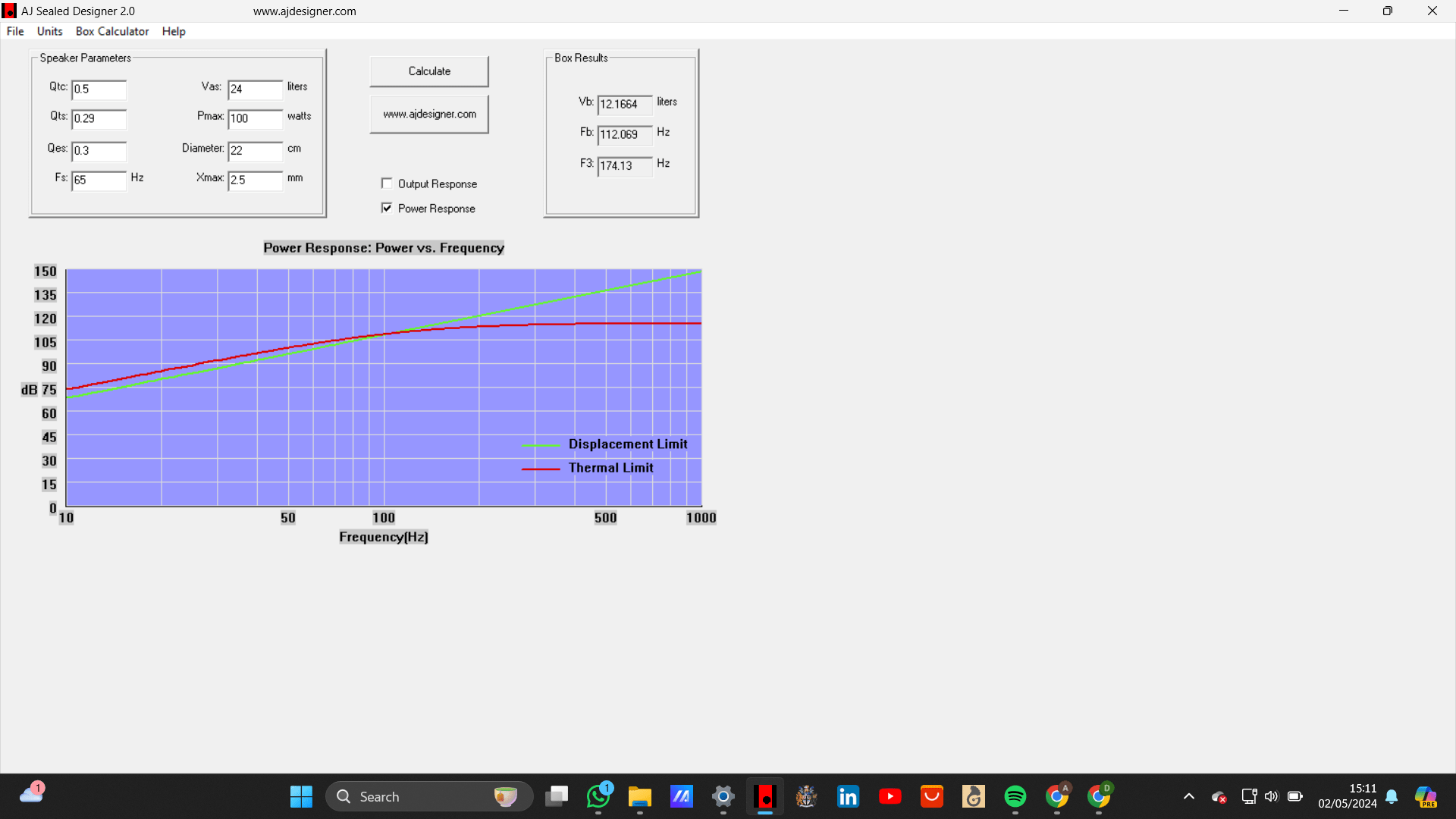

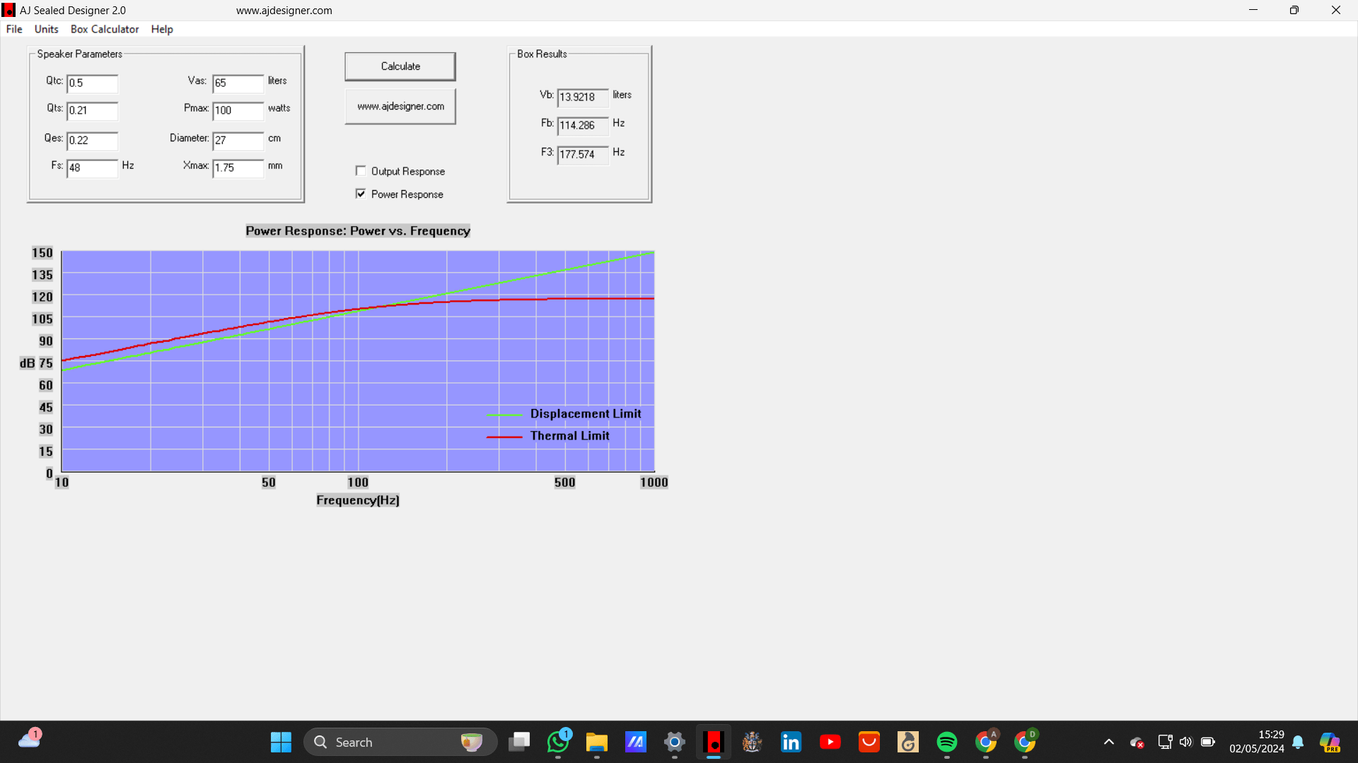

I have used the Beyma MC 500 https://www.beyma.com/en/products/c/low-mid-frequency/110G48/altavoz-10g40-8-oh/ in a small sealed box (14 liters) and loved the results, I used from about 80Hz up to around 800Hz with a DBX PA 2 crossover.
Over your 120Hz to 500Hz, it will hold very high SPL (over 118dB) at max power of 500 watts.
Here is a Sim with just 100 watts and 2.5mm Xmax (7mm max) and it easily holds 110 dB... At sane listening levels the distortion is ultra low and it sounds really textured and detailed.
I still have the loudspeakers in my upstairs system used as a two way (Beyma TPL 200 on top) and with corner placement you actually dont need to EQ that much to get great bass all the way to around 50 Hz.
