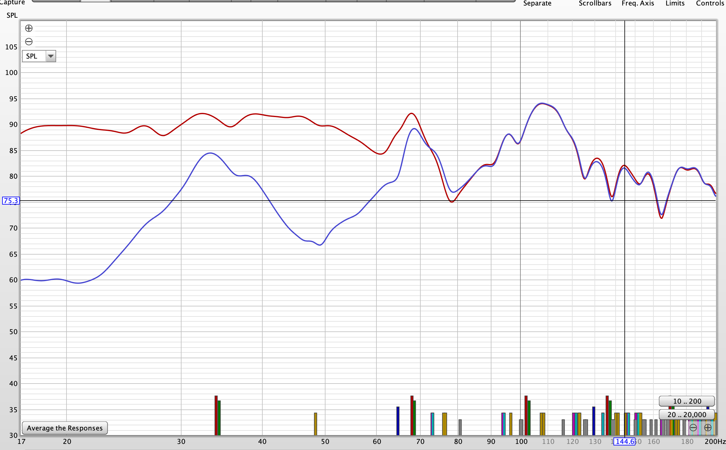

Here is an example of what I ave done with the fronts using the spare input channel on the 2x4. Set to large no subs - blue, set to large with subs connected and adjustments made to the input so the subs used with this channel just fill in the missing low frequencies
