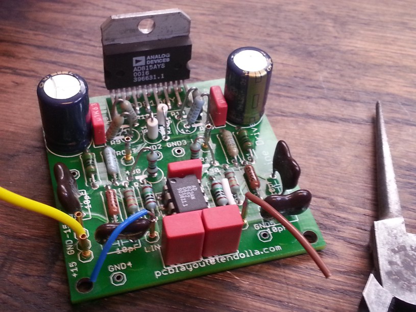

Headphone circuit removed.....replaced with my own (based on Jung composite line driver, AD823/AD815ay)

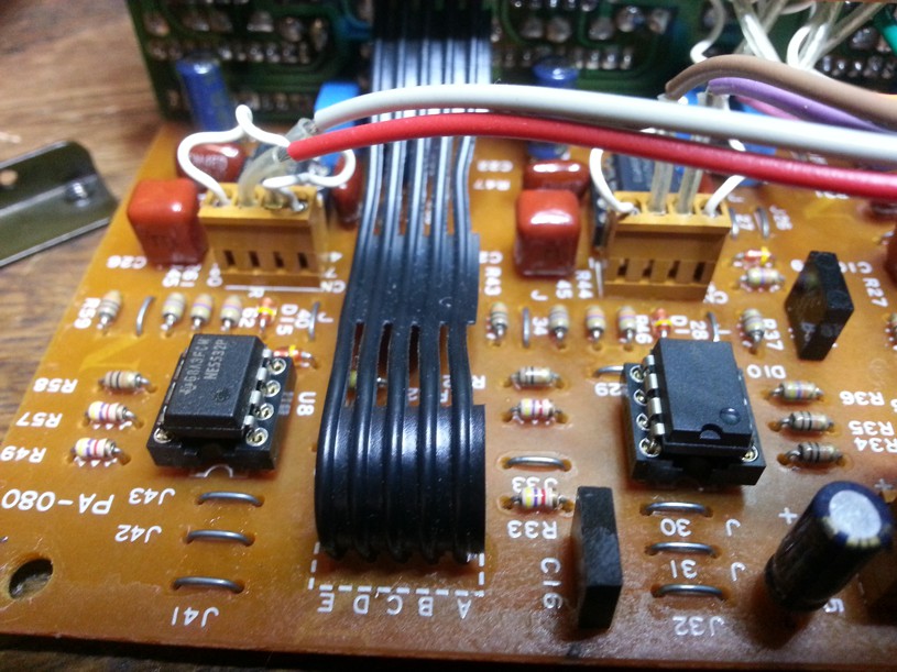

The LM4562 is a "fast" opamp. To prevent stability problems (like oscillation) I added 0.1uf ceramic bypass caps directly to the power-supply pins(4&8) of each opamp, to ground, and another 0.1uf cap directly from pin 4-to-8.......all on the underside of the board. (see pic 2)
There were NO bypass caps there, previously.
I also did NOT use sockets....the new opamps were soldered in place.
Feedback loop compensation caps used to be ceramic, now they are mica types. Where there were no compensation caps, I "piggy-backed" some 12pf caps, soldered right on top of the feedback resistor (bridging it), just to ensure stability. (I did not calculate this value, I guessed :eek: ) (see pic 1)
Preliminary testing....no oscillation ! (I was worried) The new opamps run barely warm to-the-touch.

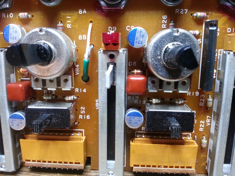

Since there are 8 stereo inputs, I reserved lines 7 & 8 for "opamp swapping", where I did add opamp sockets. This is just for curiosity and testing. Right now, one line has NE5532's, and the other OPA2107's. Will I be able to hear a difference ? Time will tell. (see pic 4)

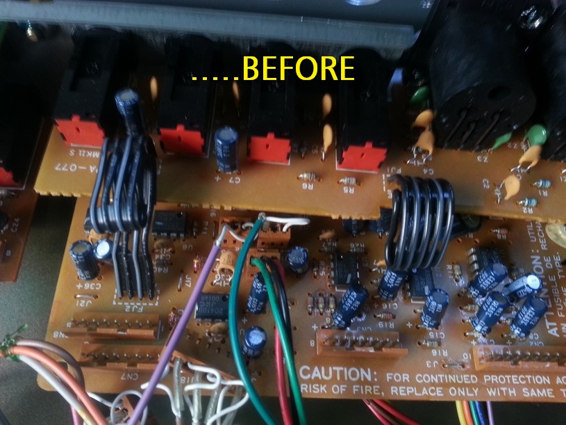

Mixers like this are chock-full of DC blocking caps at the opamp inputs, because a variety of outside signals are fed into the unit which may be passing along unknown DC....making such caps nearly necessary. (see pic 7 "before")
All those caps were previously electrolytics, so those were replaced by film types.
There were a few places that still needed electrolytics.....and I didn't wildly replace ALL of them. The electrolytics left in the circuit were swapped out for newer versions. (I even tried some polymer 'lytics) (see pic 3)

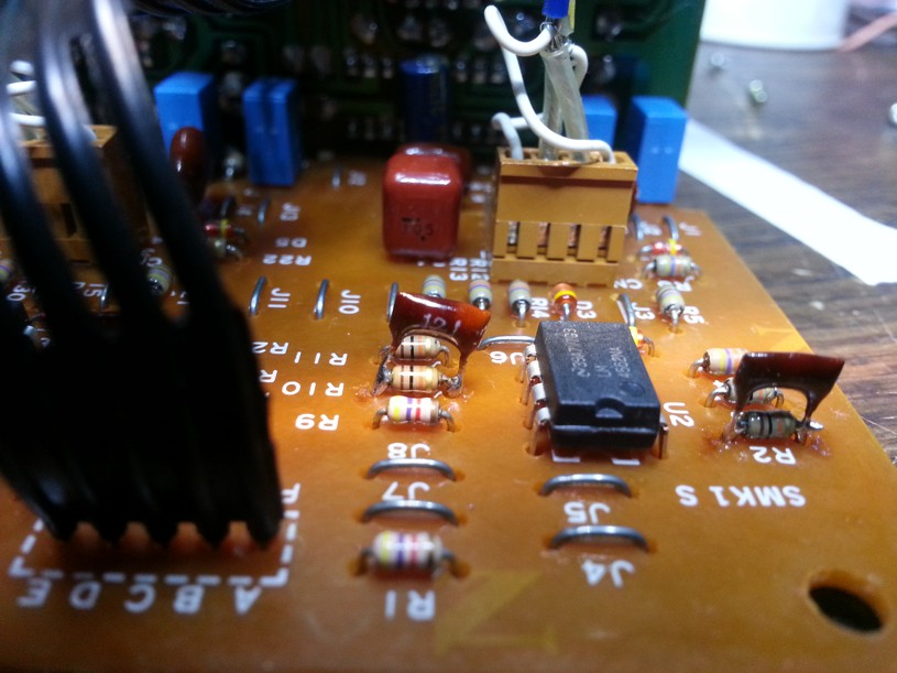

The original headphone circuit seemed weak, as it employed just one 5216p dual opamp, for stereo. I'm adding a separate headphone board I "designed" (actually, Jung did, I copied it for my private use, I made a few adjustments)....that fits quite easily inside. (see pic 5)

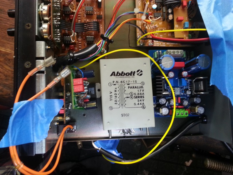

The original PSU circuit fed the entire unit with +12.6v.
I am able to raise this to suit the opamps with my new PSU, but I need to think about....if the metering circuits can handle up to +15.5v (??). The output level meter already has trimmer pots for level adjustment.
A (shielded) transformer was replaced accordingly, to suit higher voltages if desired. (see pic 6)
