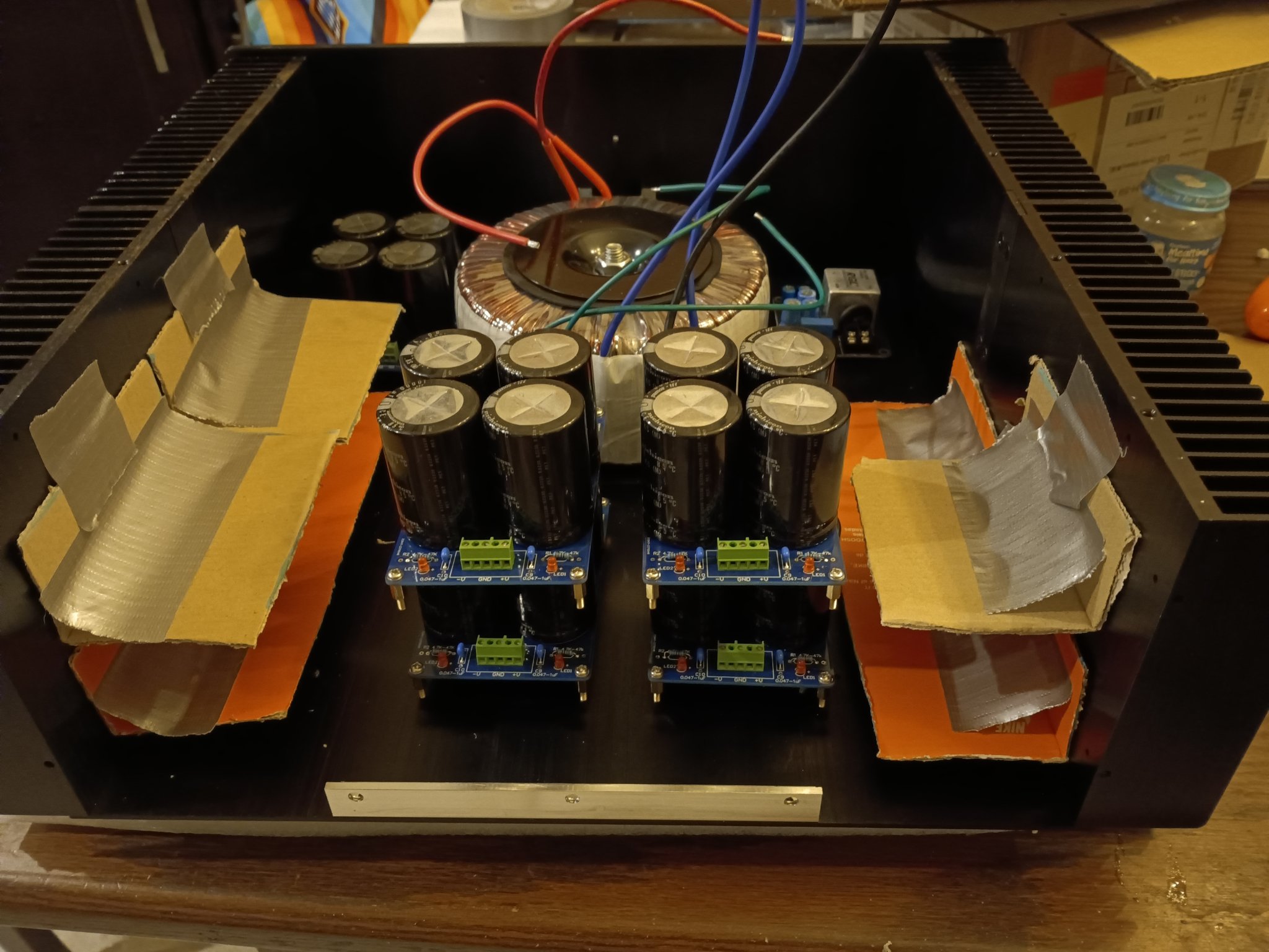

If the primary use case is music reproduction, I would go with the Modulus-686 on the left and right channels. Modulus-286 on the centre channel for sure and maybe for the remaining surround channels as well. The Modulus-86 would likely work well for the surrounds as well. I don't think there's ever a lot of information in the surround channels.
I'd use the Modulus-686 on the subwoofer as well if you have one.
But as pointed out above, the amount of power needed depends a lot on the size of your listening space, your speakers, and your preferences around SPL. I had a larger listening space in my previous house. It was maybe 35 m^2 in an L shape. I did find that my somewhat inefficient KEF R700 speakers (8 Ω, 85 dB @ 1 W, 1 m AFAIR) sounded better with the Modulus-686 than with the Modulus-286, even though the 50-60 W afforded by the Modulus-286 should be plenty.

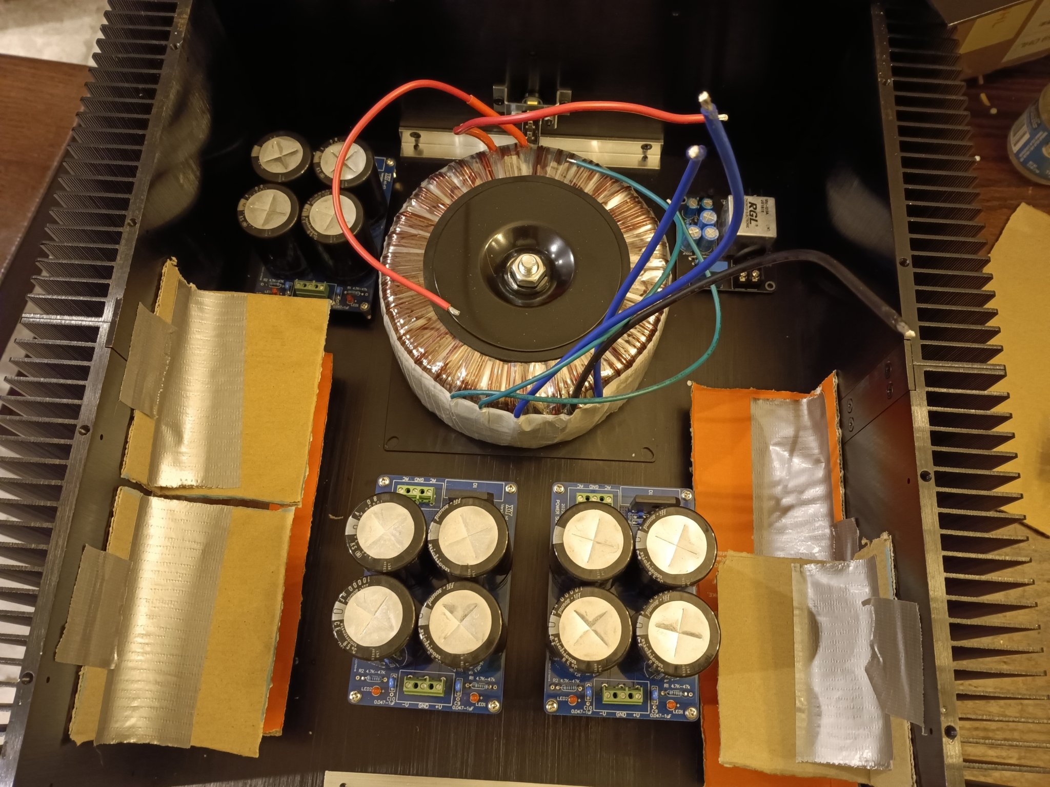

I finally got my chassis and transformer came in on the beginning of the week I was out of town for work all week and just counting the days to come home and start mocking everything up. As you can see I don't have the amp modules yet but I made cardboard for now in those dimensions just to see how things fit. I've got the 686 modules towards the bottom of the heat sink figured that would help dissipate heat better towards the bottom as heat rises and the smaller modules along the top. I started considering maybe this would be an issue causing the other modules to heat up and changing performance but then when I'm in five channel mode I'm watching movies and it's not a continuous output or working things very hard the only time I'm going to be really pushing the limits is into channel mode which wouldn't matter then. The transformer is a 1000 volt amp I had custom-made with a 12 volt tap as well just in case I want to add any sort of electronics inside . Transformer might be a tad undersize but once again when I'm using 5 channels I'm really not using a whole lot of power probably only 5 10 watts Max per module. Just to save room I'll have to stack some of my power supply modules that I built but it looks like they'll fit really nice I just need to get longer standoffs to make that happen. Once I finalize my layout I'm probably going to start permanently mounting some things in there or at least making more permanent decisions on placement and hopefully very soon I can order these modules

I've got a question for you Tom so I built my own power modules use all high quality parts and all that just found the pre-printed circuit board and I made the decision to go with a lug type terminal to terminate my power feed in and feed out. Being an electrician 27 years I understand that those could be prone to fail and soldering the wiring in is the way to go obviously there's a trade off there if I wanted the service the unit it's going to be a more pain in the *** but I'm looking to go as solid as possible on this build. So I'm removing these terminals. My question is when I order the amp modules can I get those without the plug that is provided on the board or can I just order the harness separately solder my end plug your end in. Same question kind of goes for the balanced input and speaker output I bought some shielded balance cable that I've already soldered onto my back panel I'm starting to wonder how this is going to work me terminating the other end will I need to buy some tools to terminate that or could I just solder it right to the board. The way I see it it doesn't hurt to solder it eliminates problems especially on the preamp side amplifiers going to amplify everything even a week possible connection. I understand I'm totally overthinking this but I'm over engineering my dream app right now.
