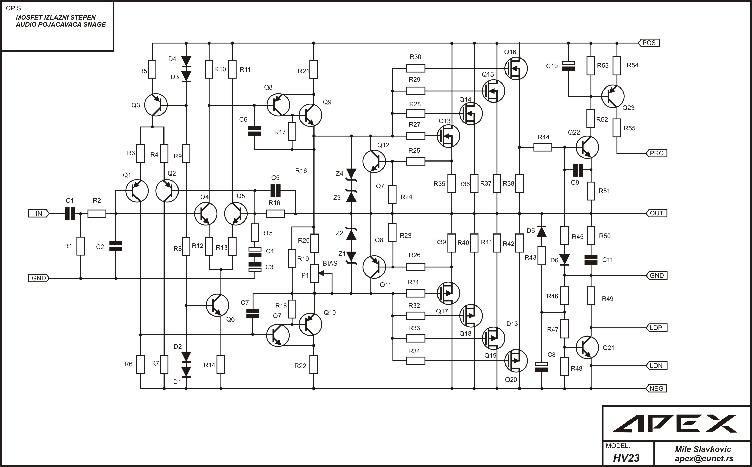

If you had used Lateral Mosfets in the output stage then i guess you could get away with such a simple biasing scheme. Lateral Mosfets have a negative temperature coefficient so they'll tend to reduce quiescent current as they heat up.
IRFP240 & it's complement have a positive temp coefficient (until they are drawing many Amps of current) so they'll conduct more current as they heat up. There is no allowance for this in your circuit diagram, you'd need something similar to what is used in a transistorised output stage.
I might be wrong, but i don't think so ;)
If you want to reduce distorsion significantly, you could add another set of transistors identical to Q8, Q9 connected to R11 in the same way Q8 and Q9 are connected to R10. The collector of the "new" Q9 connected to ground. The emitter of "new" Q8 connected to the old Q8.
And the same for the negative side. This way, the VAS is configured as a differential amp and is very likely to produce severly improved linearity. I will try this in my own amp soon, but the sims show very promising results.
Bias stabilized with Q7,Q8,Q9,Q10. Q9 and Q10 are on same heatsink with output mosfets. This circuit stabilized bias even in PA use at the summer heat. This is not experimental schematics, uses over 10 years in amplifiers.
Ok, im not doubting you ;) Q9 & 10 are effectively emitter followers though, if you mount them on the same heatsink as the output transistors surely they can't compensate for quiescent on the output stage?
Perhaps i'm having a stupid attack due to a few beers :drink: :D My apologies if this is so...
You are right.
But, I found I could get away with a simple bias if I kept the bias current down to an absolute minimum.
I just barely bias the amp into none crossover distortion using a signal generator and a scope. Its suprising how little bias current you can get away with.
I think its peavey use a similar view of using a very low bias.
Q9 and Q10 run with 30mA, bias of the output tranzistor 200mA set by P1, and bias stay stabil. Maybie must corect after few minutes but that will be small corection.
I found I could get away with 20mA on my design.
I then test by putting a household iron on the heatsink until it goes above 80 degrees c. I found it to be very stable despite not having bias transistor on output heatsink.

Actually, if D1-D4 have reasonable thermal contact with the output mosfets then they will stabilize the BIAS current, maybe just being inside the hot case might work. Not particular great, but might work in practice....
Q8 & Q12 need to have a diode, otherwise their intrinsic CB diode could be biased. Although it might not matter that much in PA applications....
And of course, the simple current limit should be made into a proper VI limiter.
Soren
Joined 2009
D1-D4 are 15V zener diode for protection not for bias. Once again I must replay this circuit is no experimental, amplifiers tested and uses over 10 years. Take a good look on this schematics again.
You take a look again, Z1-Z4 are the zeners for protection.
D1-D4 are regular diodes, they have a negative temperature coefficient, basically lowering the current though the simple bias resistors when things heat up.... And you should be happy for that because otherwise you WOULD have had thermal runaway.
Again, not very stable or predictive, but apperently good enough....
I think you got it a little wrong , apexaudio is saying his mosfets are biased at 200 mA, the vas current is 30 mA, its quite high but thats why its a cfp vas.

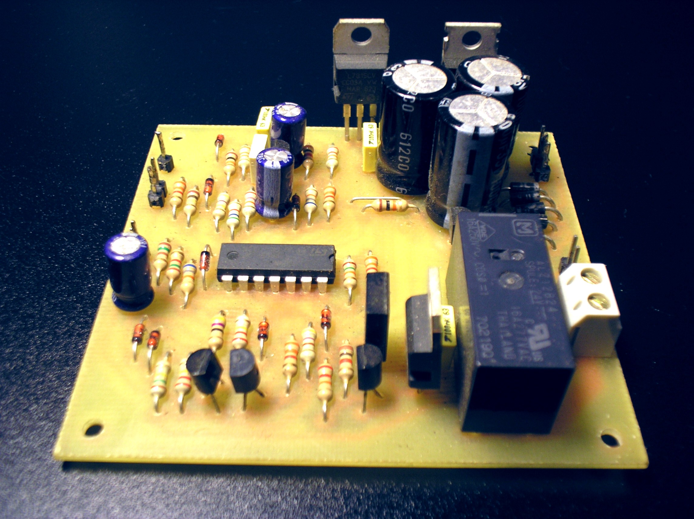

This is PCB for protection. Use 2x18V AC for power. There are Soft-Start, DC, Overload and Thermal protect on 90deg. Two speed fan control 60deg (12V to 24V) when temperature heatsink is 60deg. Stabilized +/-15V for XLR and bridge input PCB. Temperature senzor is tranzistor BD241C.
