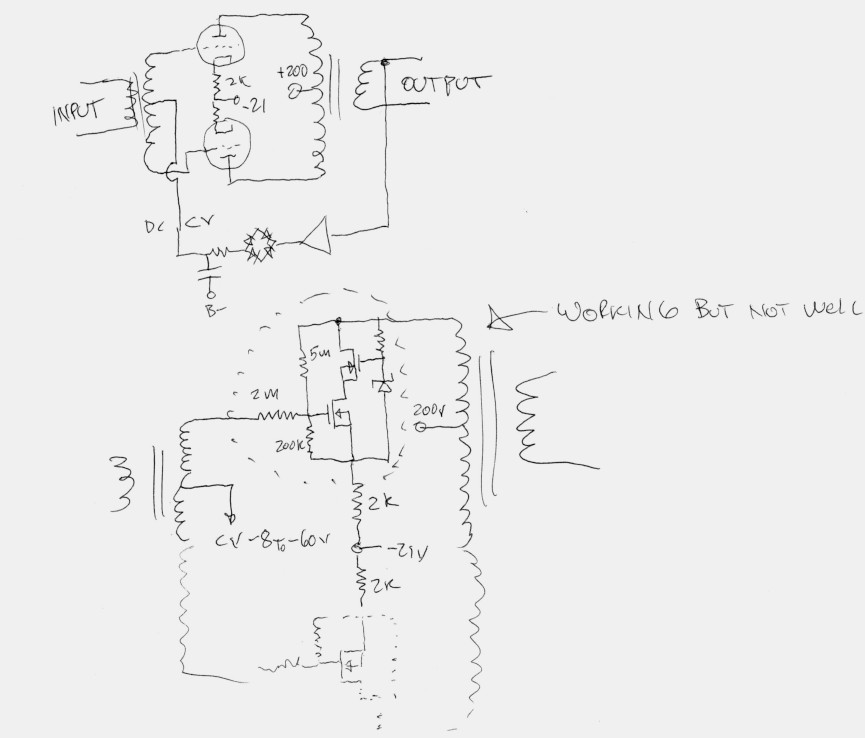

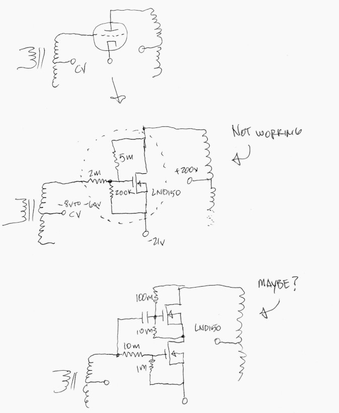

Hello, was hoping someone in this thread could help out with a little circuit I'm working on using the LND150.
I'm trying to emulate a remote cutoff tube with the mosfet. I'm using a big voltage divider to try and scale the mosfet grid voltage to plate current curve of the tube. the tube turns off at a very low -60 to -80 volts. Of course i'm only working with 0 to -3 with the mosfet.
Such a large divider shunts high end ac in conjunction with the gate C.
Lower voltage divider resistors start to affect the time constant of the control voltage. So I thought maybe stacking another mosfet with a dc blocking cap on top would enable me to bring back the shunted audio and keep the high dc resistance in tact for the control voltage.
Any thoughts on this would be much appreciated!

PRR
Joined 2003
A MOSFET is not "remote cutoff".
Also MOSFET voltages, both CV and signal, will be 10-20 times smaller than a tube.
The LND150 has action both above and below zero, which complicates the CV action.
The super-high and saturating transconductance of MOSFETs generally offer a *very* limited control range. At one end gain doesn't change much. At the other end the MOSFET current gets too low for useful signal. Specifically for LND150 my sim suggests only 3:1 maybe 4:1 range of gain above cutoff, 10dB-12dB. Far less than a tube.
MOSFETs are "good" amplifiers. A limiter needs a "bad" amplifier with a long non-linear zone.

Thanks for the replies. Hello PRR, This is for an audio compressor. I have been able to get this to work. as in the circuit below. I can actually get a good 10 db of gain reduction out of it before it totally farts out. Especially with a couple of the circuits in parallel. I would love to be able to get it close to a 6ES8 or similar. It IS close in fact but the voltage divider (2M to 200K) to knock down the control voltage into the 0 to -3V range has a audible effect over the sidechain RC time response. Especially if multiples are put in parallel. Just to clarify I included a quick sketch of your typical Fairchild type compressor circuit I am testing them in. I'm blown away at how close I've gotten with the drawn circuit but still to far away to replace all my varimu tubes yet:)
Again The problem is... if the voltage divider is of low value the compression timings are effected and if I scale up the voltage divider high frequencies get shunted.
Sorry if I'm confusing people...

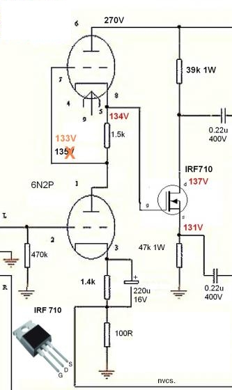

This is a stupidly simple mod I've used in modifiyng several NIVS (cheap chinese integrated) with very good results... The original "one tube for VA and phase splitter" version was inferior in all respects.
I am not saying that it is a perfect solution, but the sound improved dramatically with this topology.
Tha actually built version included grid and gate stopper resistors not shown on the picture.
