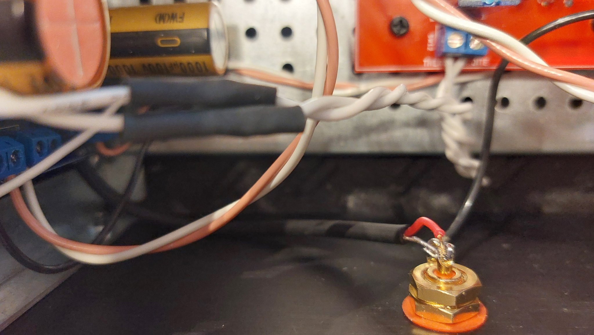

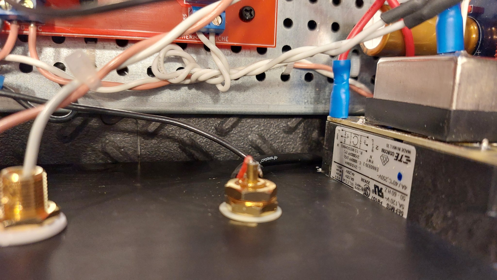

You can try to solder an 10 ohm resistor to rca ground and the other end to the original ground shielding. Inputground is splitted then and provide a groundloop over Cinch/RCA...cheap try...
Tried it without better results... Thank anyway...

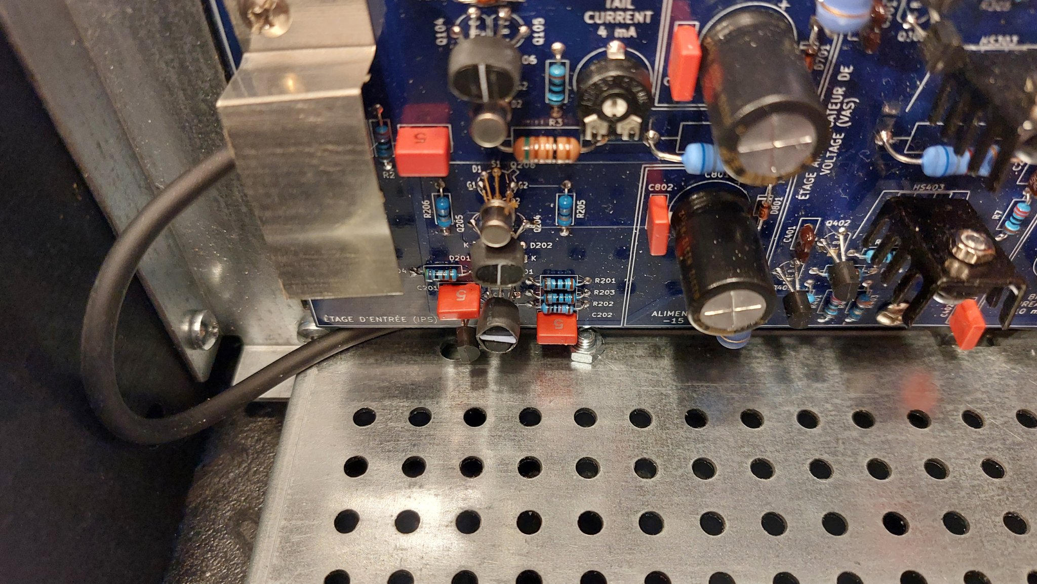

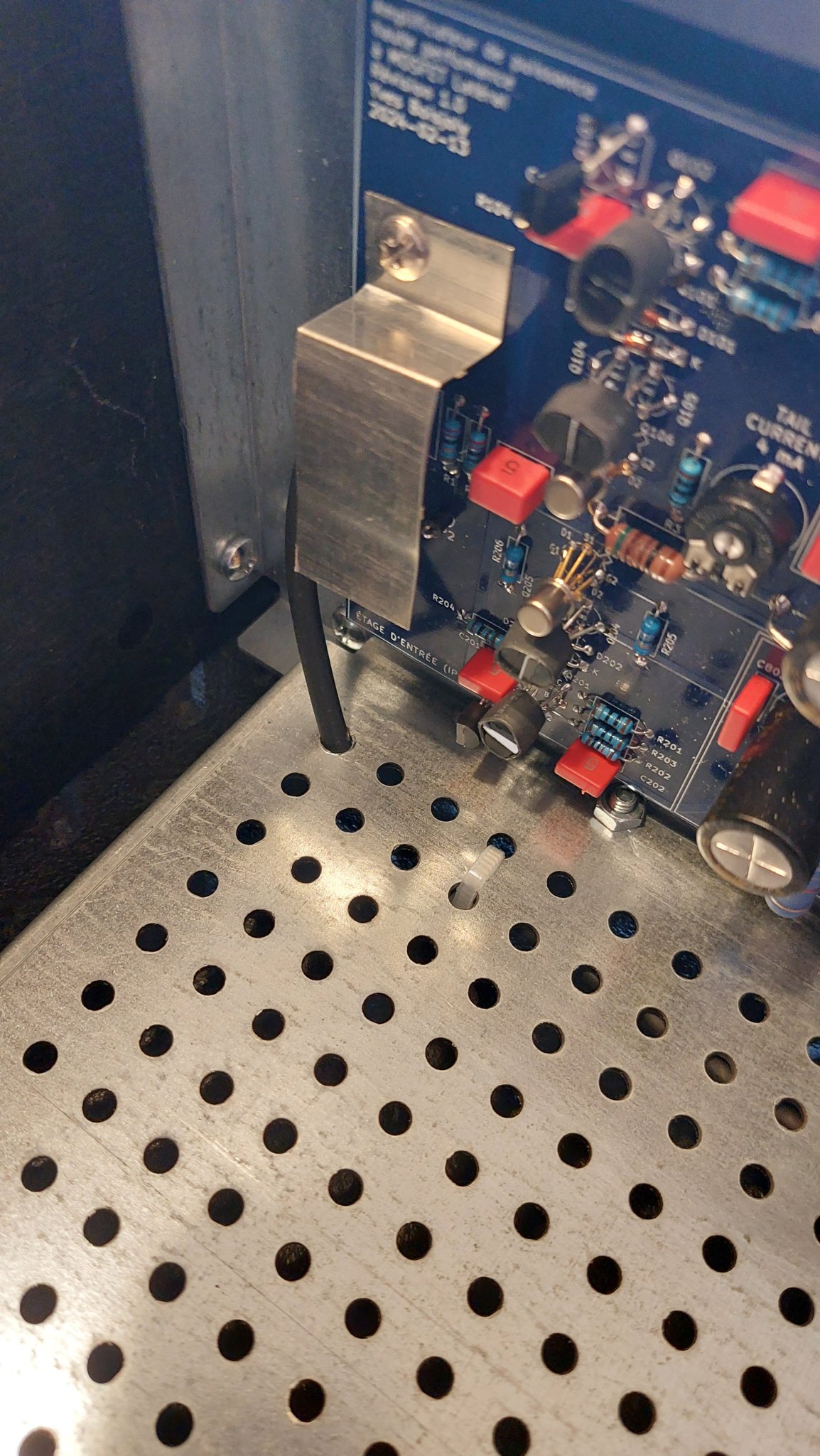

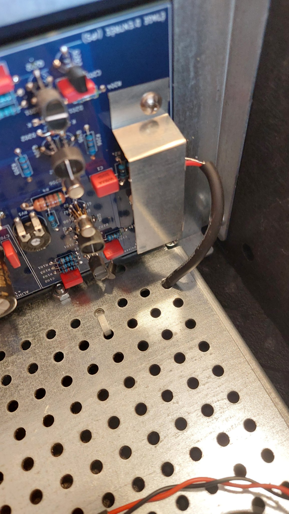

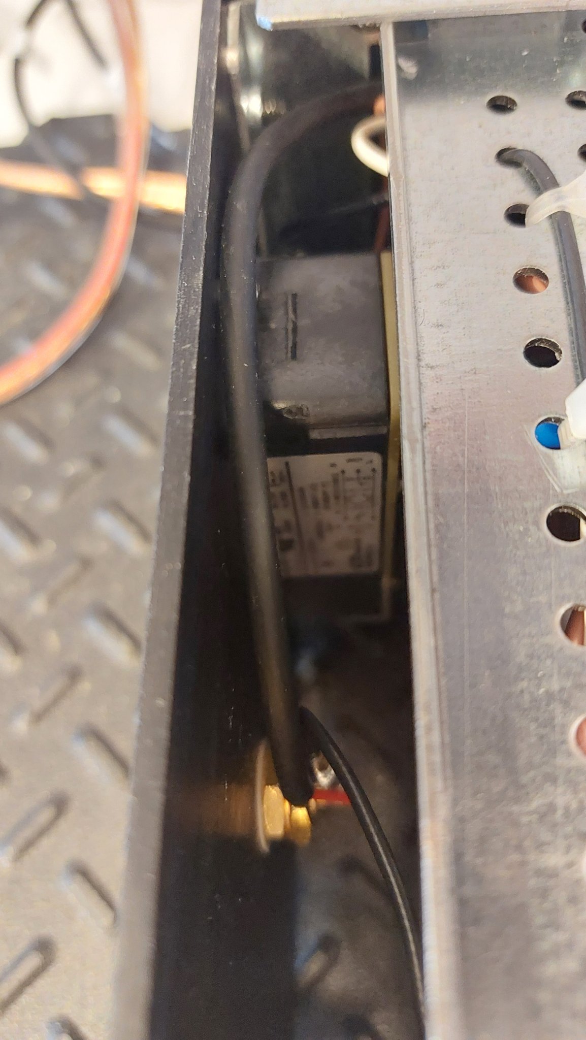

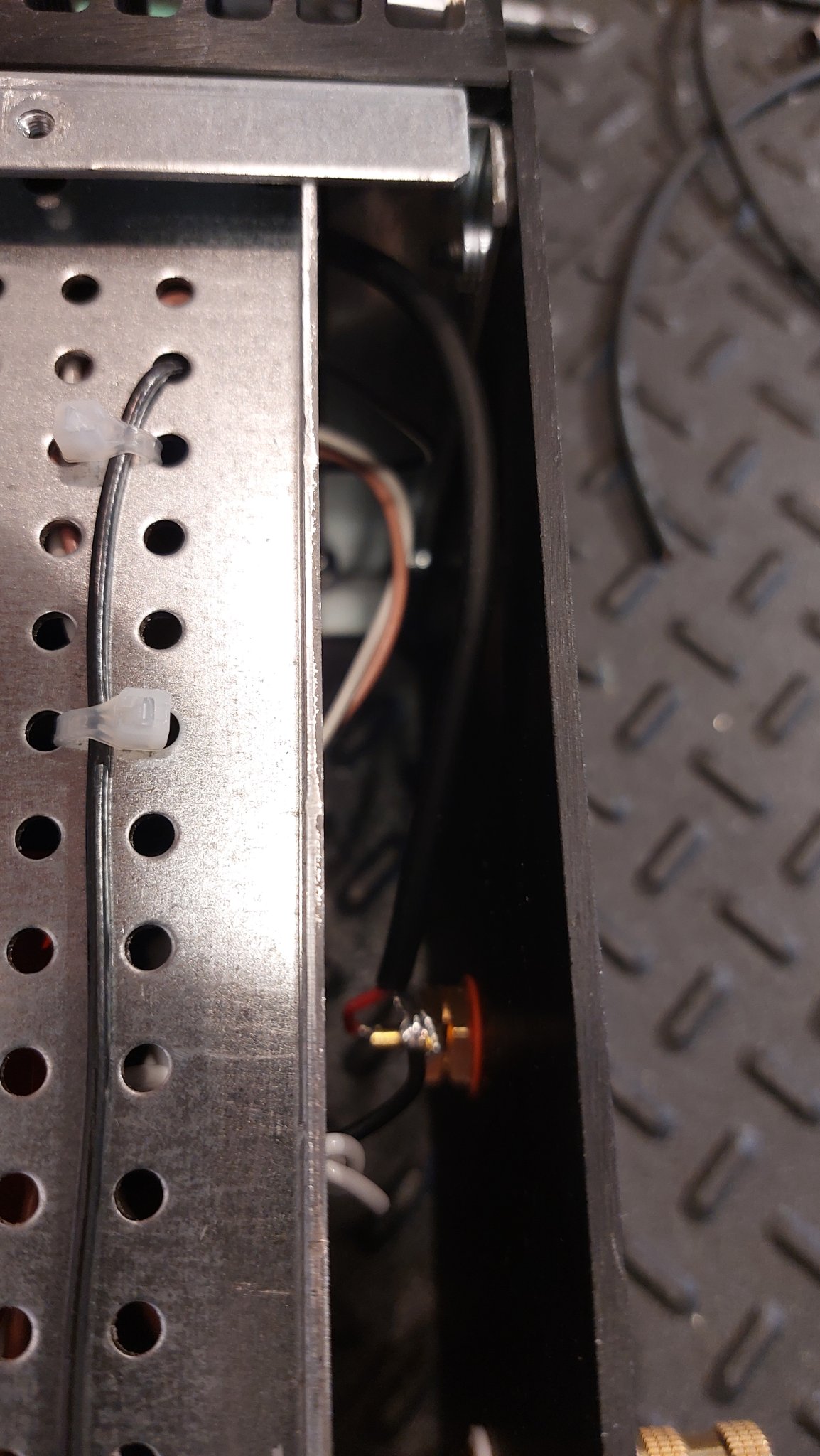

But for the good news, I fixed my problem!
I rerouted both input cables, passing them just along between the heat-sinks and the Amplifier PCB. While making the tests, I forgot that I was still doing it with the headphone, and my mind was seeking NO noise. As Bonsai document explain, the headphone are much more sensible than the speakers. I reach a level where without the RCA loop cable, both amplifiers were totally free from noise, except for the white noise that is normal, while with the RCA loop cable I still could hear a little noise. Tired, I choose to close the amplifier and leave with it like this, hopping that the noise would be a bit better.
Surprise, with all the gears connectors connected, the right speaker is totally silent. I could absolutely not detect any noise. The left speaker has a little noise, but so low that as soon as I remove the hear from the tweeter, I could not hear it! This latest probably come from the AC plug as the Input cable pass just below it.
I am much more happy now with my project :)

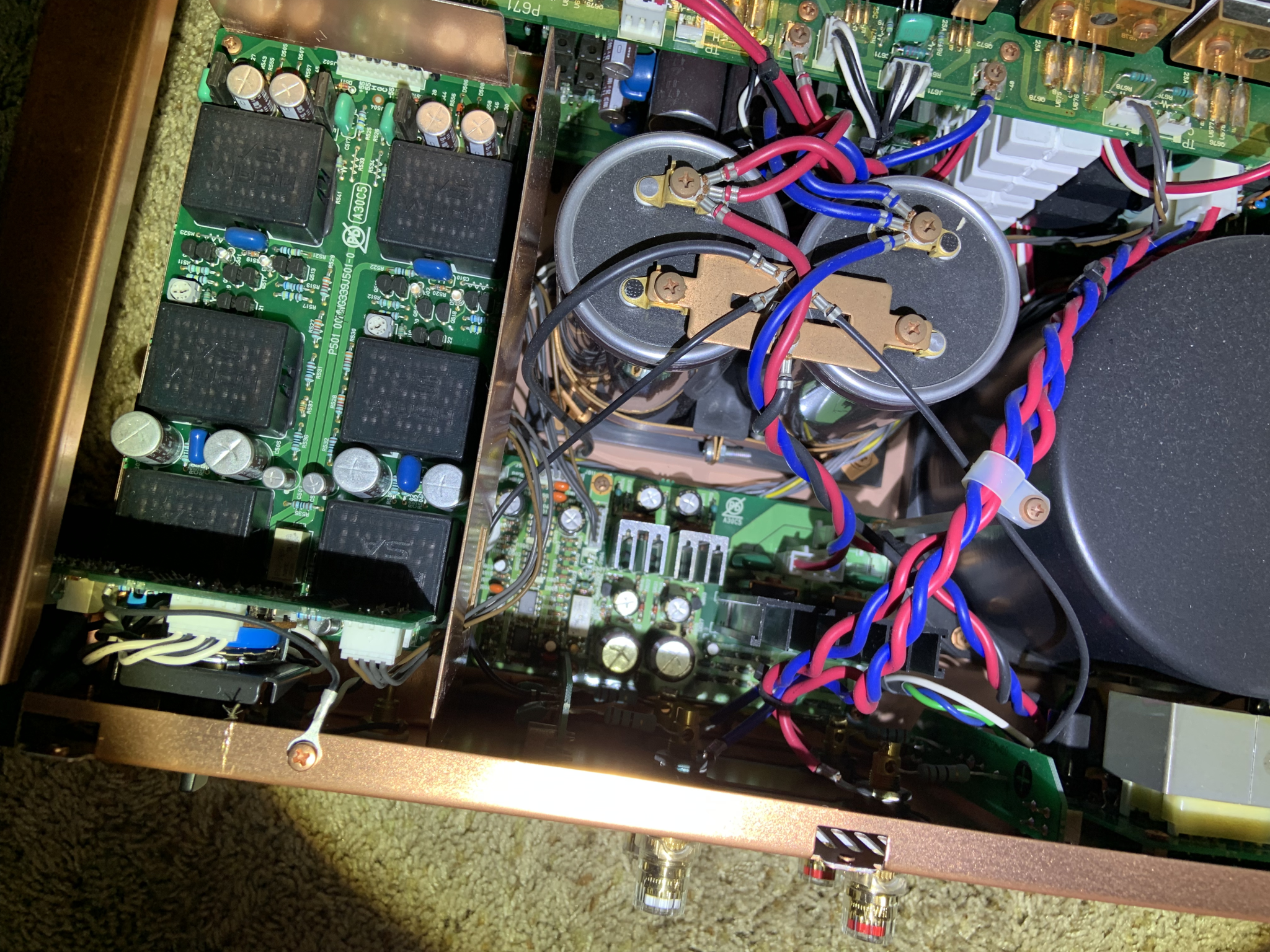

Very interesting. However well shielded, a magnetic field will induce a current, and therefore voltage - in an earth screen etc: My recent revamp of an Old Sony led to a very quiet amplifier - and now I have thought of a possible connection that may assist you.
In my design I was looking for a way to conveniently mount the toroid, and I ended up with a strong metal L bracket, that put the toroid on it's side (with a wooden mandrel to support it in the centre), and shields the internals of the amplifier with the metal bracket.
So if you have space, I can recommend to shield the transformer.
Just a simple grounded barrier between the transformer and PCBs may help.
I also use a mains filter (built into the input IEC socket) so no RF gets into the primary.

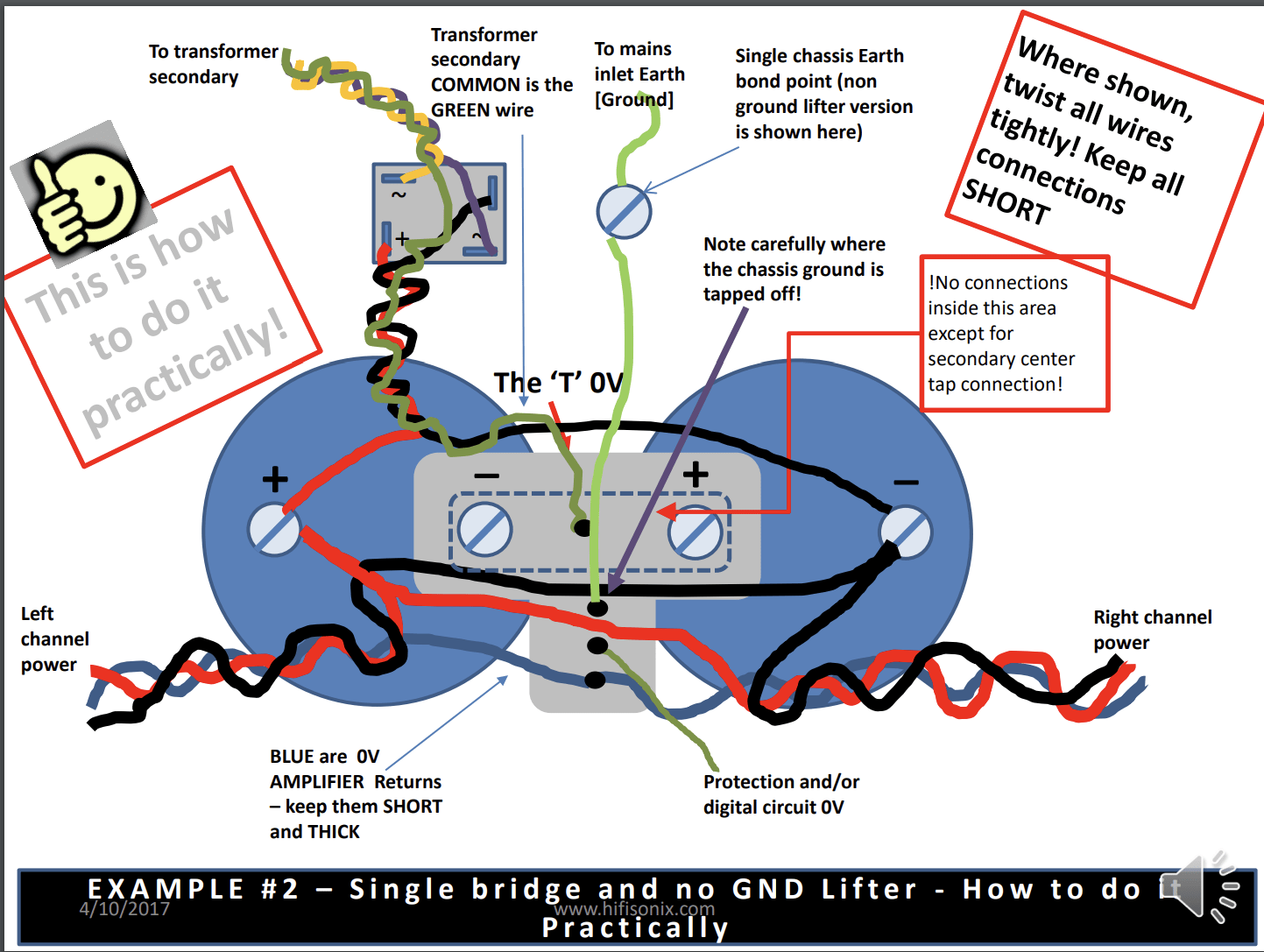

I have finished to read your presentation document. In my very first wiring setup I twisted the three cables +50VDC/GND/-50VDC with gauge 16 wires. Then I read back a comment in my book "High-Power Audio Amplifier Construction Manual" from G. Randy Slone;
I quote:
The positive and negative rail voltage wires (running to the individual amplifier PC boards) should be twisted together and kept away from other sensitive wiring. Do not twist these around the individual power supply ground wires running to the PC boards. Keep individual ground wires separate and physically removed from the rail voltages wires.
So I choose to redo my wiring, this time only twisting the +50VDC and -50 VDC together, while laying the ground wires on their own under the aluminum plate that serve to fix the transformer and the Power Supply PCB.
Seeing that untwisting the three wires from the first wiring setup have damage the jacket of the wires, I had to order new cables to redo the new setup.
Now I am reading from your document, at page 19, that the First Line Remedy is, and I quote:
Keep LOOP AREAS as small as practicable
and especially those carrying significant
current by twisting together ground and
signal wiring, and 0V supply wires with the
+ and – supply to modules. Keep sensitive
circuits away from high current circuits.
Use good quality interconnects (braided
shield) with low interconnect resistance
and high contact force connectors
So I am confuse. Should I twist all three wires together or just the +50/-50 VDC ?
Yes.
This is ambigious :D
If you have individual ground wires for pre-amp etc - these should be away from the main supply wires, yes.
The 'twisted pair' effect keeps the magnetic flux within the send and return wires. With the AC1, gnd and AC2, actually most current will be just travelling up and down the AC wires only, the ground only having a small current. Because the AC currents cancel in the twisted pair, no real voltage is generated in the braided earth travelling with it.
But any time a +ve or -ve side power draw happens, that power draw will be via the AC1 and Gnd wire or AC2 and gnd, so that forms it's own little loop, but again, that's cancelled. So braiding the 3 together is the correct way.
The same applies to the DC to the output transistors and amplifier, these wires are also, ideally, close and twisted, so the music pulses balance too, keeping the magnetics low, and also making them less susceptible to pickup (the cancellation works both ways) - but this can be more difficult to arrange. Just bear in mind a power amplifier with a half turn of wire connecting the +ve or -ve is also an electromagnet and those current paths can generate magnetic fields, which will generate voltages in nearby things, so try to keep the +ve,. -ve and grounds close on the PCB too.
So always keep the power and ground braided, yes, so the currents stay within that assembly.

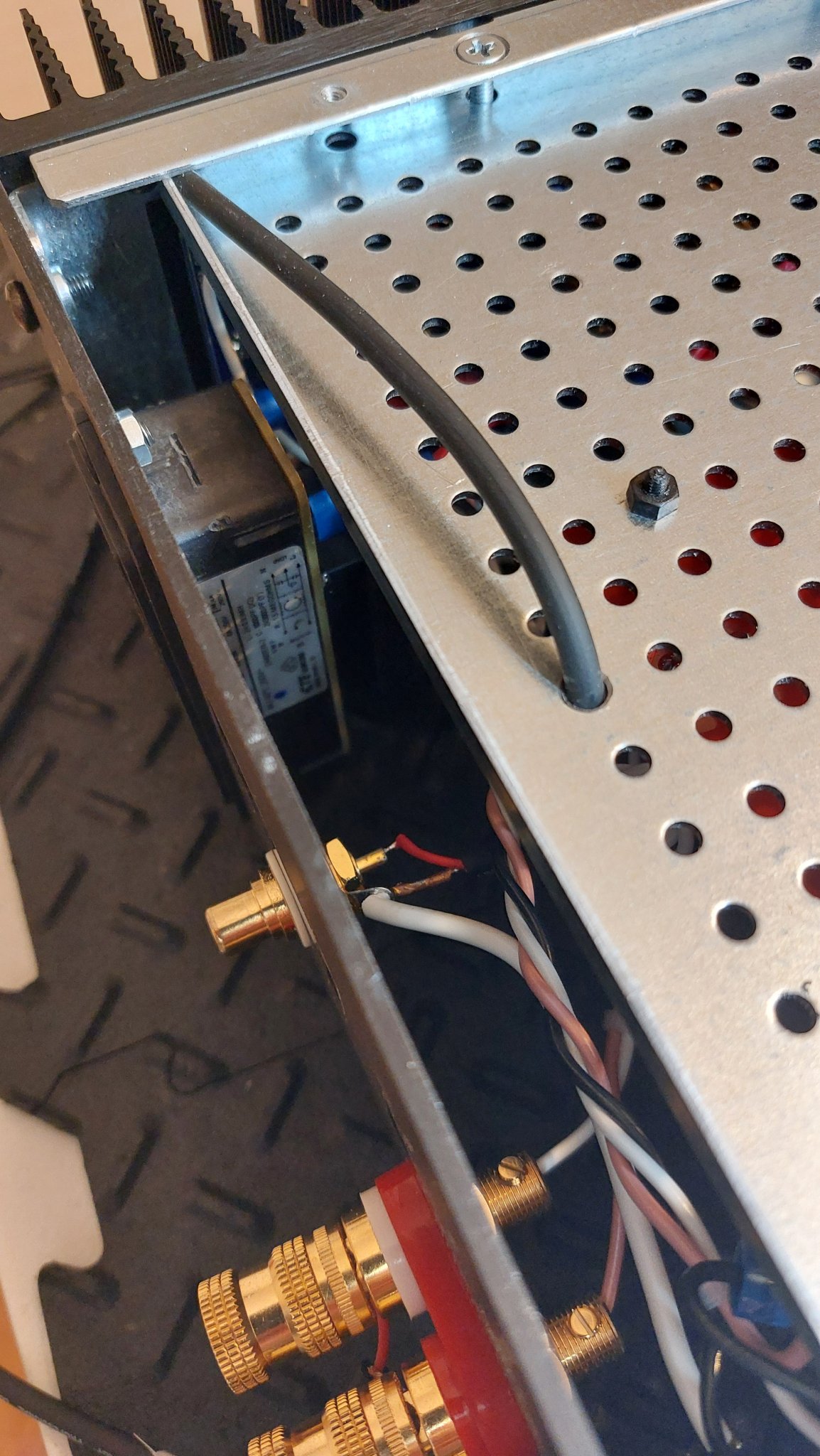

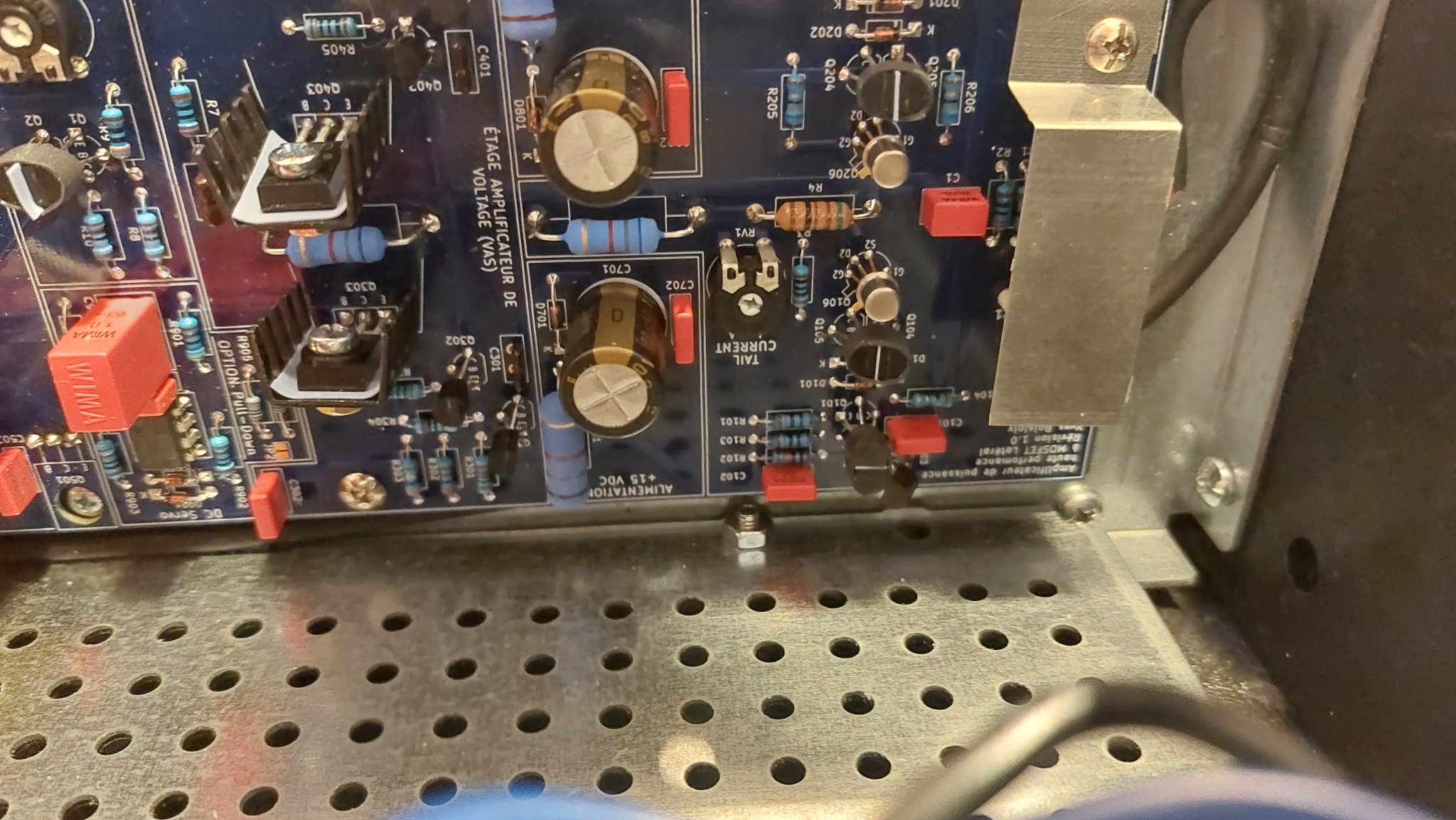

I decided to try to make a better path for the Input cables. I though it would be a good idea to make a couple of holes bigger in the grid aluminum panel in order to be able to pass the wires under this panel, in the hope to have them shielded more from the transformer. This was my first first idea but I never concluded it because the holes of the panel wasn't bigger enough to let the wires go through. I also used a gauge #14 wire to join both RCA Input grounds together, and soldered a center tap connected to the HQG.
So again with the headphone I organized the wires path to minimize the noise while having both RCA Inputs joined with an external cable.
Now, with the DIY amplifier connected to the speakers and with the RCA cable loop connected, I have better result. The right channel is as quiet as yesterday and the left channel noise seem lower then yesterday. Great I though!
But then, once the pre-amplifier gear is plugged in, the noise is back on both channels! Even if it is very low, how come could be present when the RCA loop result is quiet?!!

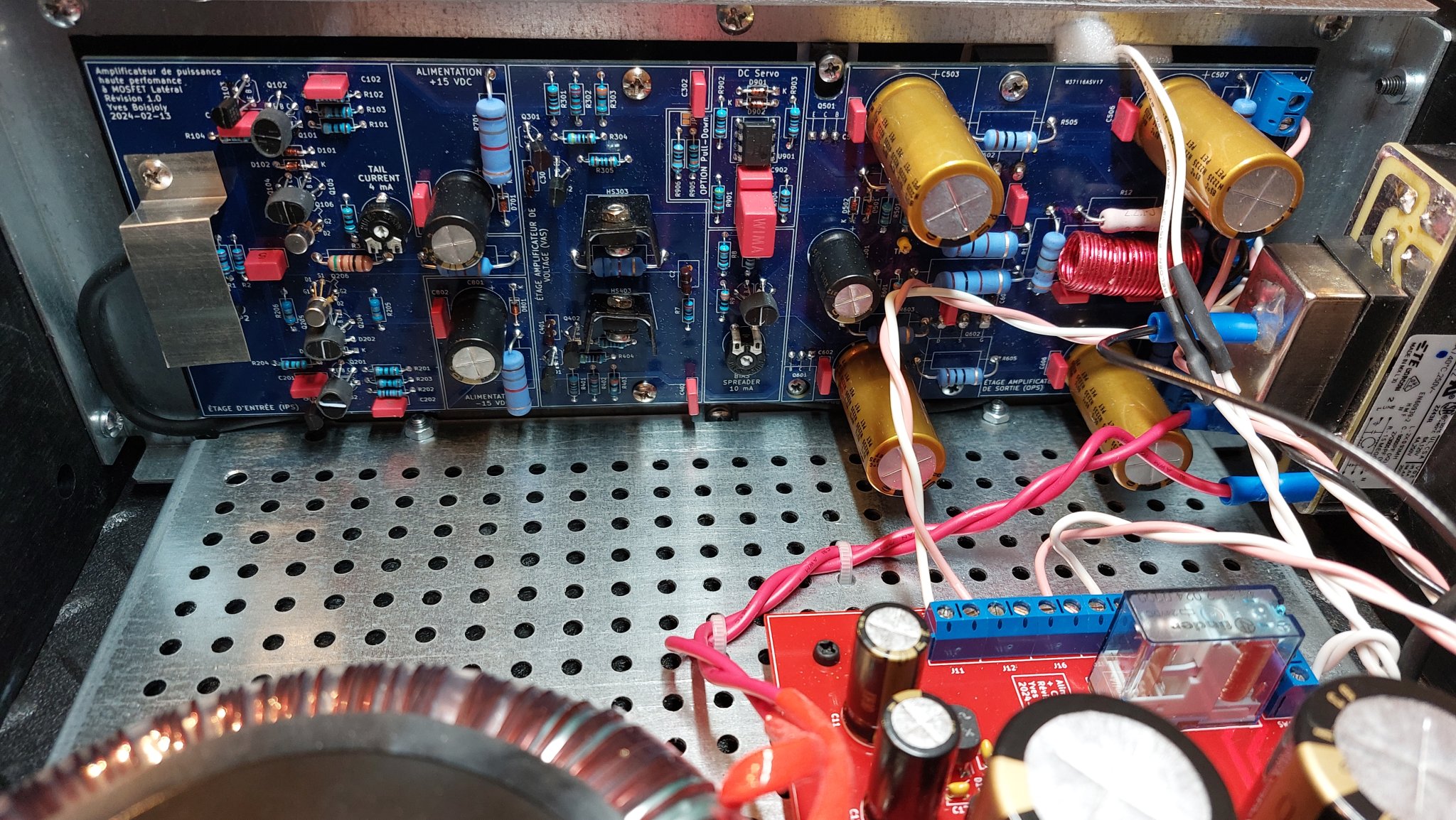

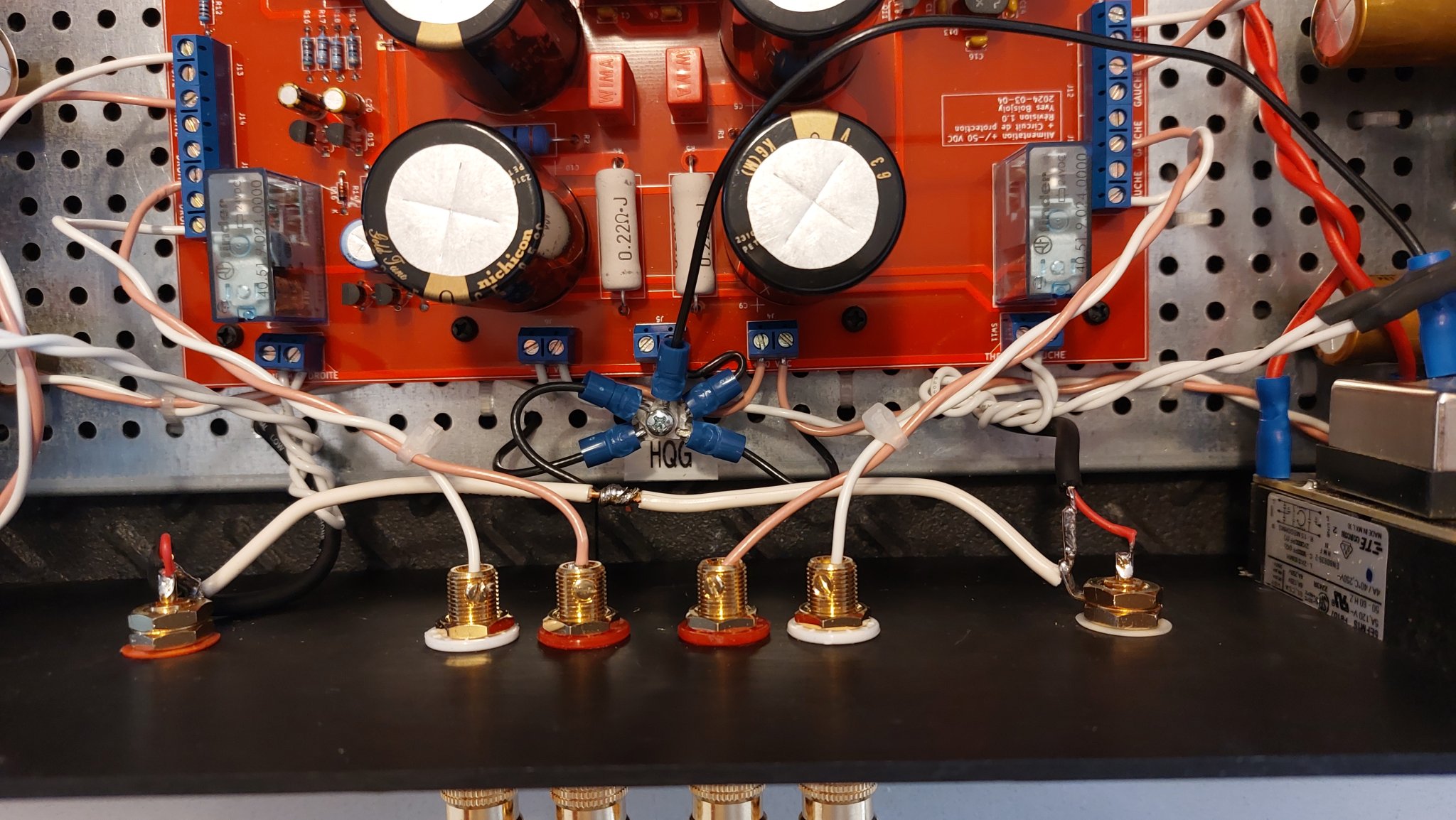

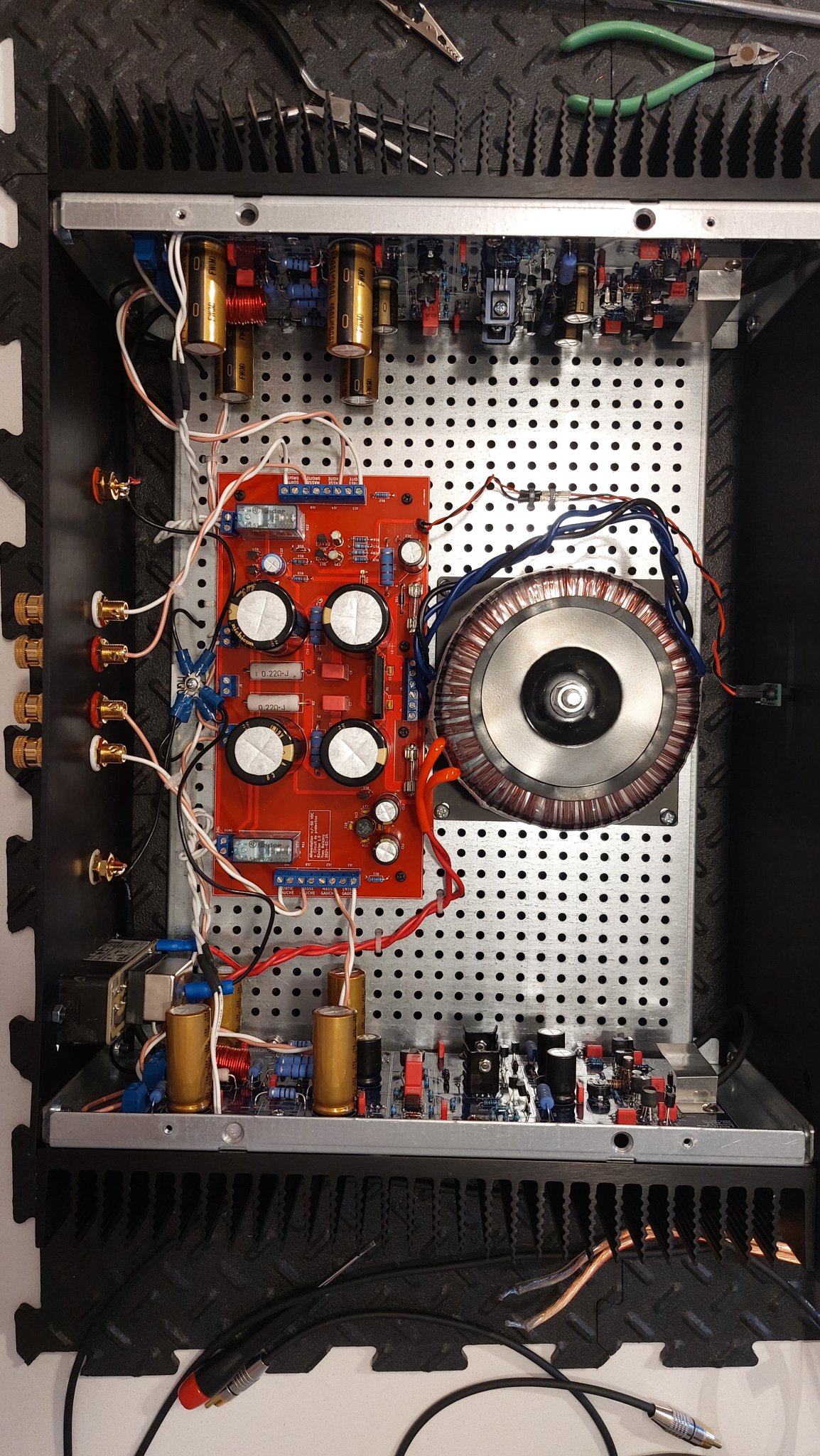

I just redo the +50/0/-50 VDC cables from the Power Supply to the Amplifiers boards. This time by twisting the three cables together. This upgrade make me realized that the 12mm M3 screw that was keeping all the GND lugs to the HQG Hex Standoff was to long. When I screw it until it reach the end of the Standoff hole, the lugs were still loose!
So I replaced the screw with a 8mm M3. They are now tighten.
With nothing at the Inputs, both channel are totally quiet.
With a RCA loop cable, both channel have very very low noise, each channel at the same level. I really need to get my hear near the tweeter to hear the noise.
With the Pre-Amplifier gears connected, same as with the RCA loop, but a tiny louder, still much lower than before this upgrade.

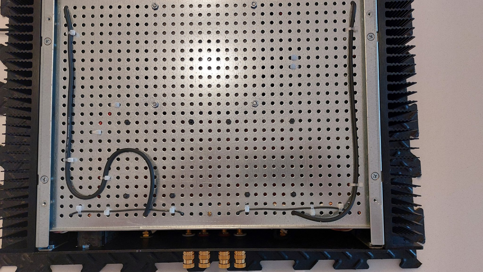

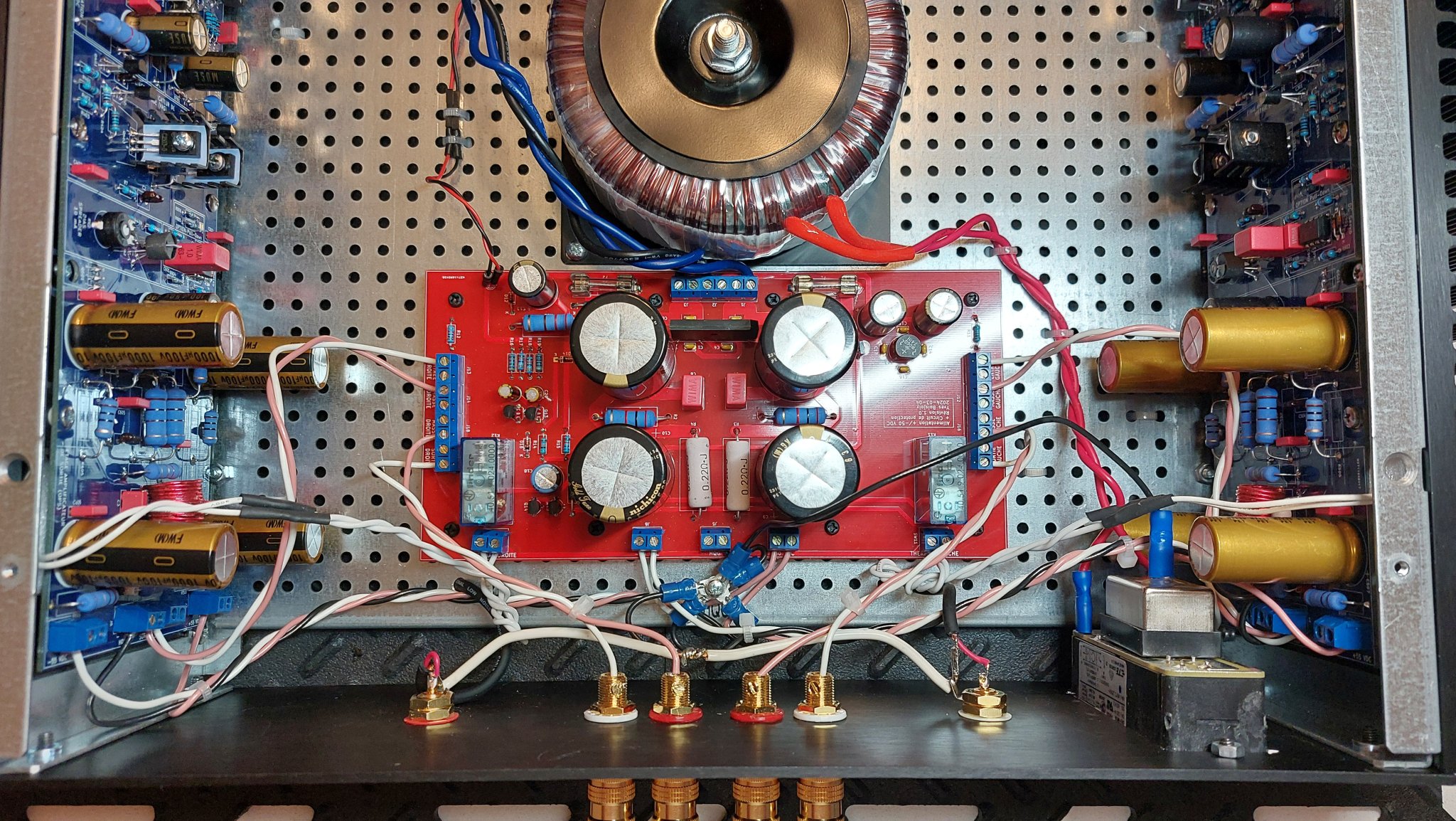

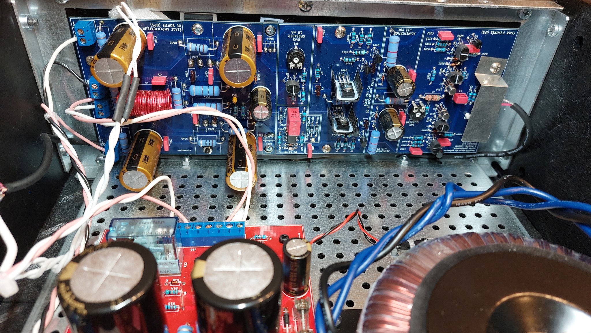

Well, I reverted my wires path to the same as post #44. It was the best setup vs noise I got since the beginning. I kept the left wire under the grid aluminum panel until it reach the PCB in order to minimize the AC plug induction, then past it along the PCB between it and the heat-sink.
I got very close results as post #44. Silent with no Input, a very low noise this time with the RCA loop cable, but practically unperceptive. Same practically unperceptive noise on the right channel with the pre-amplifier gears connected, while a very acceptable noise on the left channel. This channel is always the one who must past close to the AC plug. I guest this AC plug is to close to the left side of the panel. Of course one radical solution would be to redo the rear panel to cis-convert this.
