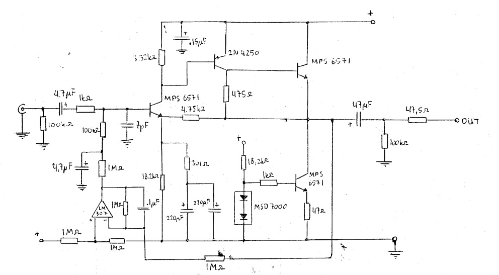

Hello.I am building the NS10 preamp based on this schematic.
For MPS6571 i am gona use MPSA18 as suggested but what should i use in place of 2N4250?
I have bC550C-560C,2N5401-5551,2SC2240-2SA970.
If i want to have lower gain can i use 680ohm feedback resistor instead of 301ohm?
What about the 1K resistor between 2N4250 collector and MPS6571 base shown on some other schematics?Should i use this resistor or not?
