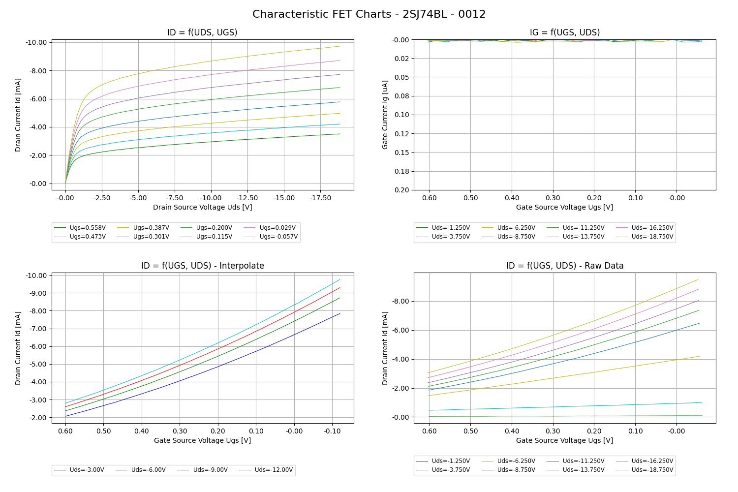

I measure everything before soldering it in. A good Curve Tracer is a must!
Attachment fake 2SJ74BL and 2SK170BL. The 2SK170BLs are not sooo bad but the 2SJ74BLs are mediocre…
P.S. Recorded with U. Borgmanns Kennlinienschreiber.

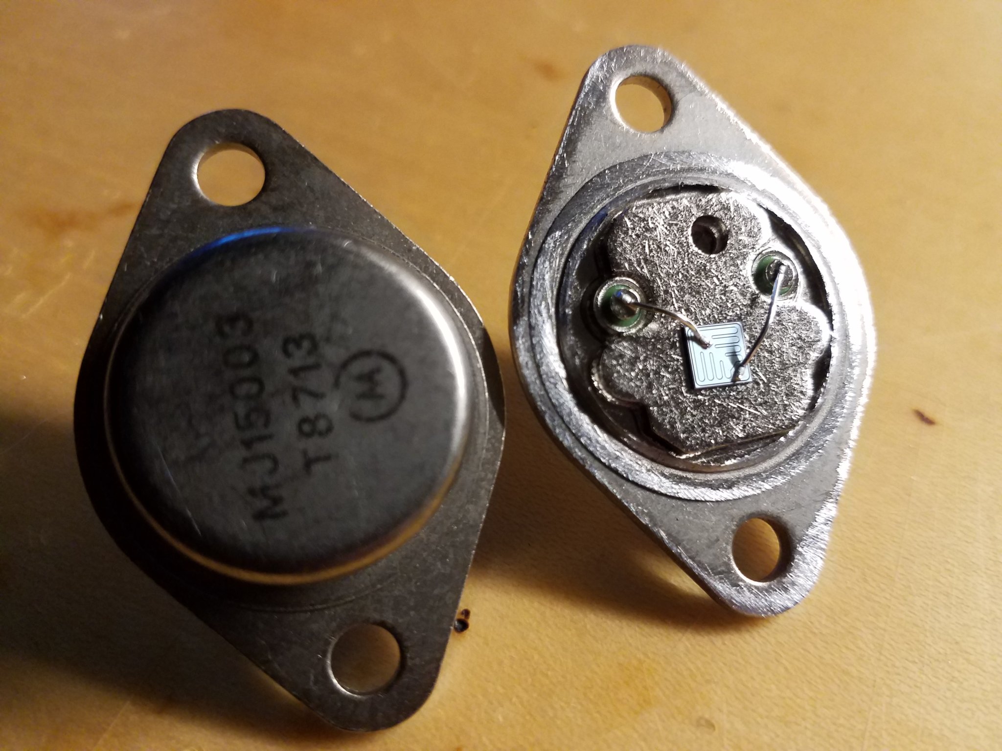

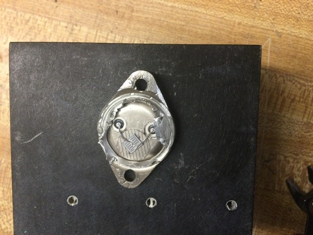

Those are not Motorola MJ15003’s. MJ15003’s look like this inside - An old aluminum 2N5631, which was the 2N version of the (at the time) Motorola house number MJ15003. Same thing, really, with routine process improvement and screened to different spec. The leads were chopped off these, so they were “expendable”.
The case you have is not anything Motorola ever used. Looks Russian. The die is a solid 200 watt type, and may in fact be comparable (only testing will tell you). Whatever they are, they are re-marked.
