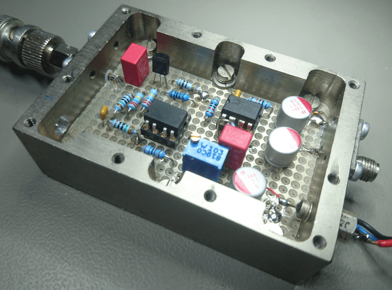

The box is ordinary microwave stuff; it would be costly only if milled
just for the dimensions I want. But I can cut the vector board for the
boxes that I have. The circuit on the vector board is not exactly a
work of art. Just good GND distribution on the top side.
A good source for the milled boxes are wideband microwave
electronis from ALI. Just remove the innards.
I have not done that, but I have just cut an Anritsu 10 GHz
bit error checker to pieces. ( 10G generator missing, and error checker
in unknown state.)
It was filled with milled soap boxes and SMA cables. Most SMAs
were not SMA but PC3.5. Much too precious for audio, but I don't
question that some people here would attest much better bass.
Gerhard
