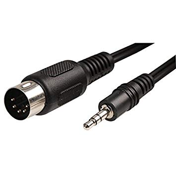

If you google Philips 544, you will find out these are powered speakers. They have DIN signal IN, and OUT. You need to provide a sound source and connect it to signal IN. A smart phone could be connected to it with this cable. How does the other box look like from the connection point of view?

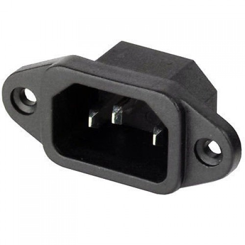

Thanks for the quick reply! I figured out the DIN connections mainly because DIN is still around. Main problem is the power-plug labeled 5 in the second picture.If you google Philips 544, you will find out these are powered speakers. They have DIN signal IN, and OUT. You need to provide a sound source and connect it to signal IN. A smart phone could be connected to it with this cable. How does the other box look like from the connection point of view?

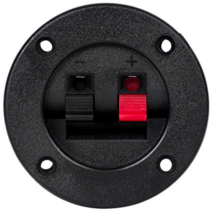

And the speaker-connector labeled 4 in the first picture

The power is a standard IEC power connector, made in the millions and on just about all pro equipment and some home gear. Computers use it too. Looks like an non-grounded version which is not a problem.
I can't remember the name of this speaker connectors, but they used to be super common. Maybe try ebay. There were never very good, by the way.
EDIT: It's called a 2 pin DIN speaker plug. Amazon has them here in the USA, so should be no problem in Europe.
