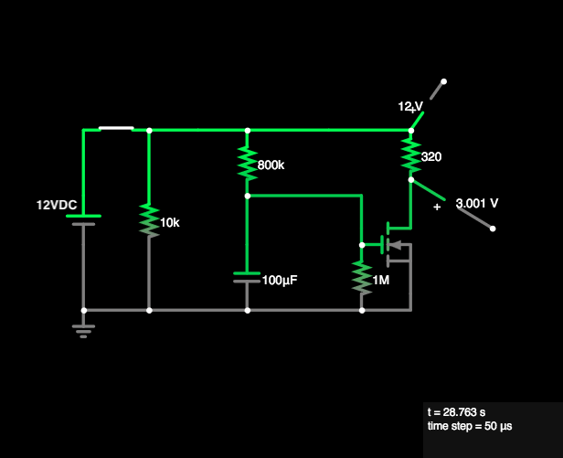

I'm thinking of something like this to short an inrush limit resistor on the B+. (The 'Must operate" voltage of the 320Ω relay is 9V , hence the 12V-3V difference at the stop time around 29 seconds. Total circuit draw is just over 30mA)

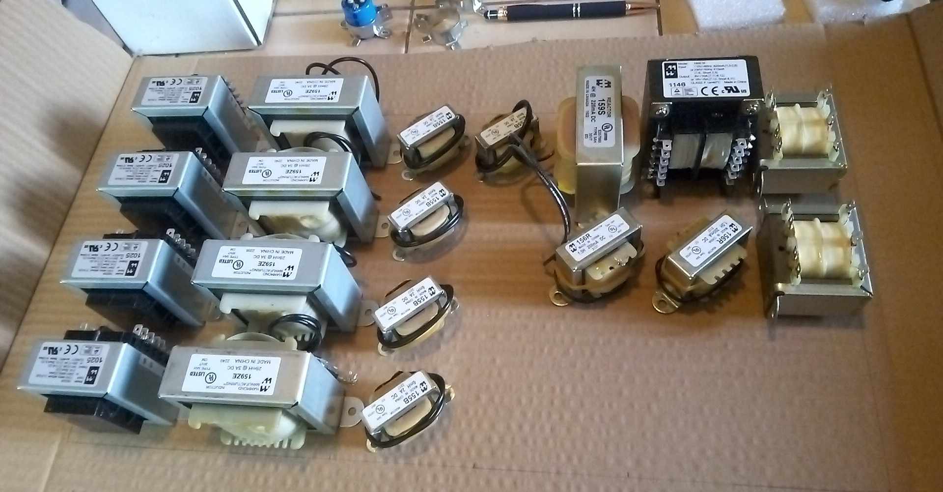

I have some Qs about filament transformers. First a little background:
A page or two back in this thread I mentioned that I'm collecting parts for a 6S4S (6B4G) SET. After auditioning some amps that I already have I changed my mind to PP instead and ordered new output and interstage transformers from Lundahl (LL1682 and LL1660S).
I'm obviously gonna need two more filament regulators too.
The surprisingly problematic part to find is good transformers for the raw DC supplies. Ideally, that would be four separate split bobbin EI transformers.
Turns out such transformers are neither easy to find nor cheap, at least not in my country.
As far as I can understand from reading this thread, fixed bias PP with the cathodes connected to ground through low R current sensing resistors should be one of the more forgiving topologies when using non-optimal filament transformers?
Using this Lundahl power transformer with 8 x6,6V 3V windings (series connected in pairs and and used with LC input filters) would be both cheaper and more convenient than buying, for example, four Hammond EI transformers: https://www.lundahltransformers.com/wp-content/uploads/datasheets/2738.pdf
Though, Lundahl's C-core transformers are more or less the opposite of the split bobbin EI-core design that we want here.
Yes, that's right. The PP sides should cancel any 50Hz noise well enough.
The reason for suggesting split-bobbin transformers is simply that they have low PRI→SEC leakage capacitance.
for example: A good 50VA split-bobbin might only have 50 .. 75pF of leakage; and at 230V line voltage, the 50Hz leakge current is usually <10µA. This current flows in part of the filament, and in any cathode resistor or bypass capacitor, back to safety earth (PE). The current is common-mode, and there are no (practical) filters that can help, and the type of regulator used make no difference to CM current.
The LL278 solution, used with choke-input should work; it may be worth asking about the PRI→SEC leakage capacitance (please report it here, if you do!).
Indel transformers are good. I list Hammond part numbers in the manual, because the availability is stable, and most countries have a reseller. Many industrial cities have transformer-making factories, and can supply split-bobbin PTs; it's always worth looking a web-search, asking about custom builds.
Thanks for your replies, Rod and Euro21.
TME does ship to Sweden and I have taken a good look at Indels EI transformers. They have a few models that would suit my needs but I must say their core clamp assembly look a bit, well, cheap and they don't seem to be impregnated with varnish? The buzzing from vibrating power transformers is one of the worst aspects of this hobby IMO.
I guess the best option would be to work a little overtime and then order a complete set of Hammond EIs and chokes from Tube Town or Don Audio. Until then I'm aiming at getting a prototype up an running with an old Tektronix PT that has all the HT and filament windings I need for the whole amp.

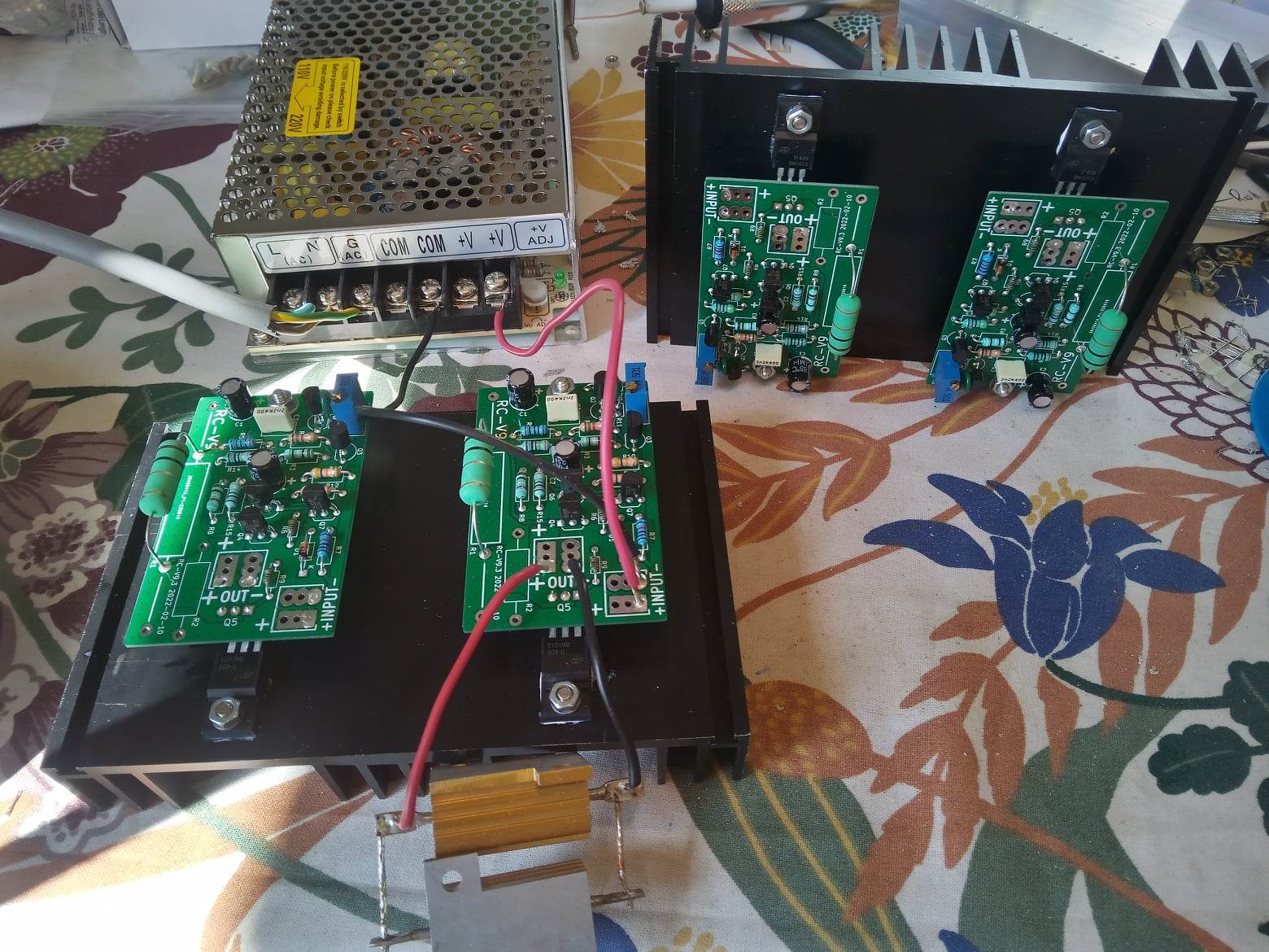

Believe it or not, but all six of my regulators worked at first try and four of them are even in a good enough condition to be used in my 6C4C PP amp. The remaining two can still be used for SE experiments. Assembling thru-plated PCBs turned out to be a bit of a challenge for someone who almost exclusively builds point to point stuffo_O

Thanks! I used a soldering station with a very small tip so I can't blame the gear, it was just my clumsiness and lack of skills that made the whole project a much bigger mess than it should have been. A lesson learned, and after all all of them are operational although the two spare boards are not very pretty.
Now I'm waiting for the transformers and chokes, they should arrive from the Netherlands any day now.
