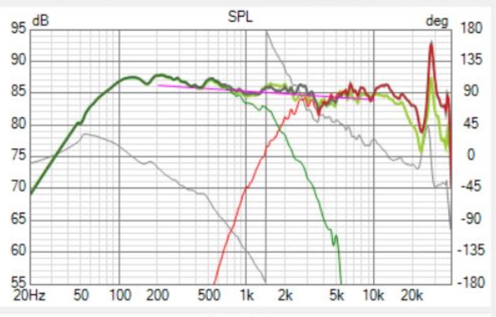

Yes, I thought it was very nice too. There is a lack of 8" plus 1" designs for the diy people and SEAS seem to have done a better crossover (with a 2.2kHz cross) than their usual slightly simplistic designs.
I recall @Pano did something like this some years back. He liked it. Maybe with a SEAS CA22RNX. Can't remember.
https://www.seas.no/index.php?optio...2rnx&catid=44:utv-prestige-woofers&Itemid=238
Must sim it!

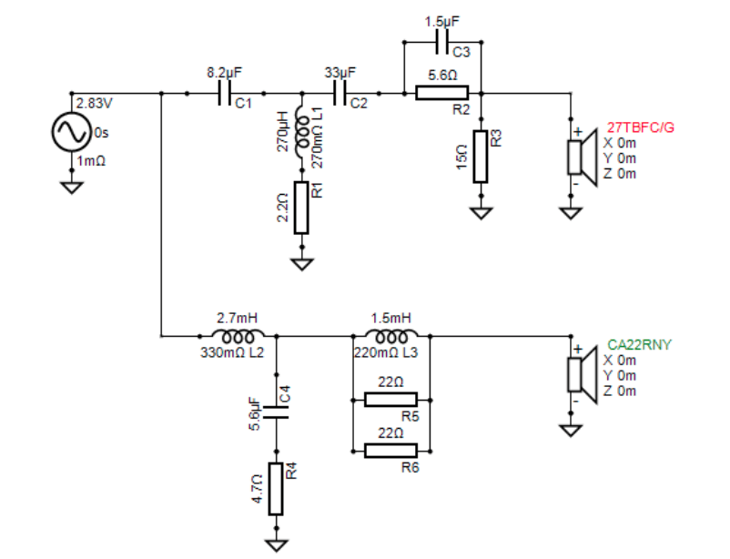

Why the crossover of this design Aphel is so complicated when you can do the same or better with much less components ? I am a fool who miss something ?
Thanks to SEAS to share the data. I would like to have an achenoic chamber too to make same measurements.
Reactions: 1 users
You can make a lot of different filter who sound good.
This original Seas filter sounds very good and for DIY’ers who dont simulate and make own crossovers a complete kit instruction like this makes it very easy to make a high quality speaker whitout special knowledge.

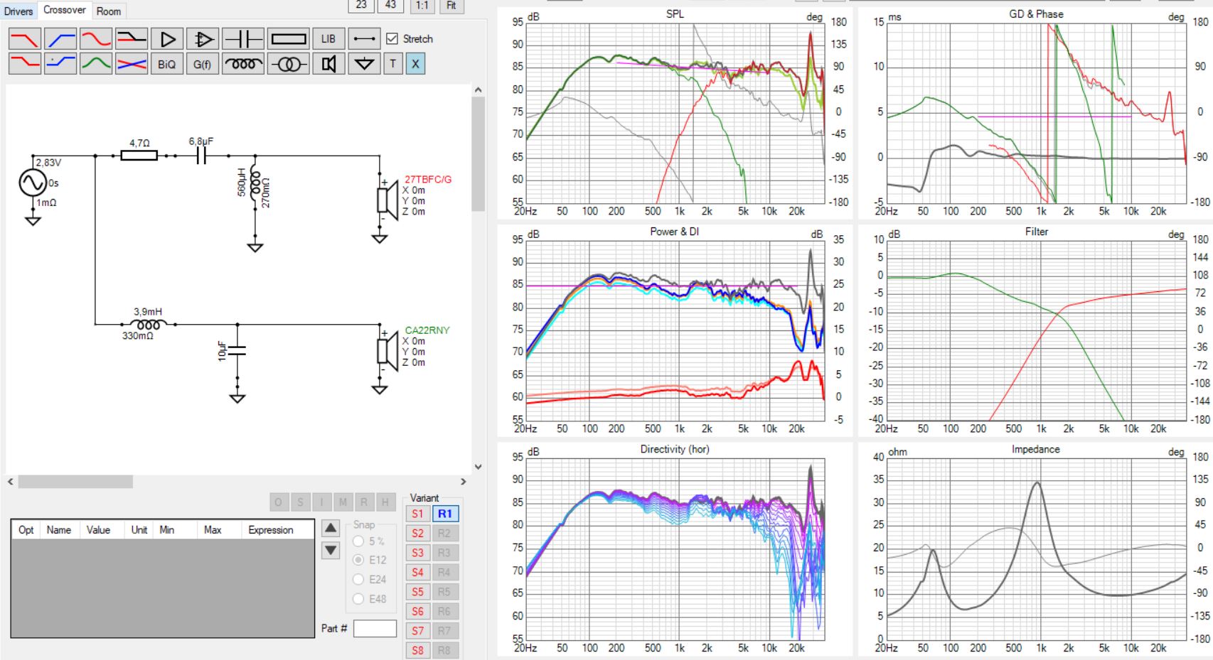

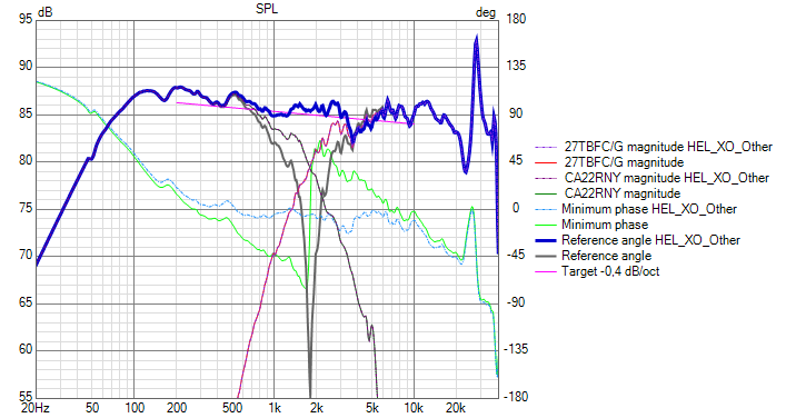

@jerome69
If you look at your response compared with the Seas filter, the latter has a little more even respons around the crossover region and a little lift around 10K. I think it is much effort here to fine tune the respons. And i have heard the filter and it sounds very good 👍
That said, you just have to test which you like best as i mentioned previous. Nice work you did with simulations btw 😊
Thank you !
Yes I am agree the response of the SEAS crossover is more uniform above 1KHz but mine has +1dB more sensitivity (less resistance on the woofer but could change the box tuning) and a better phase tracking. The least but not last less component, for a lower the price of the crossover. And yes mine needs some fine tuning and extensive listening.
Sure the SEAS crossover sounds good, not is the object of my astonishment ;) but for me, used to design 8"+1", this crossover is curious. And honestly if I put more components I'd go to a four order electrical crossover on the tweeter, a better time alignment with the woofer but it is an other story :)
