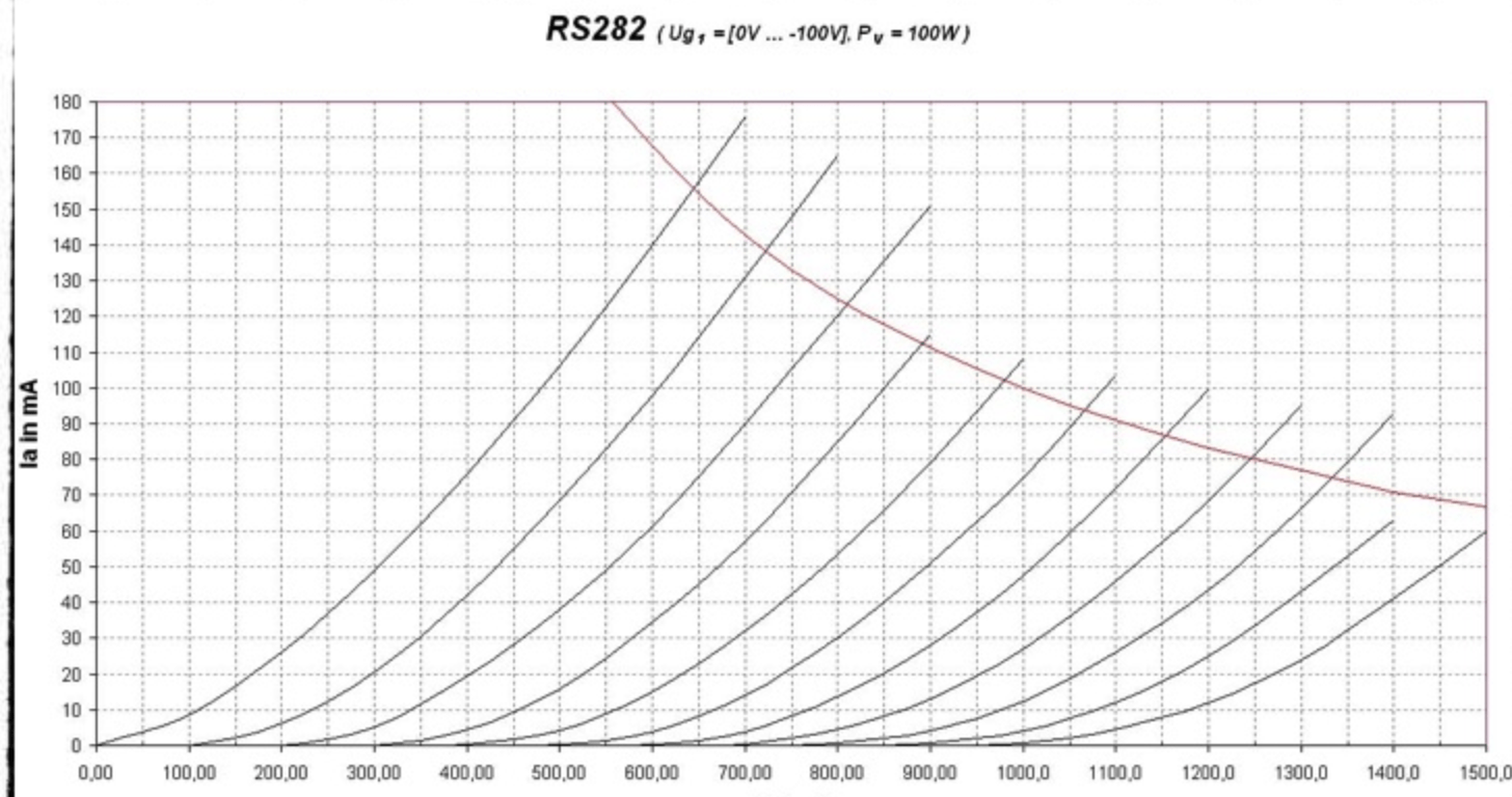

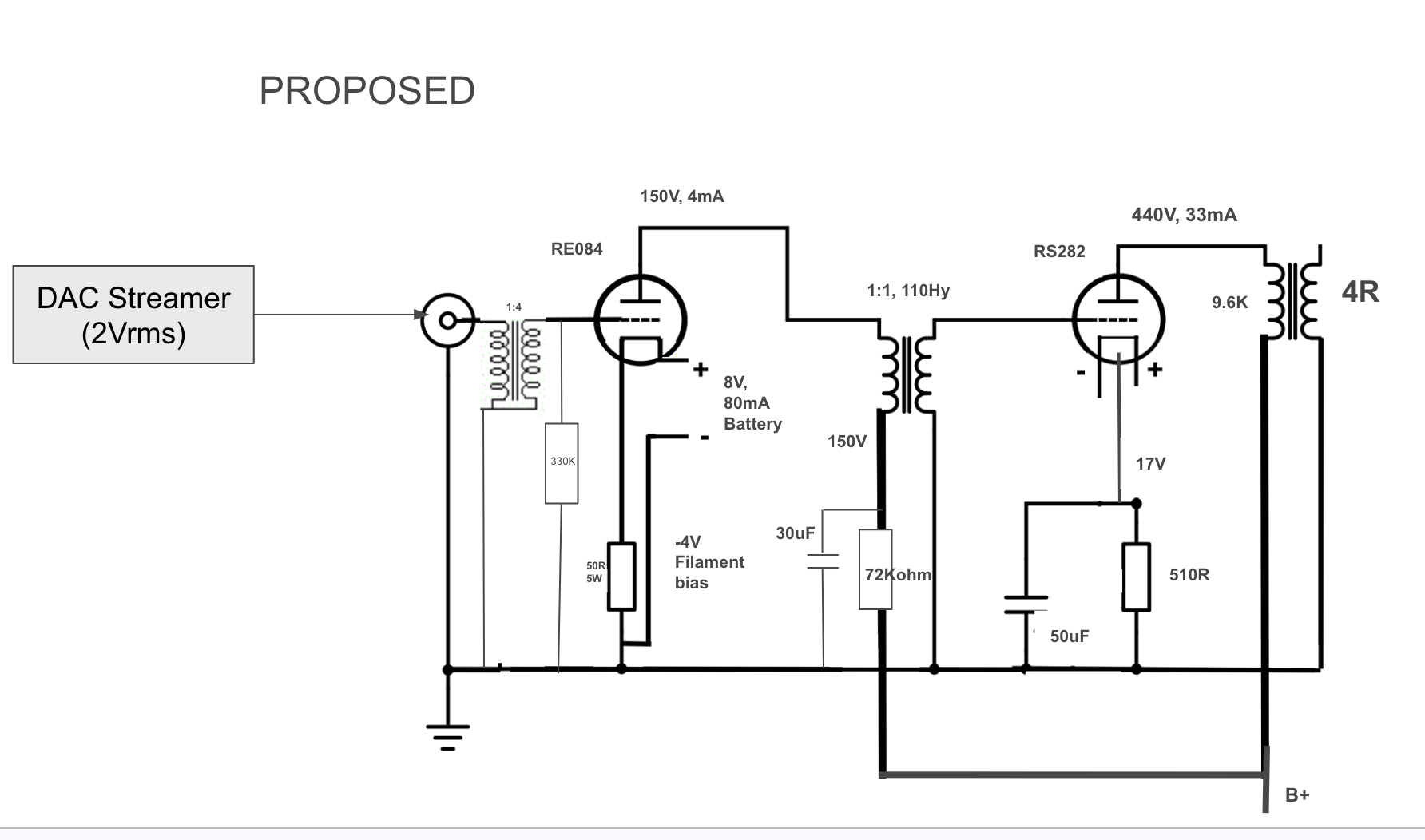

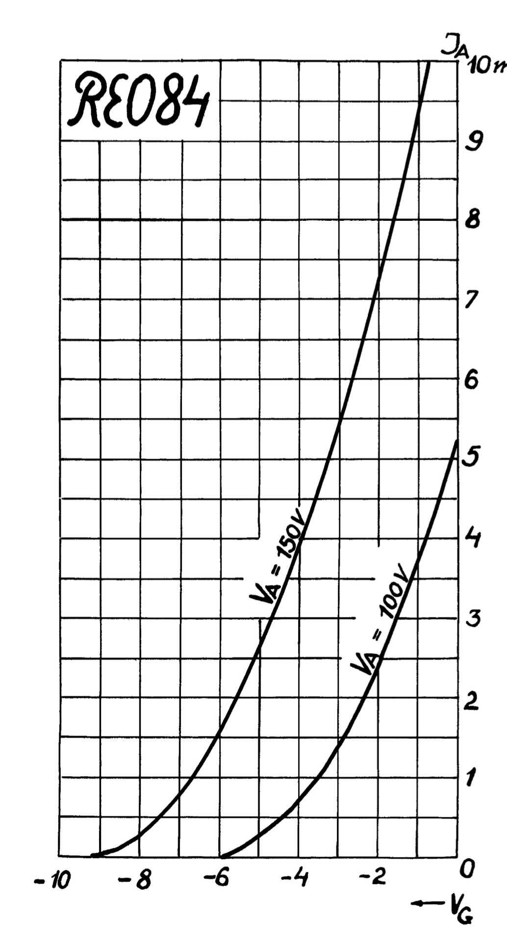

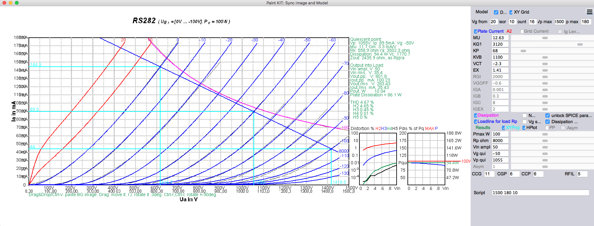

Hi everyone, I am pursuing a new pair of monoblocks. RE084 driving an RS282. Would like your thoughts on the design. I borrowed the operating points RE084 from Ale and the RS282 from RobDHT.
My main concern is if the RE084 will have enough swing to drive the RS282 to full output. My goal is to get 10-15 watts of clean class A using my DAC streamer as source (2Vrms). So, any thoughts on this would be appreciated. I have attached the schematic, curves and data sheets for each tube.
Thanks!
Pat

You cannot get 10-15W output power if the power tube is only dissipating 15W. In your schematics you will get some 3.5W. Need higher anode voltage and current for the rs282. It doesn't look like an efficient tube in Class A SE, so you will need at about 900V/50mA to get about 10W and about 1.1KV/60mA for 15W.
The RE084 is ok in your schematics but is on the weak side for 10-15W amp, IMHO.
If you are worried that your resistor may be too big, just use a resistor divider.
If my math is right, a 7.5K resistor at the bottom of the resistor divider and a 27K resistor at the top of the divider will get you down to 150v at the junction. Best part is that you don't have to add in a 500K bleed down resistor for the cap.
With that setup you will have 24ma running through the upper resistor and 20ma running through the lower resistor. You will need to make sure your power supply can handle the additional 20ma of current and you will need a very beefy 27K ohm resistor.

Thanks 45. B+ can be modified to 800V, the only downside is that this is a shared power supply and thus a large resistor will be needed to bring 800V down to 150V. Do you believe that this large resistor will cause adverse impact to transient response? Dynamics?
Check out the specs of the resistors you use and see the max voltage drop they can safely take. Generally speaking 500-650V drop is too much for 1 resistor. If want to do it with one RC you will need "special" resistors. But you can do multiple RC's for better filtering plus one resistor to ground to discharge the caps when switch off. No need to run large current for 4 mA into the RE084. Can run 5 mA in total and do 3 RC's with 43K +30uF and then 150K to ground. Power dissipation into the each 43K will be just over 1W and 0.15W into the the 150K. So can use 5W resistors for the 43K and 1W for the 150K.
With 800V, if you bias at 40mA you will get about 7W. That's about the max you can get with 9.6K transformer.
RS282 has very high Ri
from the datas:
S=5.5mA/V, u=12.5
Ri=u/S=12.5/0.0055(A/V)=2273 ohm
It is very difficult to prepare a good output transformer...
Has to be very high primary inductance in [Hy], probably more than 100Hy,
for decent bass response. :(
Also check the same thing for RS084
S=2mA/V, u=16
Ri=u/S=16/0.002(A/V)=8000 ohm
calculate OT values from this, also needs more Hy, probably more than 100Hy You already have for interstage?
for the input od 2Vrms, it is 5.65Vp-p
After that You have 1:4 step-up transformer that will be around 4 x 5.65Vp-p=22.6Vp-p
At the input of RS084 tube! And tube is biased to 4V, so the 8Vp-p is some max value not to overload the input tube...
after the 1st stage of RS084 and 1:1 trafo this 22Vp-p will be additionally amplified (mju=16 of RS084)
it will be huge signal to input of RS242...
And RS282 is biased with 17V = abs(-Ug), around 2 x17V=34Vp-p is something that is max for not to go into positive grid bias on RS242...
this is the huge overload and input volume will be always at the minimum...
Also check for the dynamic capacitances for RS242 to detemine is the driver output impedance is strong enough to drive this?
Calculate from datas in PDF
There are more things but these are main,
in general design is not good, please dont take it personally. :(

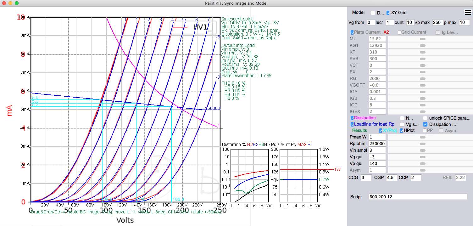

The main problem why it is not good about RE084 is too high voltage on the inut.
RE084 is limited to max anode voltage of Va=150V
Anode voltage is potential between Anode and cathode only.
For these type of tubes Va should be around 140V or less.
in that region values of -Ug are to about -3V
For about 5-6mA anode current.
So the total input should be less 6Vp-p.
You will have with max signal 4 x 5.65Vp-p=22.6Vp-p with 1:4 input transformer.

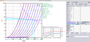

I made Spice model with Bartola mu tracer measurements of RE084 specimen.
Please take a look.
I put 250K as load line of L load or Gyrator emulation.
You have more precise Ri and other datas on the fraph.
There is a spice model too.

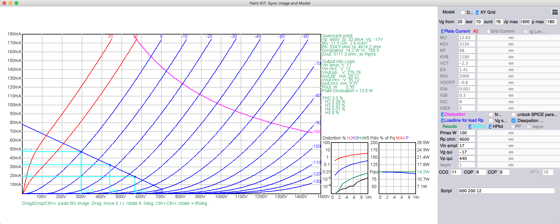

I think that Your RS282 settings are say, wrong
The output power is just 1W.
Tube operate in low voltage and low current region.
There is no point to employ that big tube just for 1W
Ri in that working point is 3.5K
that is huge and needs probably more than 100Hy for primary OT
Again very high voltage at the input from input stage.
34Vp-p for that setting is max for not to go into the positive grid bias range...
You will have, again, huge overload to the input of RS282 caused mostly by 1:4 input stepup transfrmer
Should be 1:1
See the RE084 has mju=15.8
RS282 spice models are in zip file
one for DHT composite model other for standard triode

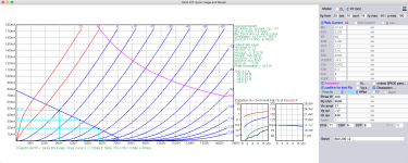

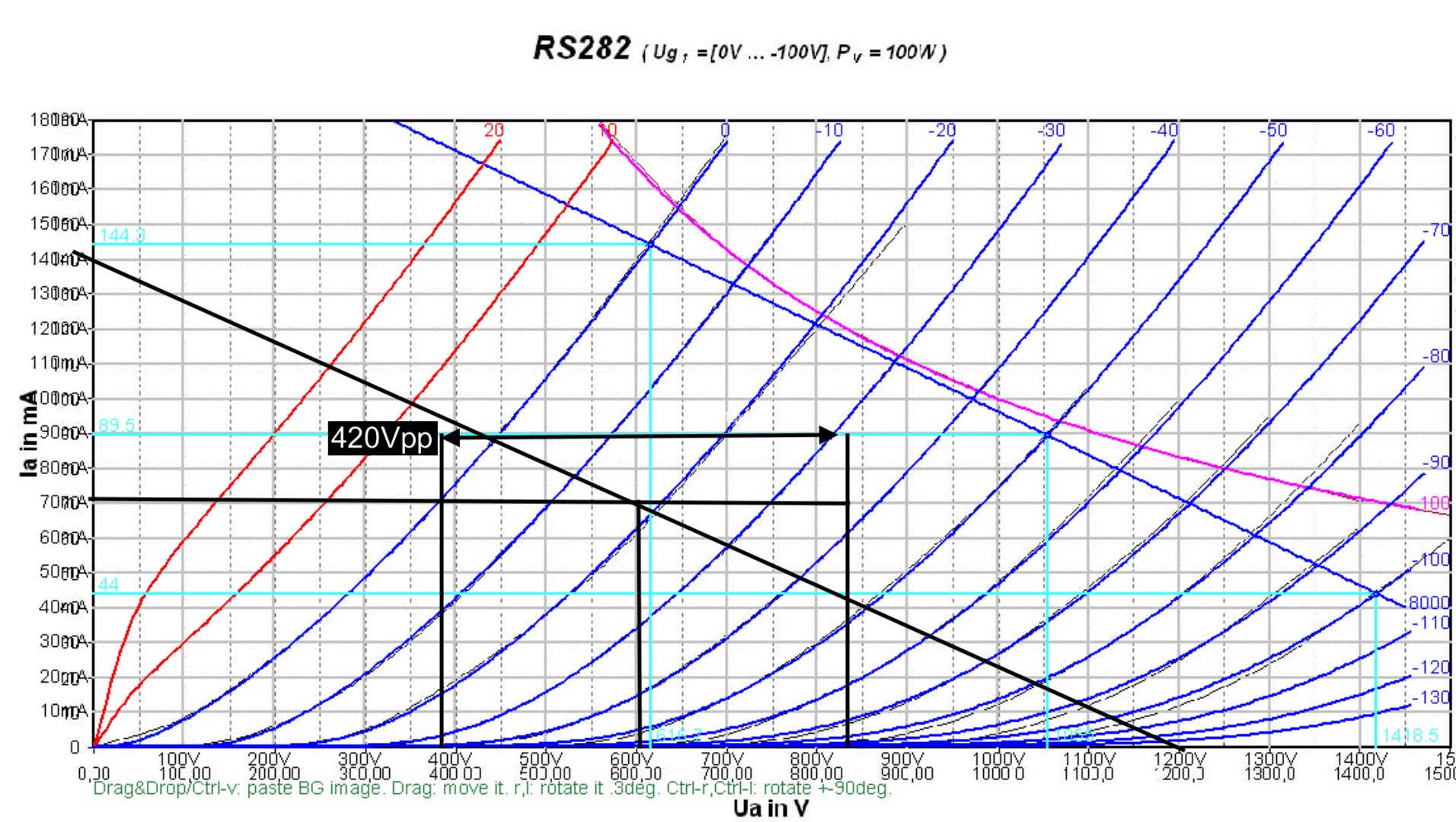

Zoran - thank you for the input. Please do me a favor and run the spice model for the RS282 with the following operating points: -18V bias, 610V @ 90mA. I am curious to learn the output of the spice model. Looking at the curves below, this allows us to use the RE084 and input transformer (4*5.6=22Vpp) with minimal overload of the RS282. Not perfect, but getting better. This would swing the RS282 to have ~420Vpp.

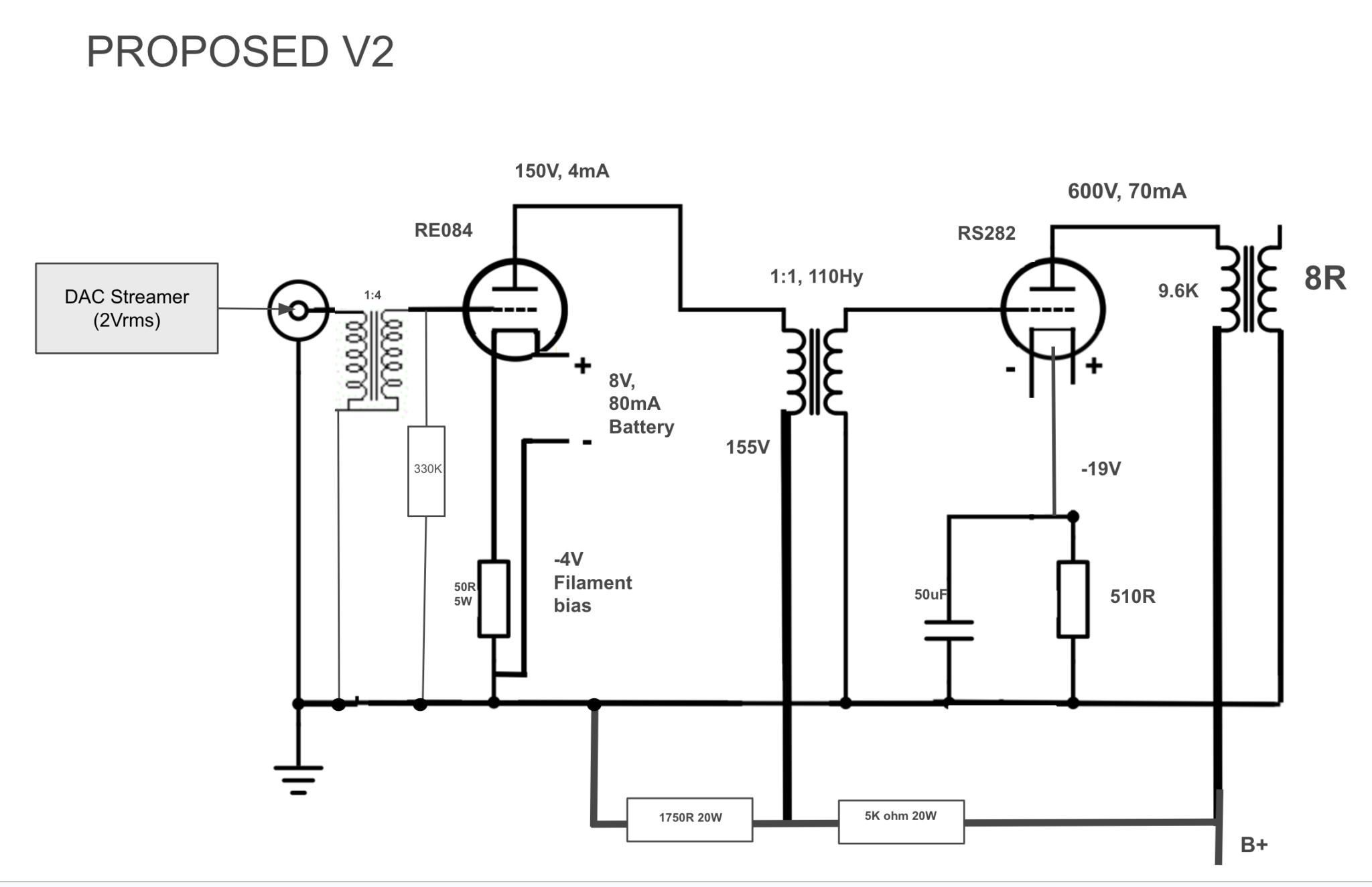

Here is the 2nd version of the schematic (see below) based upon input from everyone.
1. I have some 5K and 1750 ohm 20W resistors to create the voltage divider with a 600V B+. This gives 155R for the driver plate voltage. Is a cap necessary on the voltage divider?
In speaking with Alexander at Muse Coils regarding the interstage tranny, he said that the IT will be fine for my proposed schematic.
The new schematic has the RS282 output tube running at 600V 70ma -18Vbias and a swing of 420Vpp.
Thoughts?

Hi
I will check power tube.
but input section is first issue...
1.
The RE084 cant stand more than Va=150V
In that area -Ug is optimum to be -3 to -3.5V
for Ia=5mA cca.
I will simulate this.
This is important because RE084 is sensitive t exceding max value Ua.
And to keep the total Po less than 1W max
to give the chace to RE084 for longer life.
And still to remain in linear region.
2.
So L load is the goal for higher Amplificaton factor.
In these working conditions RE084 wil output
3.
BUT the tube has huge internal resistance of about 8750 ohms
that deserves minimum 250Hy of inductance to keep the phase shift in LF at acceptable level.
These 110Hy is too low and the guy is wrong when said "it will be OK". How can it tell without calculations and simulation with ral parameters?
4.
2Vrms = 5.6568Vp-p
more of digital sources has even more output voltage. Like they comepete to have more and more output inspired of that preamplifiers existing in the system...
With say -Ug = 3.5V that is max half period of input sygnal.
You will have 5.6568 Vp-p / 2 = 2.8284 Vp at the input of RE084. That is safe and under value of -Ug of -3.5V
(with -Ug=3V 2.83 Vp will be too close to the -Ug = 0 in + period...)
WITHOUT 1:4 INPUT TRANSFORMER
thet is good because You will stay in the good range and value of input...
With 1:4 input transformer You will have 4 times bigger value of half period of input 4 x 2.8284 Vp = 11.3V
and that is kill to the -Ug = 3.5V of max input half period...
5.
You dont need the 1:4 step up transformer. Cut it out
OR exchange with 1:1 ratio.
But with proper values according to source and from quality...

RE084 will export about 92 Vp-p with input of 2.1Vrms.
(But only with L load, Gyrator load and transformer used as L load with high R on secondary in range of 250K like I did it on anode curves diagram for RE084)
Half of that value is mnimum for the -Ug = for RS282 tube
and that is -Ug = 41V
To have more "room" it is better to put -Ug = 45V for RS242 with RE084.
Now You have more proper one factor parameter for setting the RS842.
Withe that, Va of RS242 is a bit more than 900V and for optimizing the tube life
the Ia can be set to 60-70 mA range...
7.
110Hy is not enough for Ri = 8750 ohms
Minimum is 250Hy with small capacitance... Which is obtainable...
And these high Ri maybe could not drive RS282 properly?
Maybe You will need some cathode follower...
8.
Minimum Lp for the RS282 tube is 80Hy
