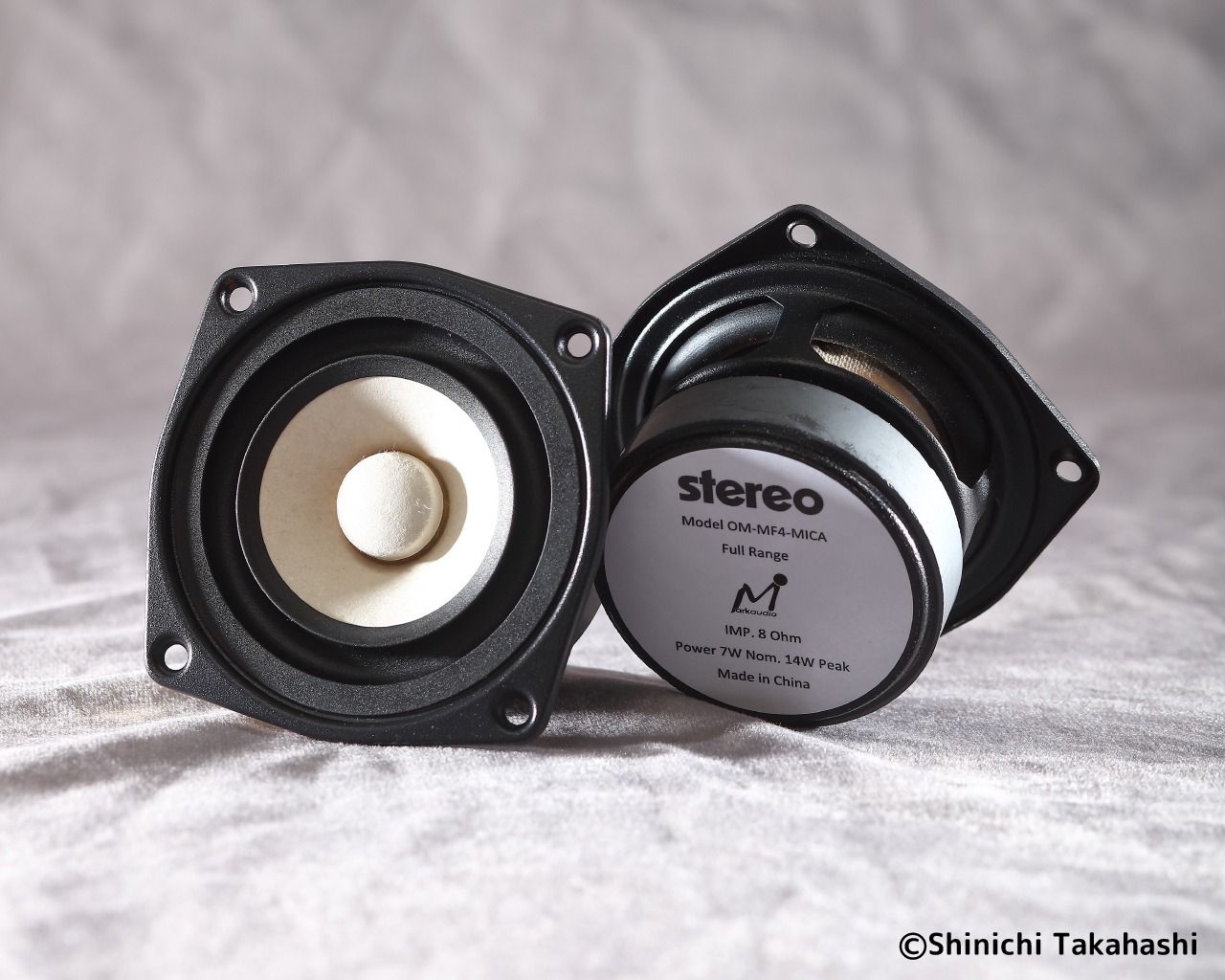

CHN-40 is a relative of OM-MF4, a driver originally produced for some sort of project build that I don't understand, but I can tell you that the keywords you need to Google for it are "Stereo Magazine" and "Ontomo Mook 2020". Perhaps somebody familiar with these things can tell us what that is!
I bring this up because CHN-40P would thus be the general-release version of OM-MF4-MICA, which I think has a similar heritage but for the 2022 version. In that case it'd look something like the image below. The reason I say "would be" is that I don't recall seeing CHN-40P announced anywhere, so until I see a photo I'm not totally convinced it exists.
