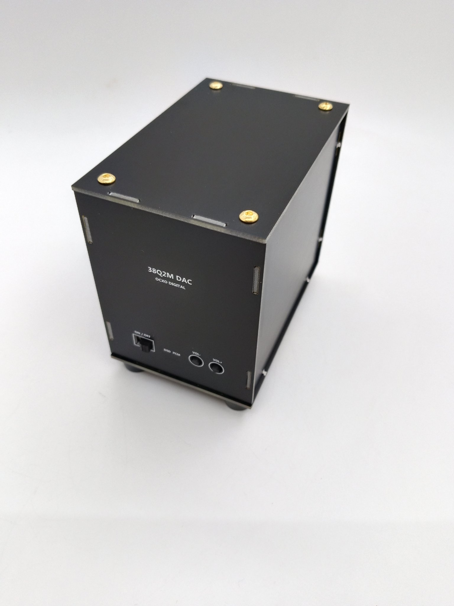

OCXO ES9038Q2M
This 38Q2M DAC use a ES9038Q2M , a OCXO with phase noise on 10HZ down to -108dBC/Hz ,much better than CCHD-950 or CCHD-575
4CH I/V , and 2CH LPF out

But I didn't understand why this oscillator phase noise is so important, if in async. mode, the final phase noise will be determined by the PLL, which is much worse than the oscillator phase noise.
Now it works in async,I2S directly input to ES9038Q2M
Doesn't matter.
In my designs I2S is also directly to ES9038, but DAC operates in sync. mode from low jitter oscillator.
Just from ESS's spdif input I put it to async.
Yes,the PLL jitter is very important when use async mode,if the MCLK frequency from i2s link is enough ,you can use sync mode,but many front end is 22.5792/24.576MHZ,are you using 45.1584/49.152MHZ ?
Just if must to use async , chose OCXO is better than XO
I2S input via HDMI link, the other way to work in SYNC mode , may use a SI5381 to lock on LRCLK in i2s link ,output MCLK 90.3168/98.304MHZ, and than need a good 54MHZ osc , to give a MCLK for ESS ,45.1584/49.152MHZ is no enough when DSD512

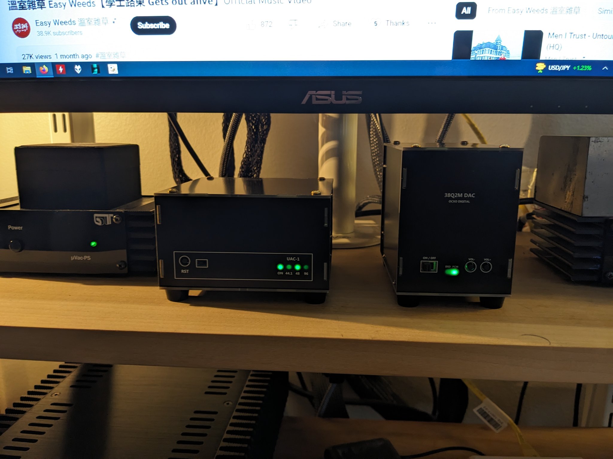

Hey. I am becoming a big fan of your products. Got your UAC1 and found it to be better than my other DDCs including Matrix and Singxer (disappointed that the one I got didn't have clock inputs). So, got curious about your dacs. I ordered one of your R2R dac but order was cancelled because you stopped production of it. Then, I ordered your cirrus logic dac but order was cancelled because you stopped production of it. I hate sabre chips but that's all you got now so forced to order this one. Turns out, it sounds lovely. Out of the 3 HDMI cables I have, I have to use the warmest sounding one to get the right balance of getting rid of any trace of the sabre's sound signature. Love your products and how they are DC powered, so it's easy to upgrade PSU.

I'm so glad to hear that you like it ,thans very much .
Not sure whether the ES9038Q2M dac has fully burned in or whether my ears have become accustomed to it, but it is sounding better now than when I originally posted. (Actually I am pretty sure it has improved as I like it more than some of my other previous favorite dacs now) I've switched back to the more neutral sounding HDMI cable and the sound still exhibits good balance of detail and smoothness. I've just ordered the SI384 w/ your -100db clock (via alix) as I am curious as how the sound will differ with this DAC. I do hope you'd make a R2R dac with i2s input again. I missed the boat on that one.
