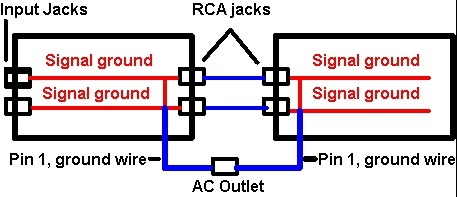

I don't know if this has been mentioned earlier, but when two components in a system have pin 1 connected to the wall socket, there
is a connection between the signal ground to both components. As such, musical information/signal current not only returns via both
left and right interconnect shields, but also through the pin 1 wires from component to component. This tends to mix the channels
together. There is all sorts of negative ramifications.
I have to admit that Jneutron first brought this forth about a decade ago. So simple yet profound and never mentioned.
cheers
pos
Very good point about grounding. Although I have specific DC returns and don't use ground return it's still a good illustration of how loops through ground (and ground lifting) can kill you.
Well, I am not really discussing grounding per se. (For public's convenience I will try to be as simple as possible.)
I am discussing two components, each with its own internal power supply, Not one component with two separate chassis.
Attached is a simple schematic for the public's convenience.
I am Not discussing grounding. I am discussing a third musical signal current path from one component directly to
another via the pin 1 AC power wires of each component. The other two signal paths are through the
ic shields.
The AC outlet itself is only mentioned/shown because the two pin 1 wires present physical connections with
resistance present at the plug outlet junction.
(Notice I left out any reference to ground itself as it does not enter the picture concerning the musical signal path.)
Notice the two RCA Jacks labeled on each component. There are 2 ics connected between the jacks, each ic with an
inner conductor and a shield conductor.
The shield conductor of each ic is connected to the red signal common ground, (It does not make any difference
which red is labeled L and R signal ground.)
Now notice the two blue pin 1 ground wires connecting the AC outlet to the red signal common ground wires in
each component. Besides the two shields of the ics, the pin 1 wires also carry musical signal current from component
to component.
So what is the ratio of return signal current through the two shields and pin 1 wires?
The ratio of return musical signal current through the three paths is determined by the dc resistance, inductance
of the two shields and pin 1 wires, the frequencies involved, the connection resistances, width of component internal
foils/wires, solder resistance etc So it is not simply parallel and equal.
So what is the result. The result is that the actual stereo frequency response, the spacial information, and other
characteristics of the reproduction is affected by the above characteristics mentioned in the previous paragraph.
Stereo separation is affected.
If it is possible, attempt to create as much channel separation as possible.
cheers
pos

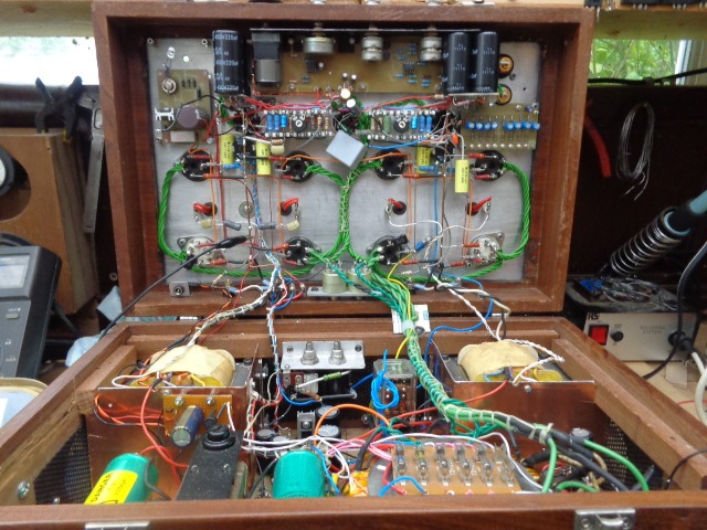

Cable lacing looks so much nicer than cable zip ties. I've used it I'm a couple of amps I've built.
The roll of stuff I got was from the British post office, likely used in telephone exchanges.
The roll of stuff I've got is waxed cotton.
There is a reason NASA still do it this way on the Mars rovers.
