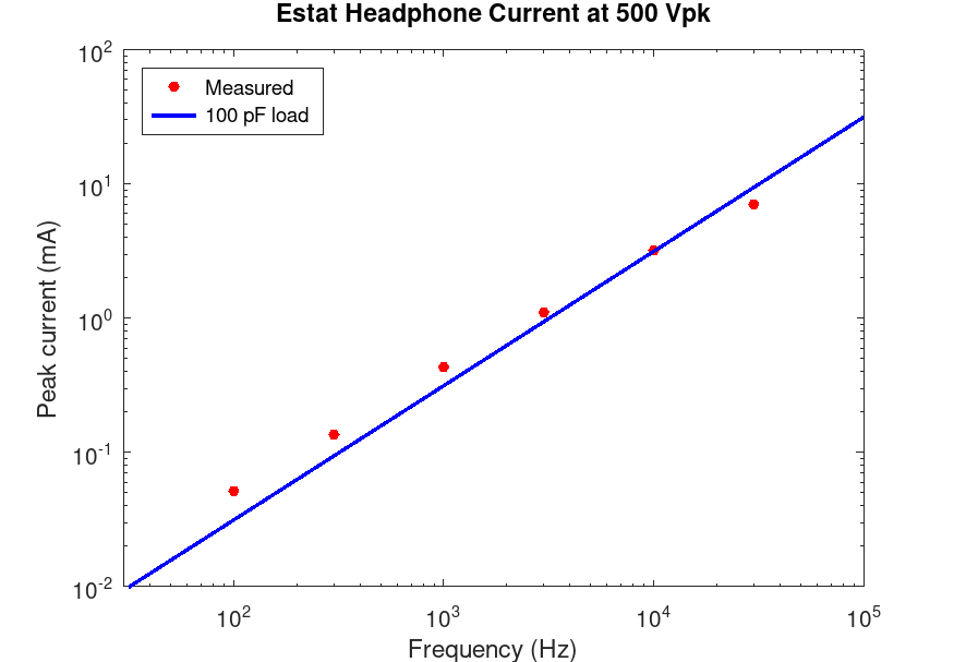

Joined 2005
If the estat is modelled as simple capacitor with a typical capacitance of C = 100 pF (that's surely not be the most accurate model of an estat!), the current ... Driving the capacitance with a sine signal at 500 Vpk, the peak current would be 6.2 mA at 20 kHz, 16 mA at 50 kHz, or 31 mA at 100 kHz. We may not need to drive the estats to full output at 100 kHz, and the power spectrum of music signals is typically quite a bit lower at treble frequencies.
How well does this super simple model work out? I made a few measurements using my Stax X9000 headphone. This figure shows that the model is surprisingly accurate:

Good stuff, thanks! The article seems to follow the same logic as my guesstimates in the previous posts, and then also confirms this using some SPICE simulations. The article also points out that typical music has relatively low high-frequency power, so there is some room for compromise on the max. current needed from the output stage.

Just to really convince myself I did another test to determine the output voltage/current needed from the amp.
I used my RTX6001 audio analyser as the audio source, a Stax SRM700T amp, and the Stax X9000 and Hifiman Shangri La Jr headphones. The Hifiman seems a bit less sensitive to my ears than the Stax, so I used to Hifiman for the numbers below.
  1. I played some well recorded music with a high dynamic range (see https://dr.loudness-war.info, used DR19 stuff and higher, mostly Steve Earle / Copperhead Road) with the output level at the RTX6001 was set to the 10 V range. Then I set the volume knob at the SRM700T as high as I would ever want it to be, at the point where my ears started to hurt. I think the amp was already distorting and clipping quite a bit. The volume knob was at position 6 (12 o clock).
  2. I left the SRM700T volume knob at this level and reduced the level at the RTX6001 to the 100 mV output level (100x lower) to prevent clipping the SRM700T output. Then I measured the peak-peak voltage at the SRM700T output with a scope. The highest value was 13 Vpp.
  3. Scaling this back to the very loud volume of step 1, the peak-to-peak voltage without clipping would have been 1300 Vpp.
Conclusion 1: a peak-to-peak output voltage of 1300 Vpp (650 Vpk) would be nice to have!
(It seems my previous guesstimate of 1000 Vpp was a bit too low.)
While I was at it, I also measured the peak current. I inserted a 1000 Ohm current sensing resistor in the output and measured the voltage drop across the resistor. The max. voltage observed at the 100 mV output level was 76 mVpp, which corresponds to 0.038 mA(pk). Scaling this back to the loud volume of step 1 (RTX6001 at 10 V output range), that's 3.8 mA. This is quite a bit lower that the 20 mA target, due to lower power of high/treble frequencies of real music (opposed to typical audio test signals).
Conclusion 2: the output swing target of 20 mA-peak is (much) more than enough for typical music signals!

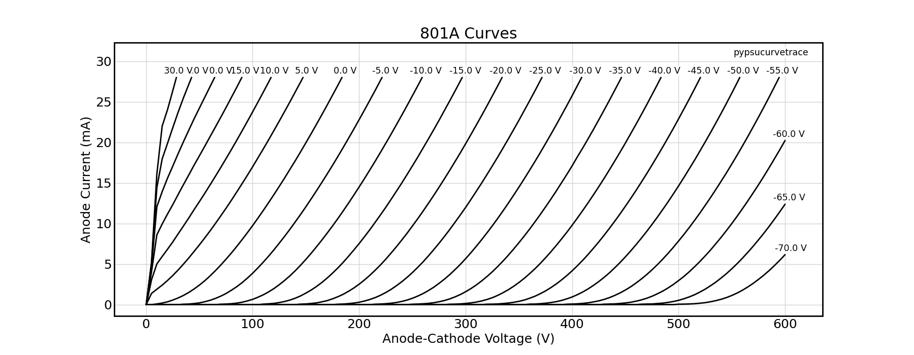

Which DHT tubes would be suitable for the output stage?
After some discussion over in the Tube/Valves Forum it looks like the 801 / 10Y / VT-25 tube family is the way to go.
A neat feature is that these tubes can work well even if the grid is driven positive (Class A2), provided the driver stage can supply the grid current. This allows biasing the tube at a slightly lower anode voltage as compared to the case where the grid voltage must always stay negative (A1). Taking advantage of this, the 10Y / VT-25 can swing +/- 325 Vpk with a 20 mA CCS load and a bias voltage of 440 VDC (curves attached), which is just within their specified limit. In A1, the anode bias would need to be 480 VDC or more, which is okay for the 801, but not for the 10Y / VT-25.

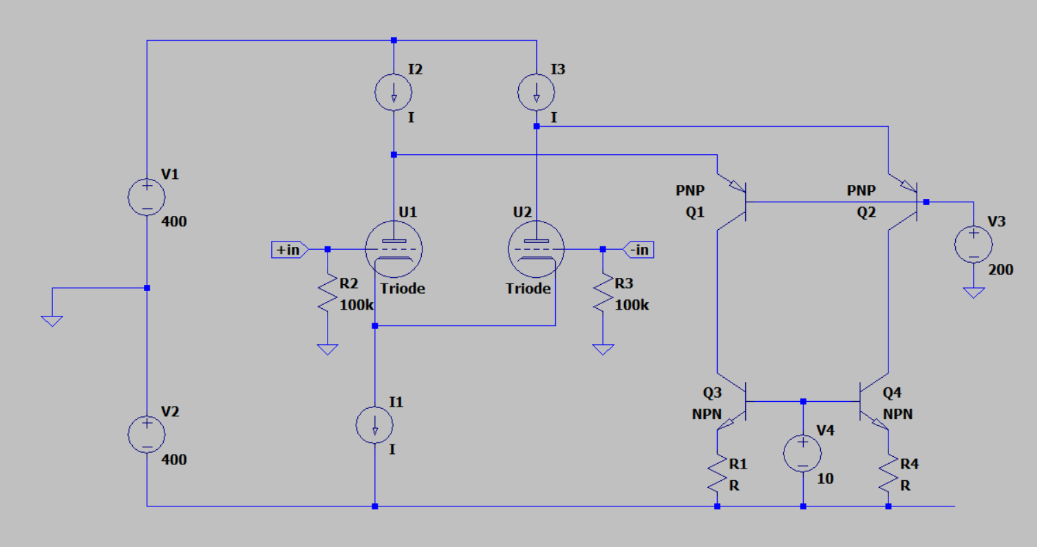

Here are some thoughts on the input/driver stage (following up from the list in the first post):
  • Differential amplification from balanced input. I like the long-tailed pair (LTP) for it's symmetry.
  • It would be awkward to dilute the DHT sound with a lot of open-loop gain from the input/driver and then apply gNFB. Not gNFB it is!
  • Voltage gain:
    Single-ended line level is 1.74 Vpk, so balanced input is 2 x 1.74 Vpk
    Each of the output-tube grids need to swing 44 Vpk for full output, so the input/driver needs to swing 2 x 44 Vpk Gain = 44/1.74 = 25.4
  • The grid current was < 1 mA at +5 V grid, 2 mA at +20 V, and 5 mA at +30 V in my curve measurements shown in the previous post. The drive the output stage into A2, the driver must be able to provide this amunt of grid current.
  • Thinking about it, I want some more tubes!
The LTP will need two tube units with sufficient gain. A dual triode like the ECC88/6DJ8 would be convenient, but I feel there are other types with better linearity. In particular, some triode-strapped pentodes are wonderfully linear, as shown by @mogliaa, Pete Millett and "Klausmobile" (here, here and here). Skimming through these data and descriptions, I believe the 6E5P would be a good candidate (very linear, mu is approximately 30). I have a box full of these tubes, so I'll look at them a bit closer.
The grids of the output tubes will be biased below the B- / -HV rails, so it would be rather complicated to DC couple the LTP input/driver stage to the output stage. Capacitor coupling works very well, especially if there is no substantial current flowing through the capacitor. Driving the output stage into A2 therefore needs a current buffer. A MOSFET source follower should do the trick.
A folded cascode would be customary in the Stax space. It also allows you to develop far more gain in a single stage. With no NFB, and so much gain, drift could be an issue as it will cause the output stage bias to drift in turn. It could be interesting to load the folded cascode with a gyrator or with a choke, DRD style. Here's an example with a differential current source load, but it will inevitably require a servo or some trimming. Here is the basic idea-- as drawn, it of course will not work.
In the DRD approach, the choke would replace Q3/Q4 and see only the imbalance DC and so would need a minimal gap, while doubling your available voltage swing. You will however need to run double the current with a folded cascode, which, when we're considering a 6E5P and high voltage rails, implies very significant dissipation.
The T2 uses a 700-ish volt shunt regulator (the "active battery") as a level shifter to couple the driver to the power stage. It would work, but it is sort of scary.
I've also built a Stax amp with an interstage transformer load on the output. The whole amp ran off of a single 580V B+, which also fed the bias. With the transformer OPT, it could swing close to double that. So, while it might seem costly, it saved the cost of an additional B- supply and made me feel a bit safer about putting that much voltage right up against my noggin. :)
I also thought about a folded cascode, and I see its advantages if very high open-loop gain is needed. The Stax amps use a lot of gNFB, so the cascode it almost mandatory there. Also, even with gNFB, the Stax amps tend to have a rather high input sensitivity, which means they need a lot of attenuation from a modern line-level source.
As I see it, all we need is a 25x voltage gain. What would be the advantage of a folded cascode compared to the standard anode follower in a long-tailed pair?
Post # 16 Schematic has a Very tricky set-up.
As you said, as drawn, it will not work.
But any drawing with current sources in the co-connected cathodes, and current sources in the plates, will be hard to manage.
1). I-one has to Exactly = ((I-two + I-three) - (Q1 current + Q2 current)).
If it does not, then the quiescent state will have some grid current.
Even if the Equality is met, then If one or more current sources change with temperature, or Q1 or Q2 current changes with temperature . . .
that is another problem.
2). Where is the signal output on that schematic?
3). It is late, I am tired and sleepy, I guess I am missing something on 1). and 2).
That's the charitable way of putting it. With the current sources in series, the only way it will work is if a resistor to ground (or v-) is inserted on the collectors of Q3/Q4, or if some sort of active circuitry adjusts one of the current sources to define the collector voltage. There are a few ways this could be done, but all of them would be complicated and sort of terrible given the limited availability of HV parts. The resistor is not a bad idea, given the modest gain requirement.
The + and - phase outputs are taken from the collectors of Q1/Q3 and Q2/Q4.
My apologies, I missed your gain requirement a few posts up. The big benefit to the folded cascode configuration that I see is that it would enable DC coupling if there's some means of stabilizing the output voltage (servo or gyrator perhaps). But these usually involve a cap and some gain, so perhaps the coupling cap is lesser evil.
I'm getting a bit hung up on the grid current requirement on the 801s-- it looks like the curves bunch up quite a bit around +30V on the grid with a 20mA constant current load. If you are looking to take it all the way there with a 44Vpk signal, that puts Va around 250V, which won't be sufficient to hit the 650Vpk design requirement. On the flip side, the 6E5P probably wants to run 15mA+, which would easily meet your grid current requirement were it not for blocking distortion from the coupling cap as you head into positive grid drive. It's also puts the driver stage's dissipation at a significant fraction of that of the output stage. I'd give some consideration to a lower current tube (E180F or EF184 in triode perhaps?) if it will be buffered.
My idea in post #15 was to not drive the 801 grids all the way to +30V. Instead, +5V should be about as much as it gets. To swing the anode voltage by +/- 325 Vpk at 20 mA, the Va bias needs to be 440 V.
I agree that driving the 801 grid into A2 through a coupling cap is asking for trouble. That's why I suggested using a MOSFET source follower as a current buffer to drive the grids. The MOSFET gate would be AC coupled to the input stage via a capacitor.
I suggested the 6E5P based on the measured performance I found on the net (as described in post #15), and because its 30x gain is about right.
A triode-strapped E180F seems to have about 50x gain, which is on the high end of what we need. There are also some reports that E180F tends to be microphonic.
A triode-strapped EF184 has an even higher gain of 61x (see Pete Millett) and is not as linear as the 6E5P (Moglia).
In the Millett dataset, most lower-power tubes (less than 5 W dissipation) come with higher distortion.
Some other interesting candidates in the Millett list: 8608 (gain 29x) and 12HG7 (39x-50x)
