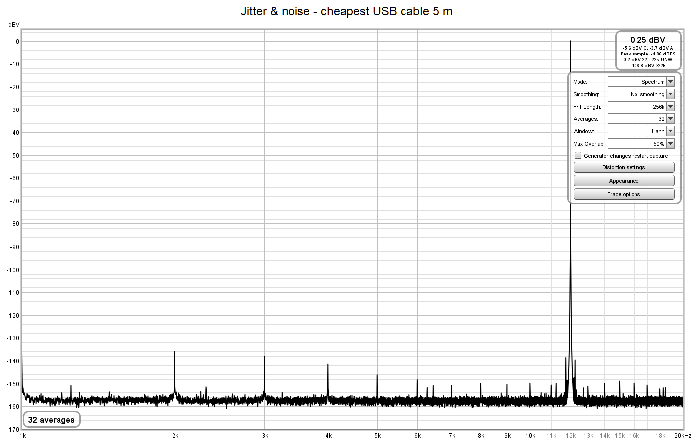

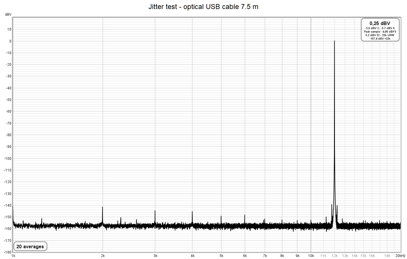

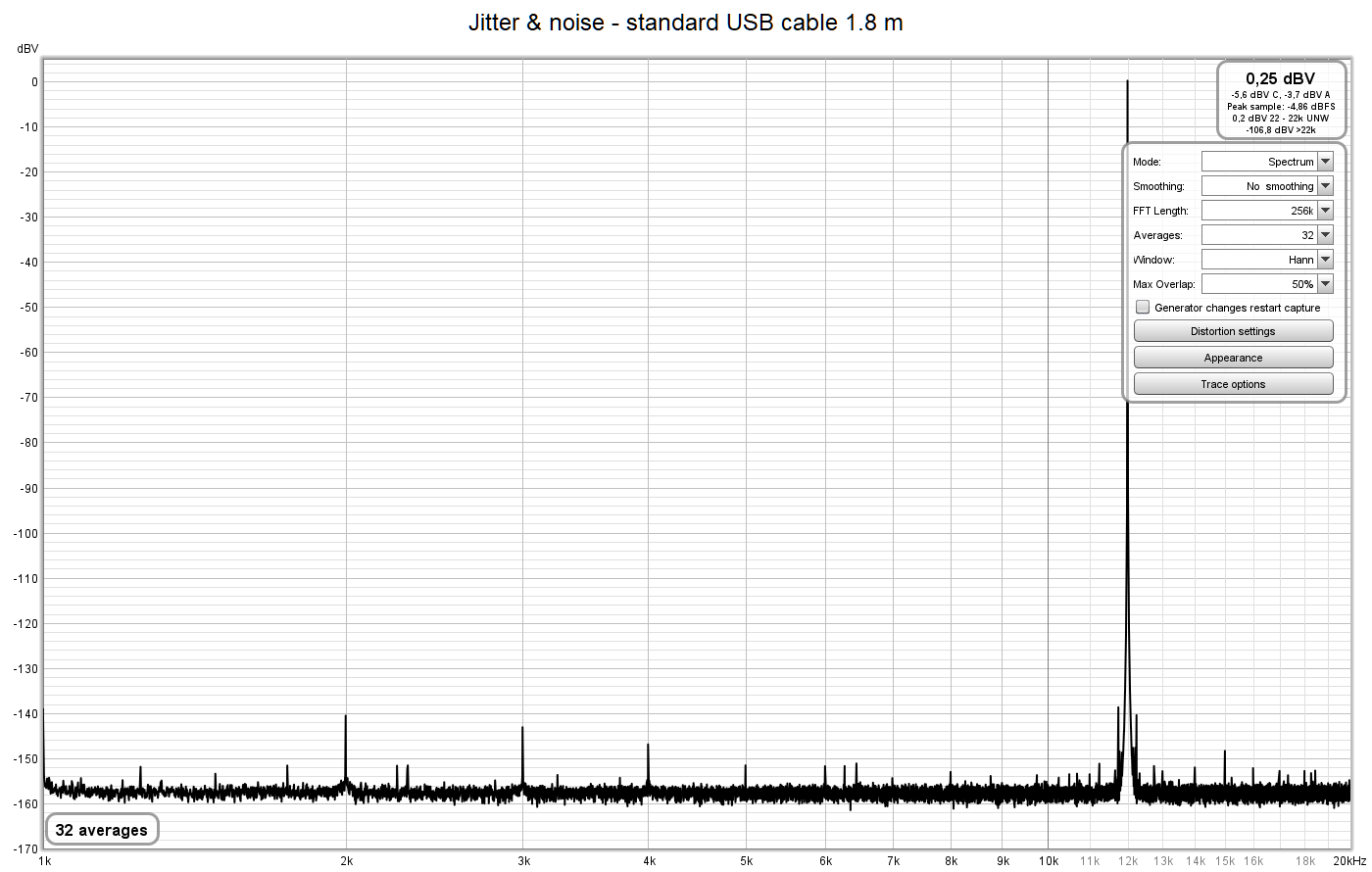

My only concern was if two additional active conversion layers (USB -> optical -> USB) could introduce noise and affect jitter. Measurement dispel all concerns. Jitter is unaffected (as it should be) and noise is lower than with short standard USB cable.
How does it sound? Absolutely fantastic, as does a standard USB cable. ;)
My system had no noise problems or ground loops, so new USB cable can’t change anything dramatically. There are some nuances but I’m aware how unreliable is our subjective evaluation. More listening should follow.

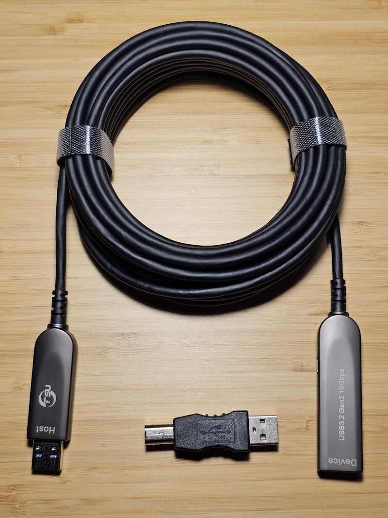

But, I’m now able to guide cable all around room in the unobtrusive way and don’t have USB 2.0 length limitations. Connectors are encased in metal alloy and are barely warm to touch in operation, which is not the case with all optical USB cables. This model (FSU USB 3.2 extension cable) is available at many AliExpress stores in lengths from 5 to 50 m. If ordering, you should pick USB 3.2/2.0 version and corresponding adapter for DAC. With Windows, this is plug & play adapter that works immediately without additional drivers. For the resulting performance, price is a bargain.

IIUC the cable just transfers the data signal over optical, incurring thus lower delay than the twisted pair over longer distances. The cable stil carries the ground wire required for the common-mode USB signalling, the cross-section picture even suggests 5V are transferred too. As @TNT said - no galvanic isolation, IMO.
Joined 2019
There is no galvanic isolation. Two fiber optic strands + 2 wires to carry supply for the optical -> USB convertor on the other cable side. Only data transfer is galvanically isolated and safe from any noise interference.
