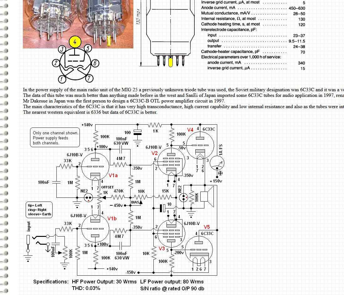

Mine is a little different:
My struggle is: if I need to shift 6C33C common (1-PSU) heater voltage base-potentials onto HT3 and HT4 which are on 2 separate anode voltage circuits
1. can I do it at all ?
2. if yes, I assume there's no difference if I use HT3 and HT4 of the left side anode voltage circuitry OR the right sides's circuit.
3. if I can't do it, would it make sense to use the 2 anode-voltage transformers in parallel and be okay with 1 bigger anode-voltage PSU ? (1 full-rect. bridge and everything behind that, feeding both Lelf and Right audio circuit so there are only 1 common HT3 and HT4 points for left and right side tubes).

Vortex if you want to make the LEFT and RIGHT channel separated like 2 independent mono blocks you must separate everything, you must build 2 PSU, with 2 transformer etc., even the ground should be separated and insulated from the chassis, that involve insulate the input plug and speakers post also, in this way you have 2 mono block in the same enclosure.
In my opinion do not try to make one HT3 and HT4 common for the 2 channels while the PSU are separated, the only thing that can be common are the heaters, I hope can help....

Okay, this is where I am right now. 2 separate PSU-s, 1 common heater transformer.In my opinion do not try to make one HT3 and HT4 common for the 2 channels while the PSU are separated, the only thing that can be common are the heaters, I hope can help....
Looking at the original schematics, V5's heating shall be connected to HT4 (-150).
Due to common heater transformer, I have 2x V5 tubes heated by the same transformer, it's a parallel connection from the transformer taps.
So, Left side V5 is heated from the very same transformer like Right side's V5.
HT4 is available at PSU side. Either left or right.
To which side's HT4 connection would you connect the common heating of the two V5 tubes ? (If doable at all).
Same for V2-V3, heater is a small transformer, but common for both sides, so 4 small tubes' heating shall be connected to HT3 (-450V) but I also have 2 HT3 connections due to separate PSU parts. Left and right.
To which PSU's HT3 shall I connect the common heating of V2-V3 tubes ? (If doable at all, again).
So at the moment I see 3 way outs:
1. fine so, choose for the common heaters whichever side's HT3 and HT4 points.
2. don't do point 1, instead do following: give up separate PSU idea and connect the 2 PSU transformers parallel, build 1 PSU after it for both sides and use that for both audio circuits. Heater potential issue is solved then, there will be only 1 common HT3 and HT4 point for both sides.
3. don't do point 2, separate heating of left and right side too with an additional heater transformer identical with the existing one, so the full-monoblock setup is then also valid for the heating circuits itself, each side's heating is ran from its own heater transformer and connected to its own HT3 and HT4. -> additional money and a second chassis probably due to space issues then. Which is a viable option but not the best one due to cost and time.
So I'd strive for 1 or 2, if possible from electrical point of view.

Hi Vortex!

So just to make sure I understood correctly:
- Power cord arrives into the chassis via 3-pole IEC connector
- chassis can right here be connected to PE (or not yet?)
- isolated PE cable runs within chassis to stereo input pot's GND legs (this will be the star point)
- chassis is connected to this star ground point via aforementioned extra passive elements
- the 2 ground buses for L/R sides also connect here (and can be seen actually as 1 ground bus )
I assume I do NOT connect chassis yet to incoming PE at the IEC terminal's inner side but let the PE isolated cable run inside to the pot and this is the only point where chassis is connected to PE, right ?
Answer to first section of Your question:
Answer to the second section is:
This means the chassis and system ground are "separated" or the system ground is a bit "elevated" with regard to chassis, causing the best and shortest path for signal to move. Not through the chassis material and bolts or around who knows which corner. Hope the explanation was´nt too complicated
- Power cord arrives into the chassis via 3-pole IEC connector - YES
- chassis can right here be connected to PE (or not yet?) - YES
- isolated PE cable runs within chassis to stereo input pot's GND legs (but is not connected to these directly!)
- the 2 ground buses for L/R sides also connect here (and can be seen actually as 1 ground bus - CORRECT!

Any further comments on my previous questions ?
Which HT3 and HT4 points to pick for the potential-shifted heaters ?
So, I have the minus-potential HT3 (-430V) and HT4 (-150V) points twice: Left side amp PSU and Right side amp PSU.
The original schematics tells us to connect V2+V3 heater potentials to HT3 and V5 to HT4.
Okay, but which HT3 and which HT4 ? Left or right ?
Again: common heater transformers (1 for ALL small tubes + 1 for ALL 6C33C tubes) and separate PSU circuits like in a monoblock design.
Transformers have 2 secondaries: 1 for GND potential and 1 for the shifted potential heaters.
Would it smoke if I connected all V2+V3's heating (4 tubes!) to let's say left channel PSU's HT3 for the potential shift, and connect V5 tubes (2 tubes!) of left and right side to the right side PSU's HT4 ?
- I have 1 heater transformer for ALL 6C33C tubes (with 2x 12V secondaries, one intended to be on GND potential, the other on HT4 -150V).
- I have 2 separate transformers for the amp part itself, so multiply original article's PSU by 2.

well due to the fact that you have two separate PSU you can then choose to use HT3 and HT4 from the right or left PSU, I do not see any problem but of course the ground bus must be one.
I connect the the 4 V2+V3's heater together no problem, they have just 200mA so for the 4 in parallel 6.3v 1A secondary will be enough
When the PSU's are done test without tubes that all tension are correct
