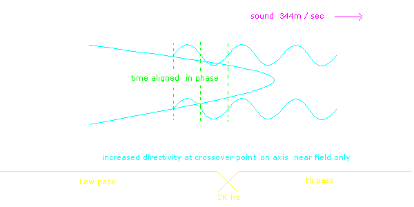

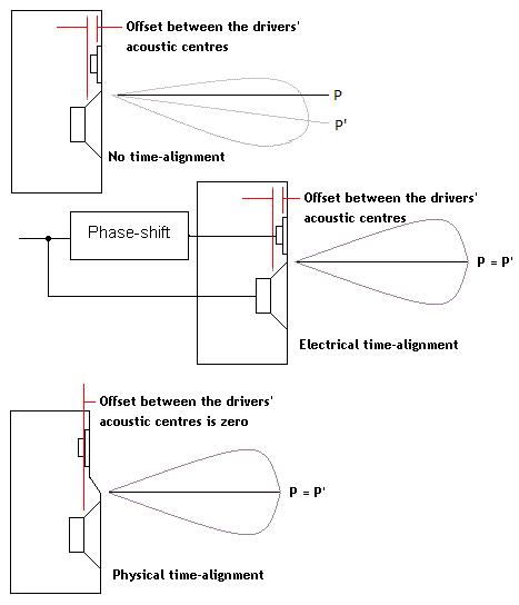

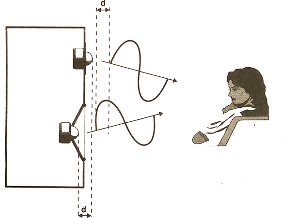

Hey guys,
I want to implement passive time alignment to my passive 3 way xovers, doubts:
1-What's the correct position to calculate the delay:
a/ The middle of voice coils?
b/ The dust caps?
c/ The middle of the magnets?

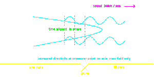

2-What's the better solution:
a/ Physical time alignment delay moving the tweeter & midwoofer to the same level as the woofer?
b/ Electrical time alignment delay using a phase shift added to the xover?
Attached pics of all that I seen on the net.
TIA
Felipe
TM is right that the correct way is to measure with Holmimpulse or REW. The mechanical distances are not reliable indicators of the phase tracking of the drivers. Certain mixed crossover alignments can produce time and phase offsets. Look into "Quasi-Optimal" crossover designs. It is possible to add delay elements to the crossovers, but proper implementation is very difficult and complex. Zaph's ZD5 is one examplehttp://www.zaphaudio.com/ZD5.html url
b/ The dust caps?
Any or none; this is a complex / variable condition that depends on driver design & use, so you're better off measuring if at all possible to establish the acoustic centre.
Since 'better' is also a floating point that depends on design specifics, either or neither. Not that it matters, by nature I'm inclined to always look for acoustic / mechanical solutions to acoustic / mechanical 'problems' first. However: physical time alignment, via a stepped or sloping baffle has its own issues, notably the potential for additional diffraction etc., and this can (can) get worse the larger the required offset. So a passive delay network, providing you have the data to do it, may sometimes reduce these compromises, while not being without some itself -notably the fact that they can be difficult to design (this can be overstated -the two I've done took a bit of work but no more) and require more components, increasing cost. YMMV.

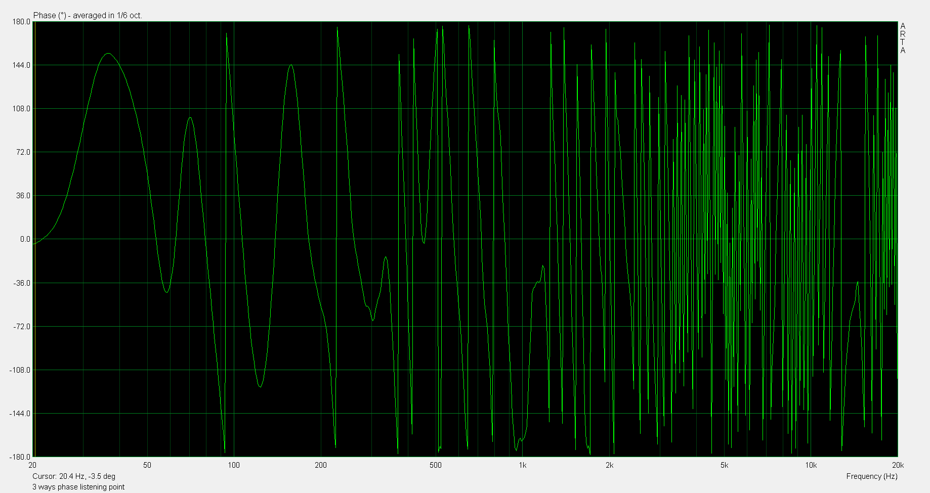

Joined 2009

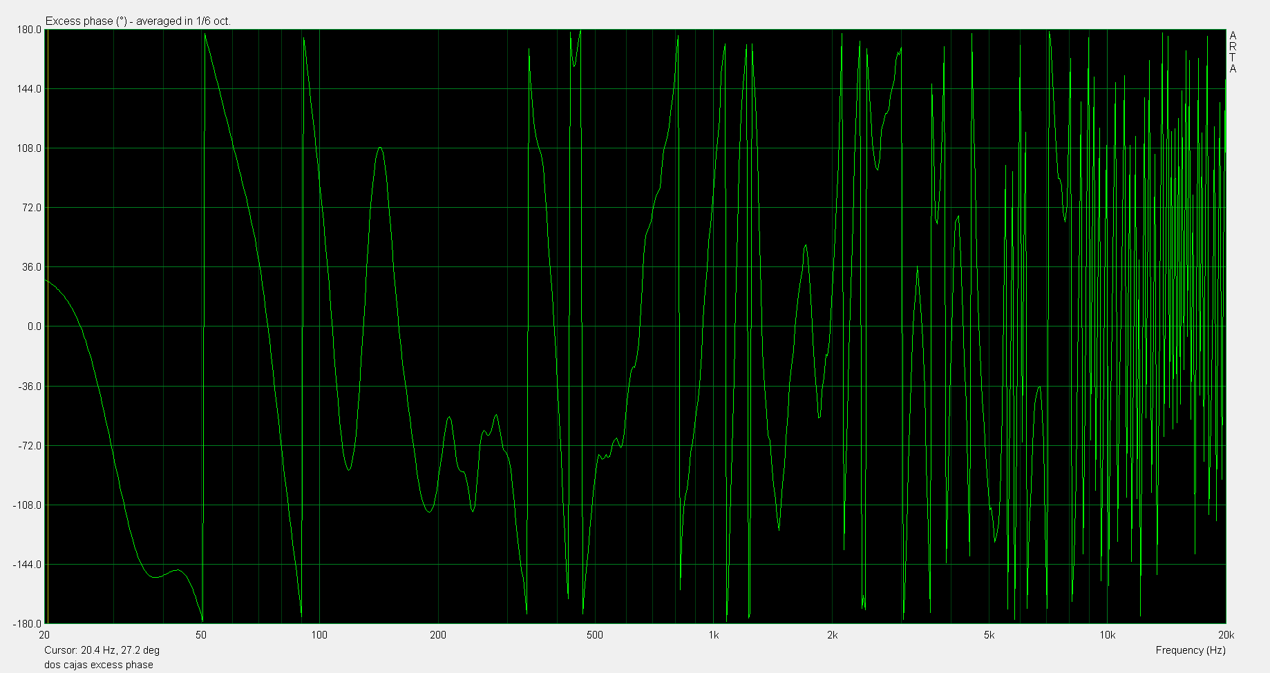

Attached phase measurement at the listening point, smoothing 1/6.
Post 4 is the phase measured with ARTA.
you need to choose a suitable setup for useable data
thus for some intial testing to get you going, i would set up your mic on axis with the tweeter and say 60cm away from the baffle
then, take an f/r of the tweeter only, and then of the mid(midbass) only

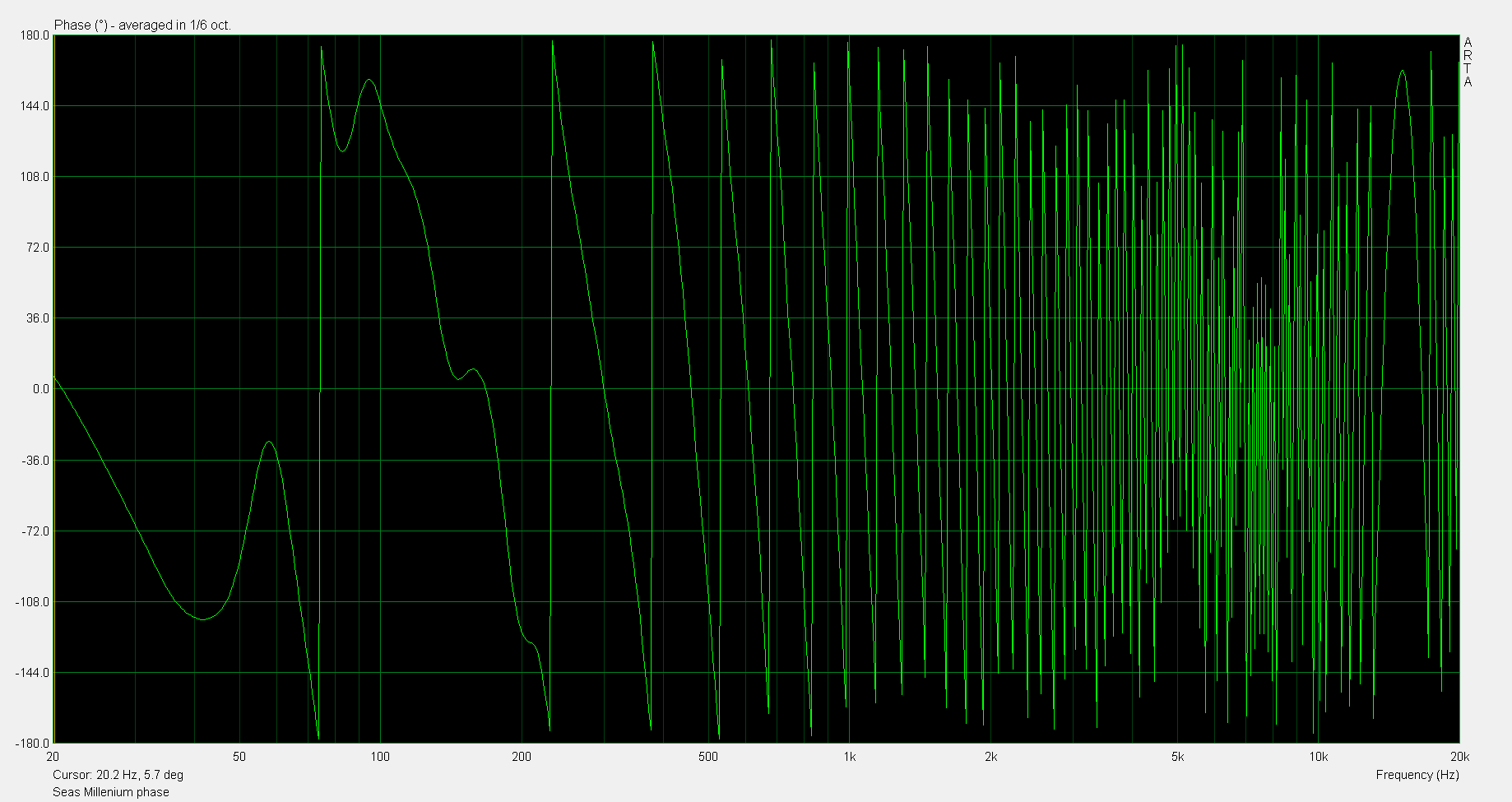

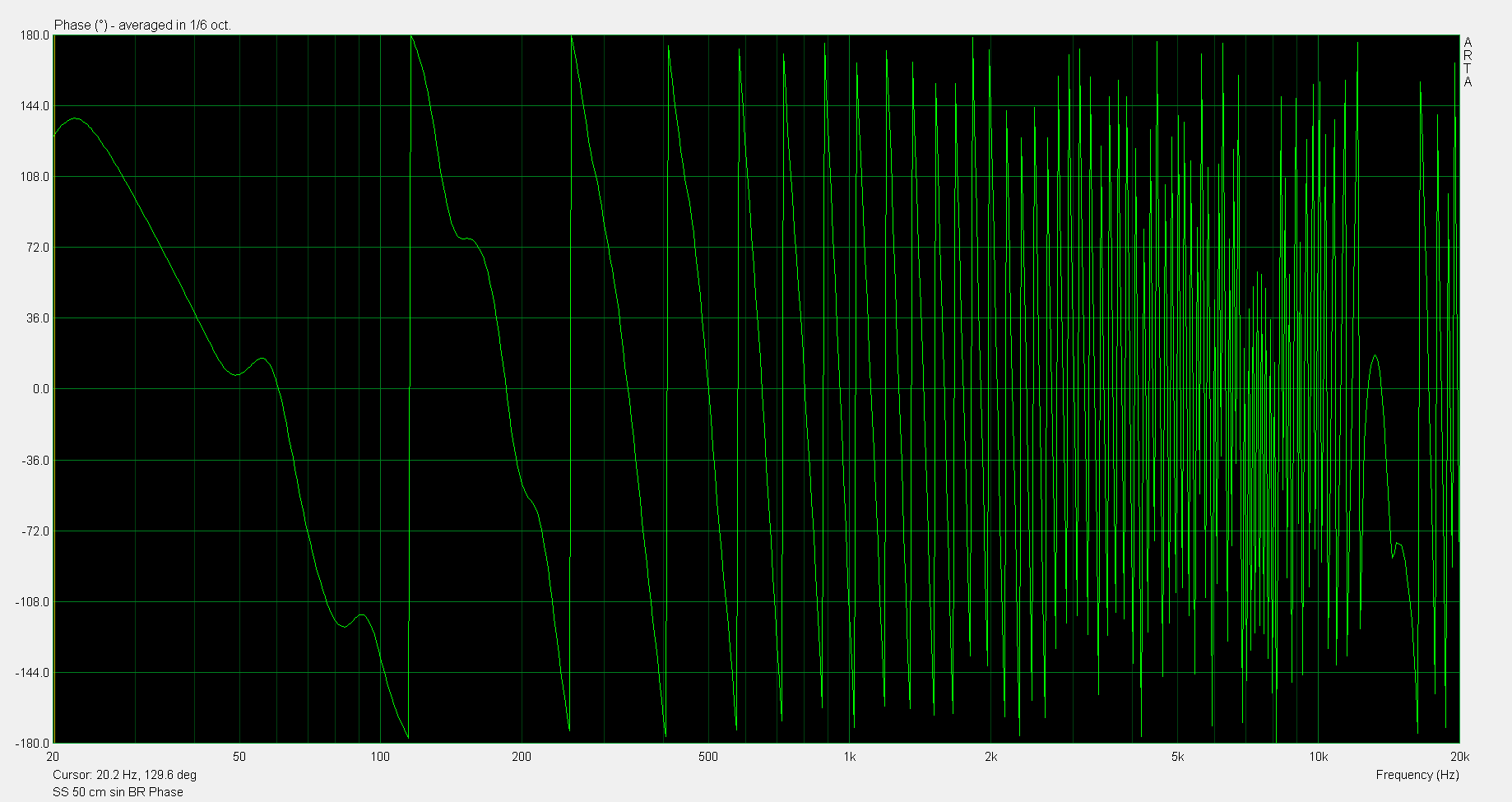

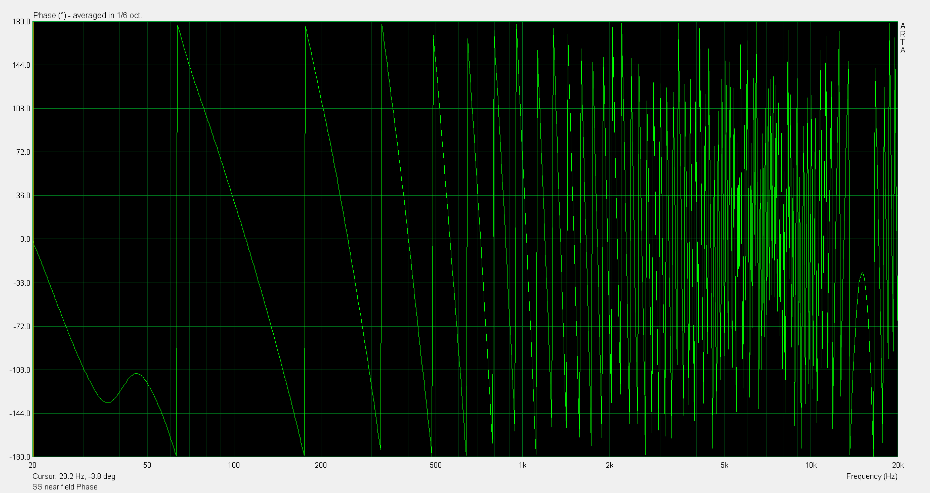

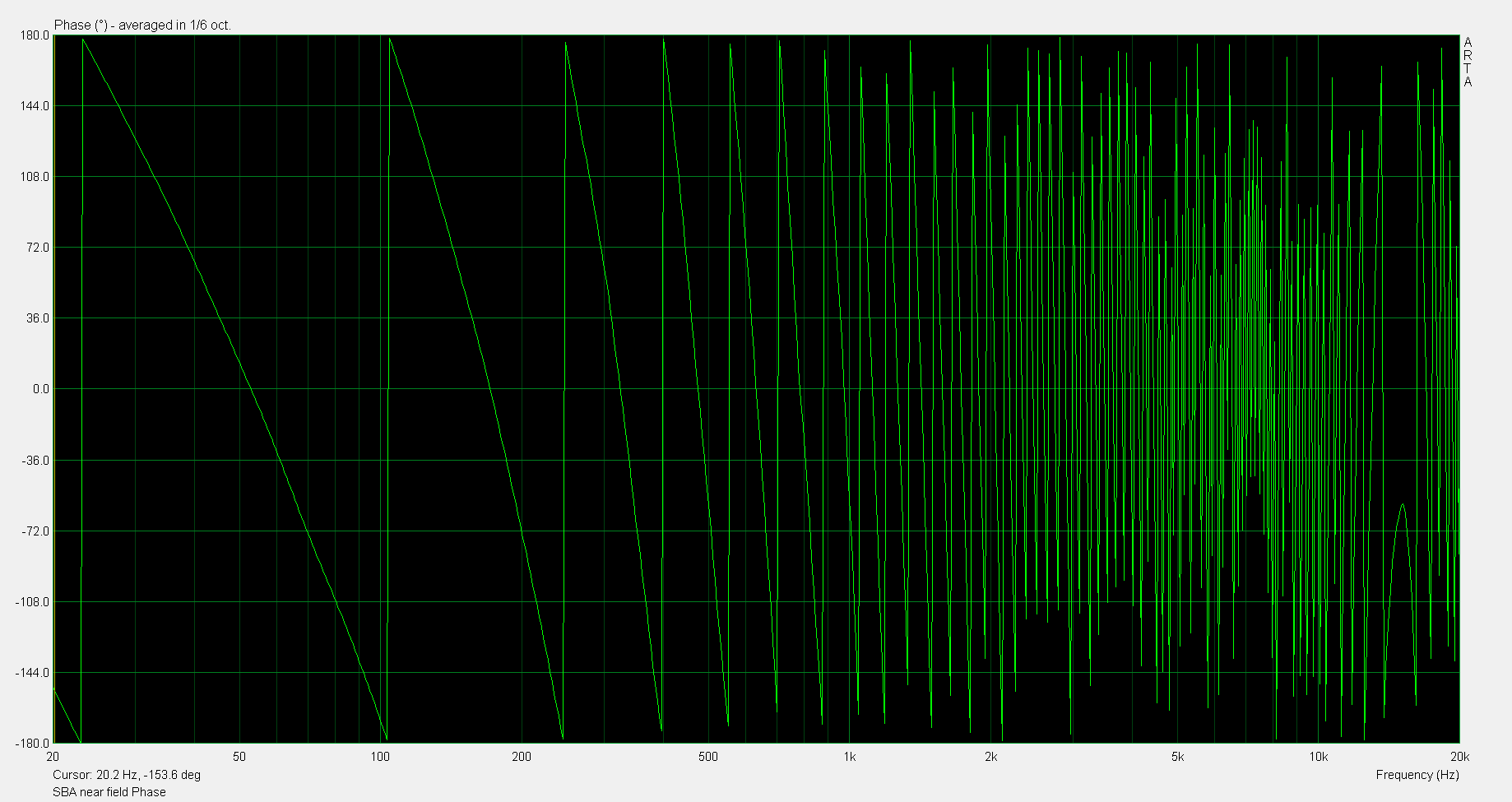

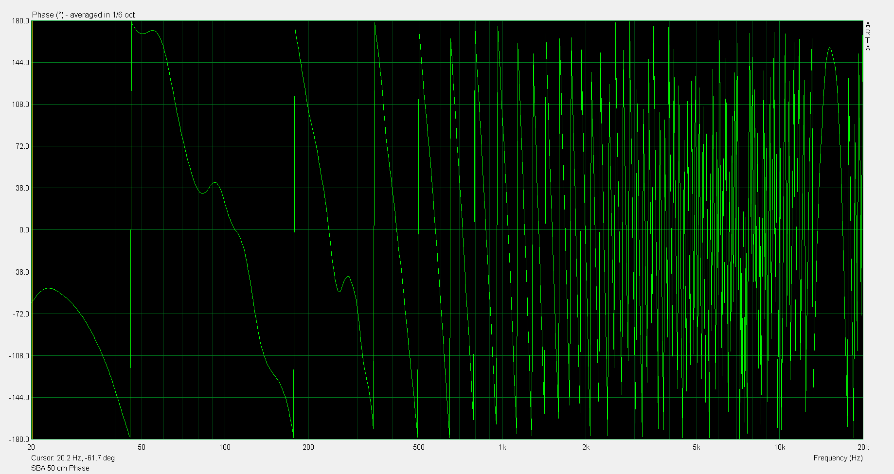

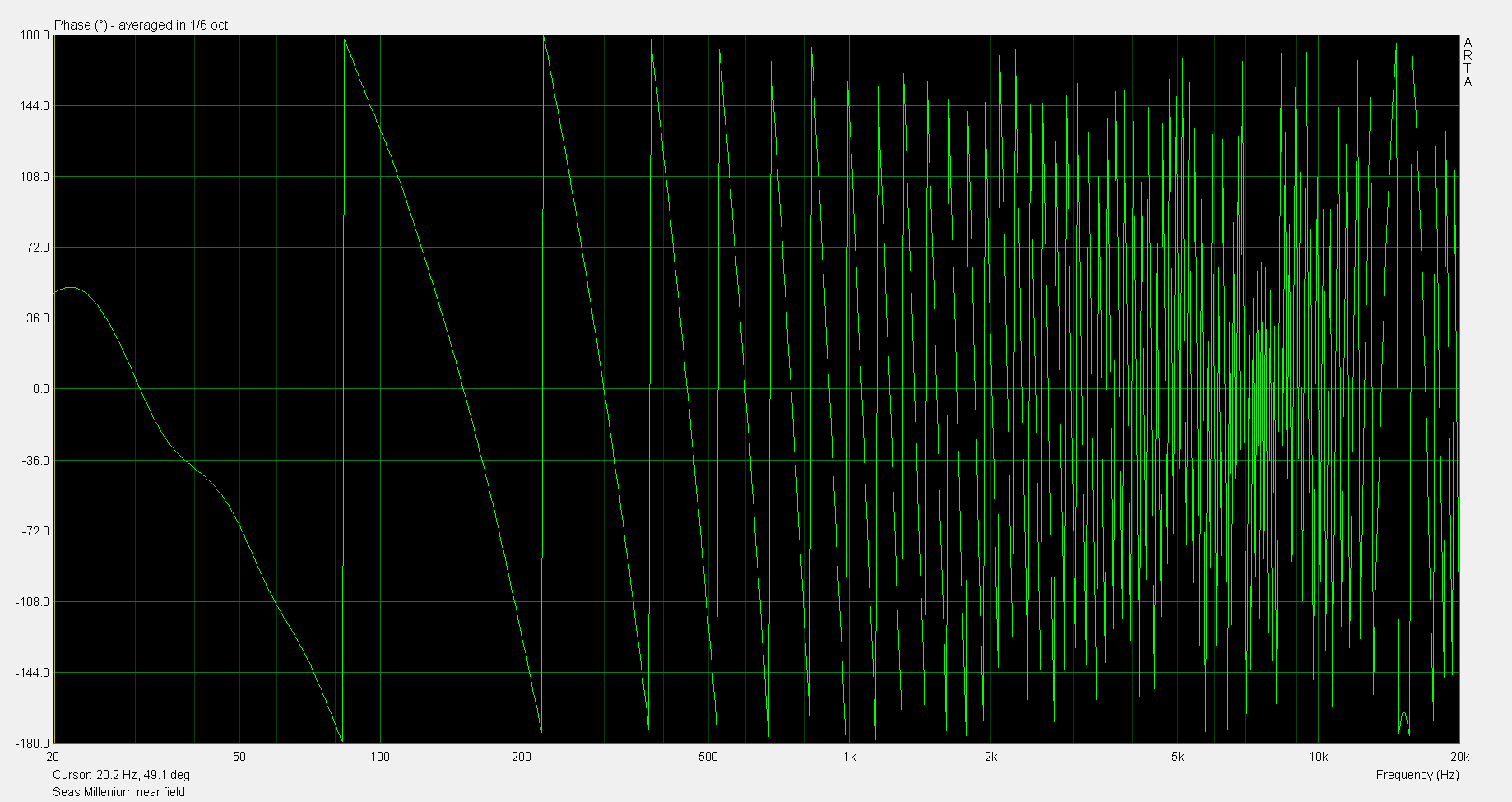

Joined 2009
Attached pics with separate phase of each driver.
Looks like you have to read these instructions for ARTA users and study several different diy project "stories" from kimmosto, Krutke, Gravesen etc.
Then decide which design/simulation program you wil be using.
https://kimmosaunisto.net/Software/VituixCAD/VituixCAD Measurement Preparations.pdf
If you are planning a dsp-controlled system (Hypex FA, minidsp etc.) you can set delays by doing acoustic measurements and looking at impulse/step.
The acoustic center of sound radiation from a loudspeaker is a bit in front of a cone's dustcap and a bit behind a dome's top. But still only some coaxial drivers are "perfect" in this sense. The higher frequency xo we use, the more critical and difficult this gets. With only physical offset, we get in trouble off-axis...
Aligning by voice coils is just a broad advice for PA speakers which have a compression driver behind a horn, it doesn't suit for typical hifi speakers...
