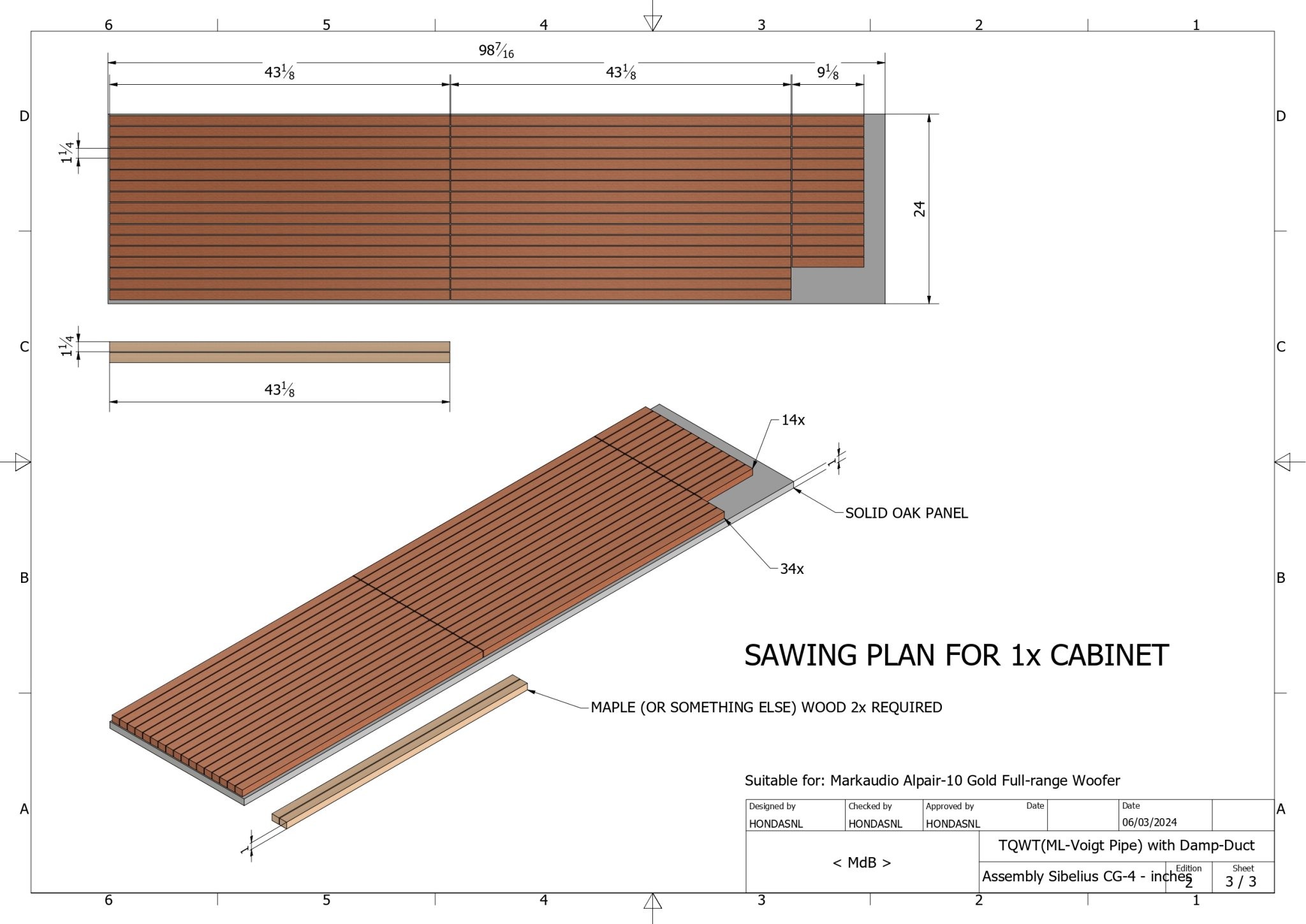

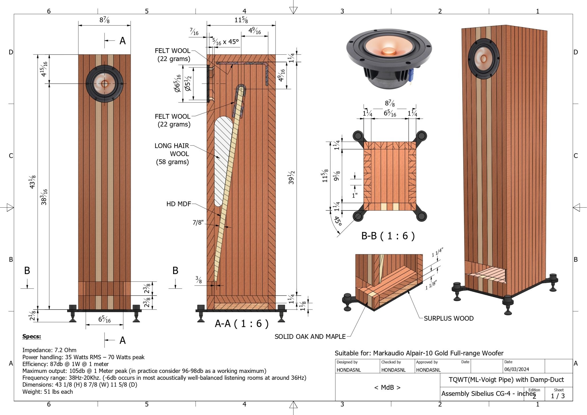

Here new version in fractional inches.
Easy setting in the program.
Only metric thread for the spikes.
