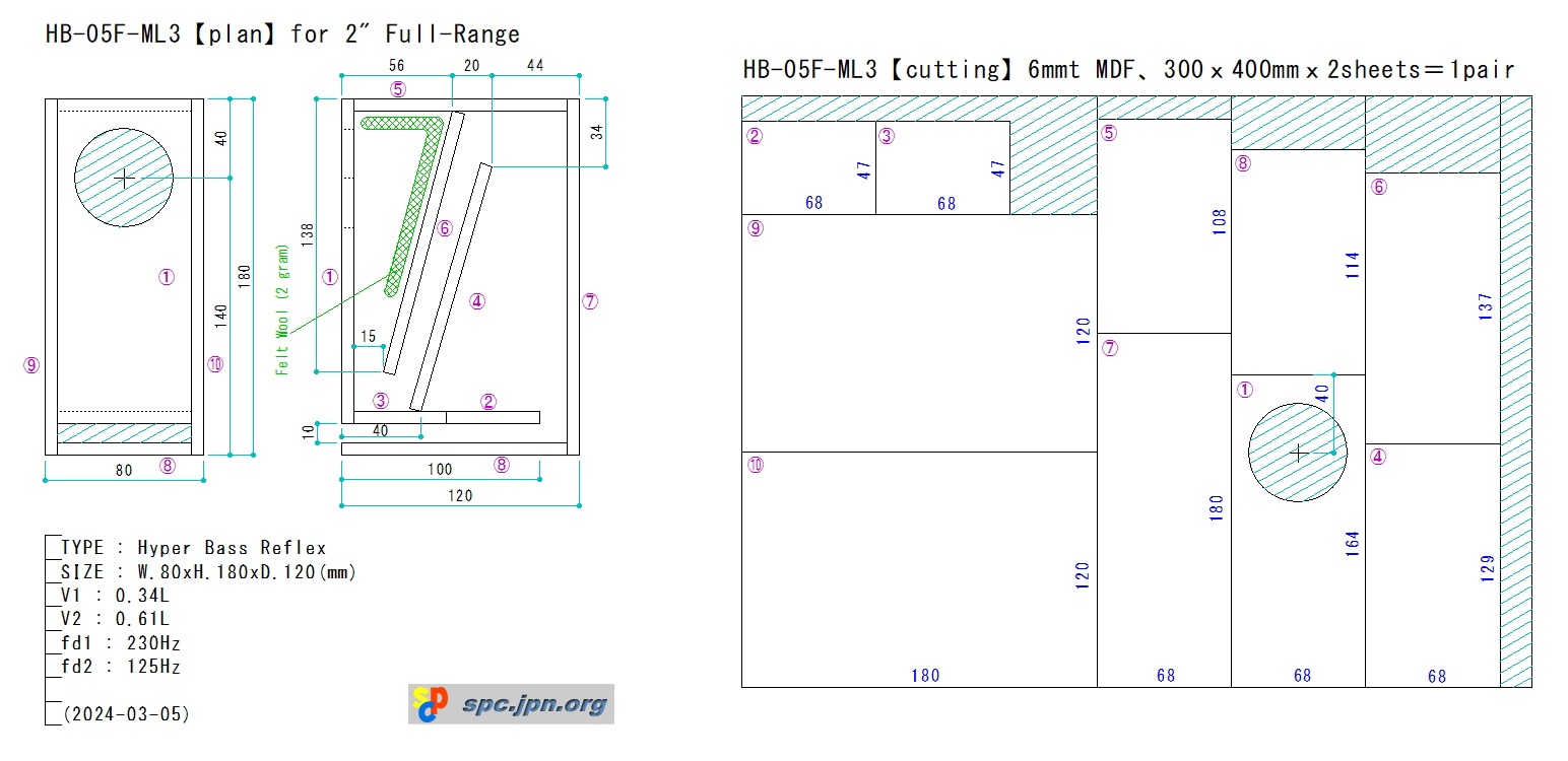

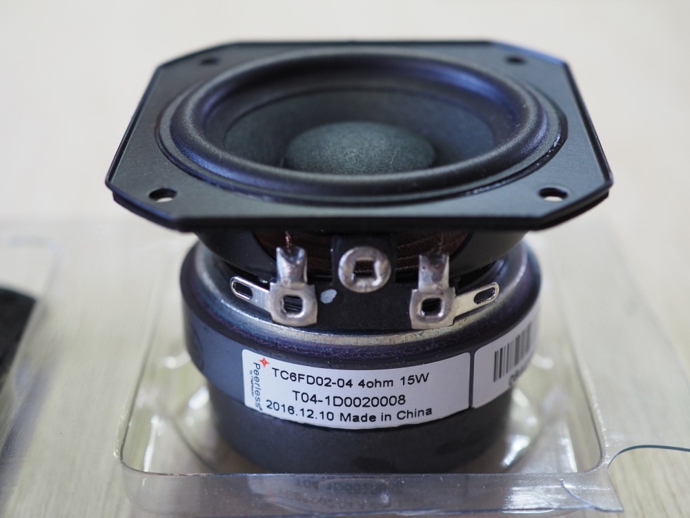

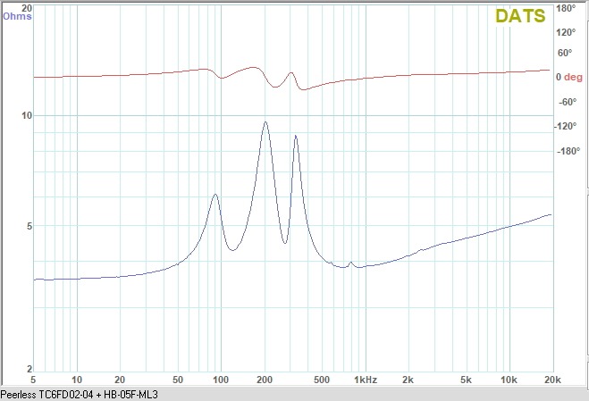

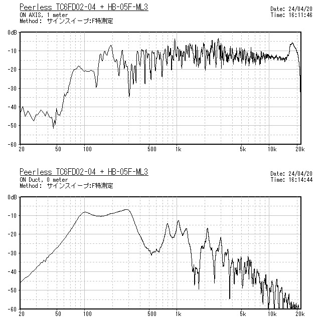

Peerless TC6FD02-04 installed in a double bass reflex. Cheep bass but great mid and high.
nandappe Member Joined 2017 sites.google.com/view/low-end-diy-loudspeaker/home 2024-04-20 11:30 am #1 2024-04-20 11:30 am #1 Peerless TC6FD02-04 installed in a double bass reflex. Cheep bass but great mid and high. Attachments HB-05F-ML3-04.jpg 109.2 KB · Views: 90 HB-05F-ML3-01.jpg 158.3 KB · Views: 99 HB-05F-ML3-02.jpg 108.1 KB · Views: 92 HB-05F-ML3-03.jpg 49.7 KB · Views: 74 Reactions: 3 users ••• More options Share DarekWawa Member Joined 2020 2024-04-22 5:16 pm #2 2024-04-22 5:16 pm #2 Baffle step compensation circuit can help. ••• More options Share nandappe Member Joined 2017 sites.google.com/view/low-end-diy-loudspeaker/home 2024-04-22 10:24 pm #3 2024-04-22 10:24 pm #3 DarekWawa said: Baffle step compensation circuit can help. Click to expand... Yes, we can use baffle steps if we need them. ••• More options Share Show hidden low quality content You must log in or register to reply here. Share: Facebook Twitter Reddit Pinterest Tumblr WhatsApp Email Share Link
