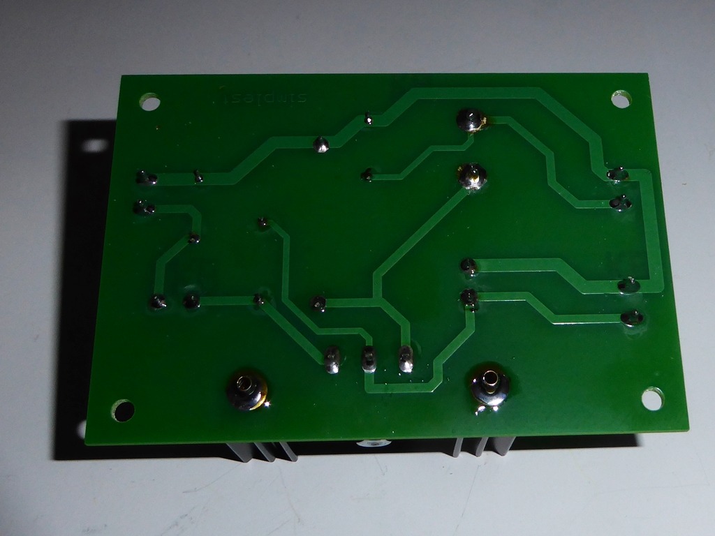

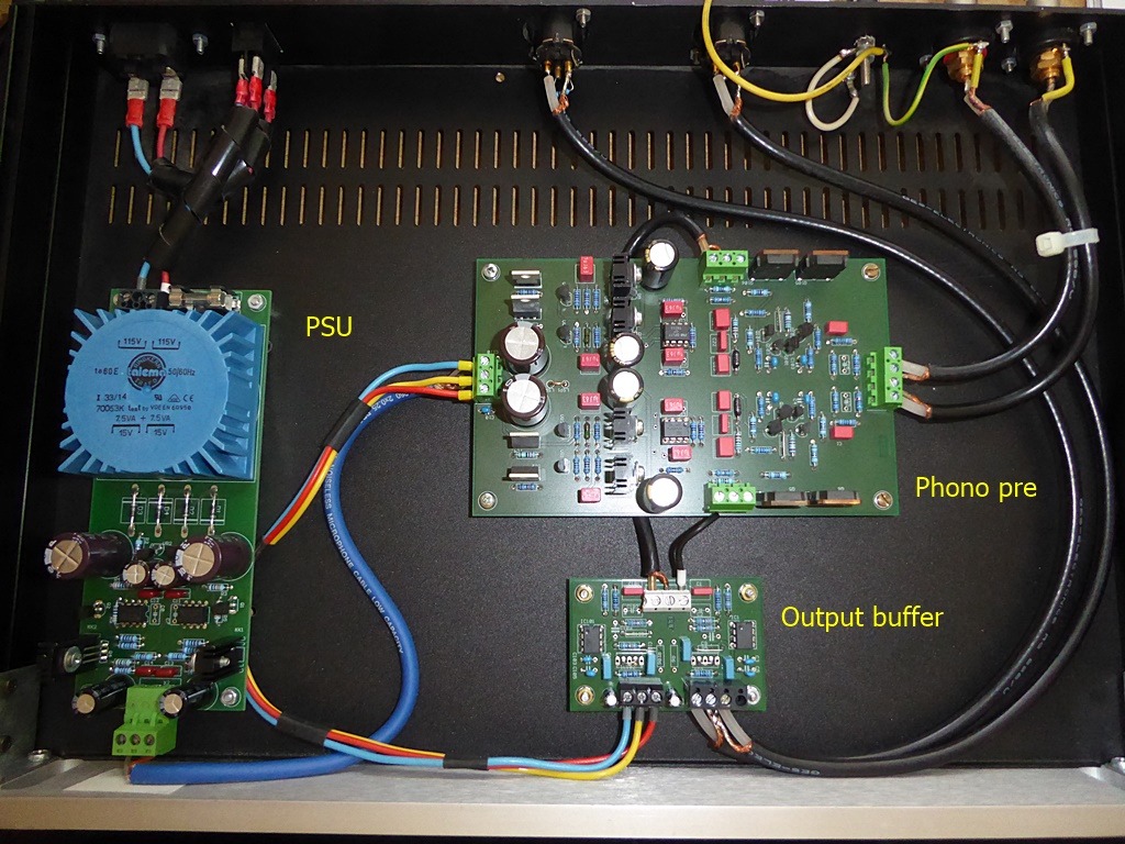

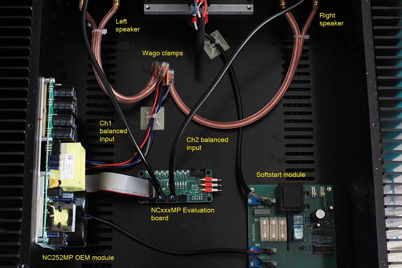

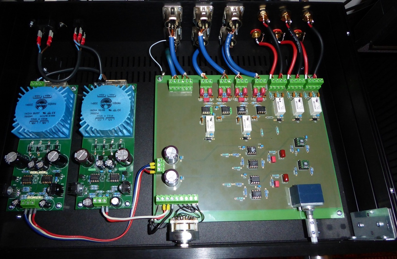

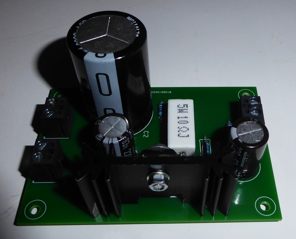

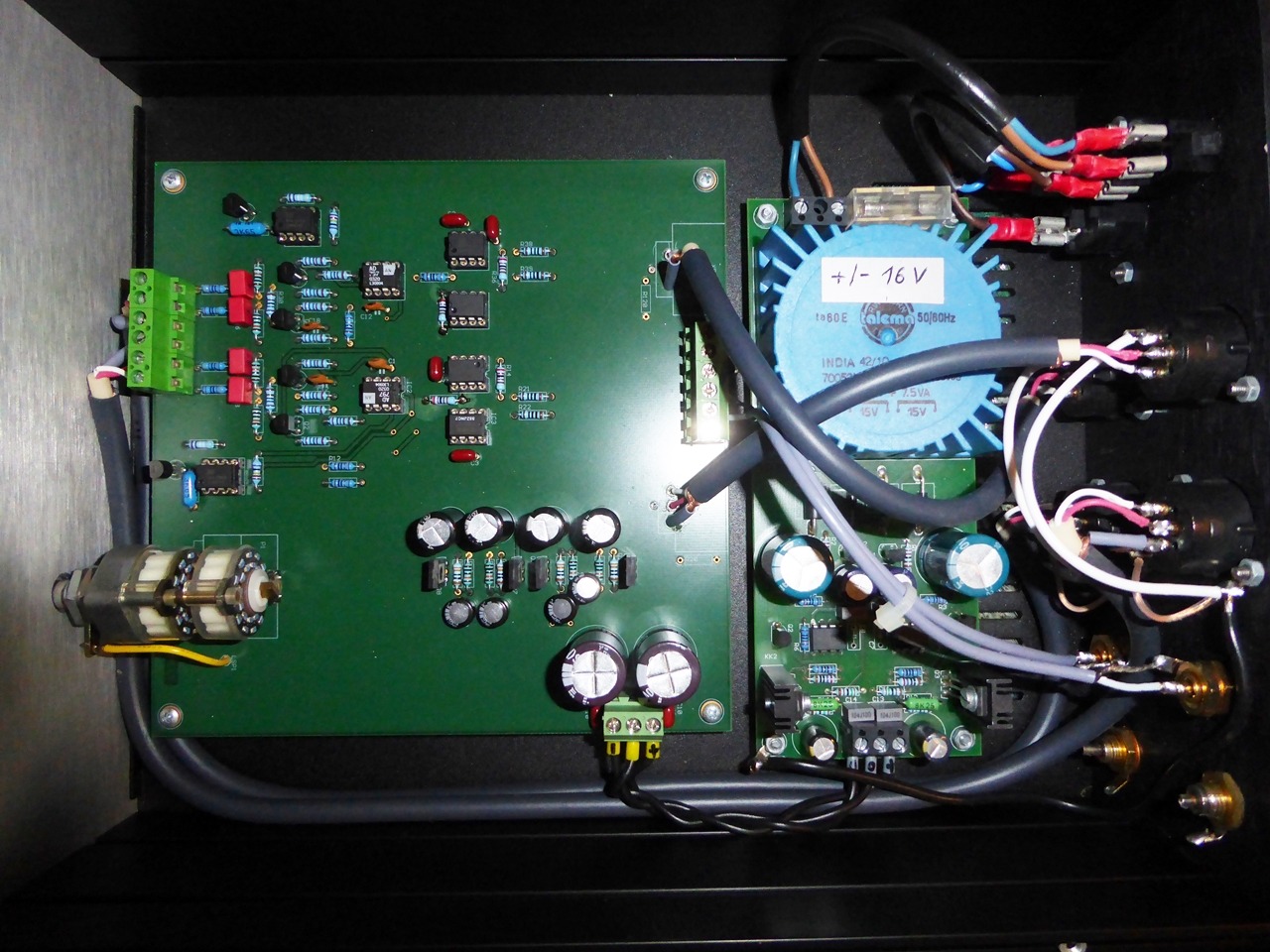

Some solid state DIY stuff of mine ...
P1050596-2.JPG IMG_3276-2.JPG P1040124-mid.JPG Phonofet+buffer.JPG PMA-NC252MP_inside.jpg A250W4R_inside.JPG P1050599_sm.JPG

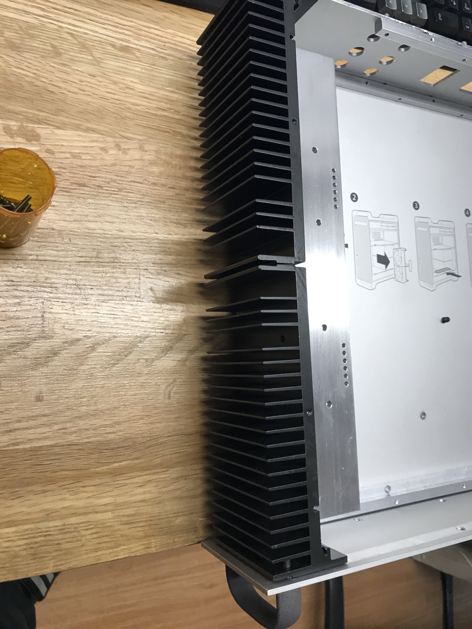

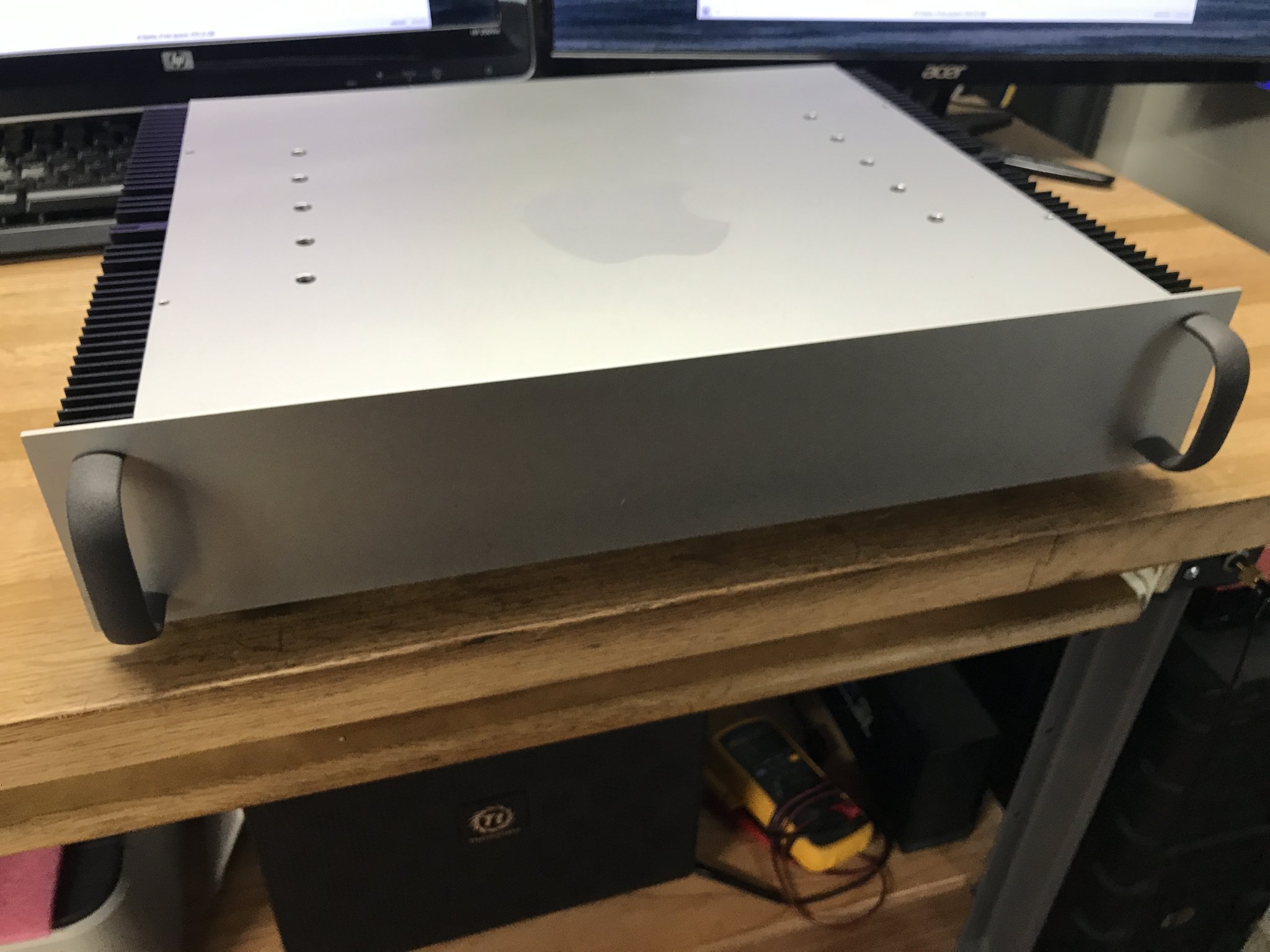

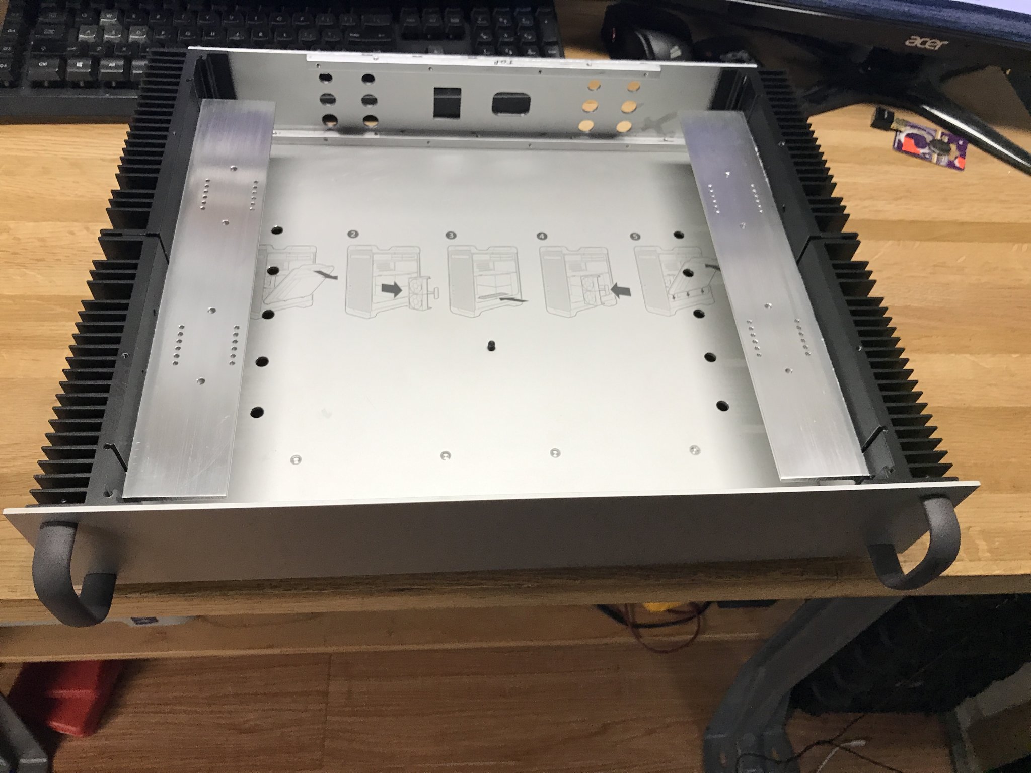

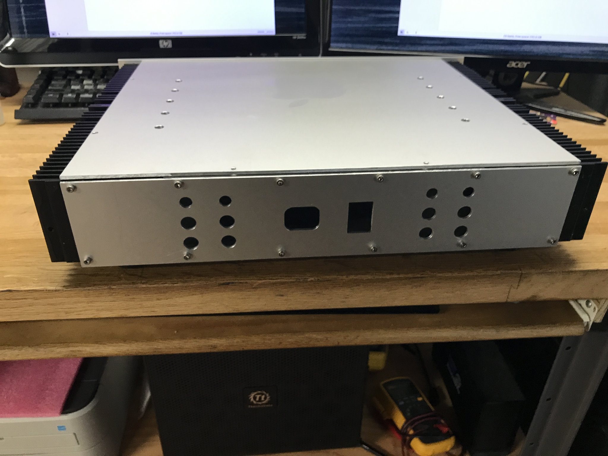

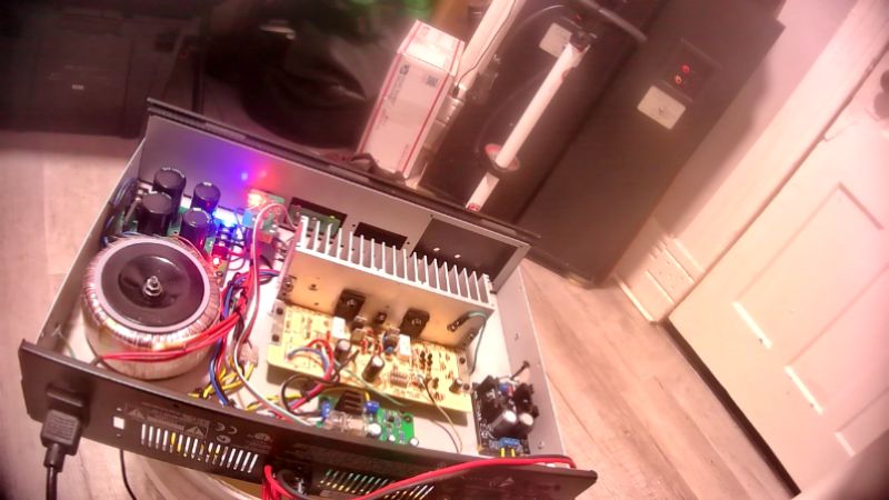

Almost done with my E-waste sub amp
Nice work and interesting. I've been working on a sub amp with an E-waste case.The front and rear panels, base and top plates are made from aluminum recovered from a long retired Apple G5 Power Mac.
This stuff has a very nice anodized finish that looks great if you can get a Mac that hasn't been beat up too much.
The heatsinks were recovered from two old servo drives that were discarded at my job. These were ripped to width, painted and paired up to form the structural sides.
The angle brackets, handles, feet and screws are all that were purchased.
I made it 2RU high and 19" wide so it blends in nicely with the rest of my gear.
Now it's time for the inards.

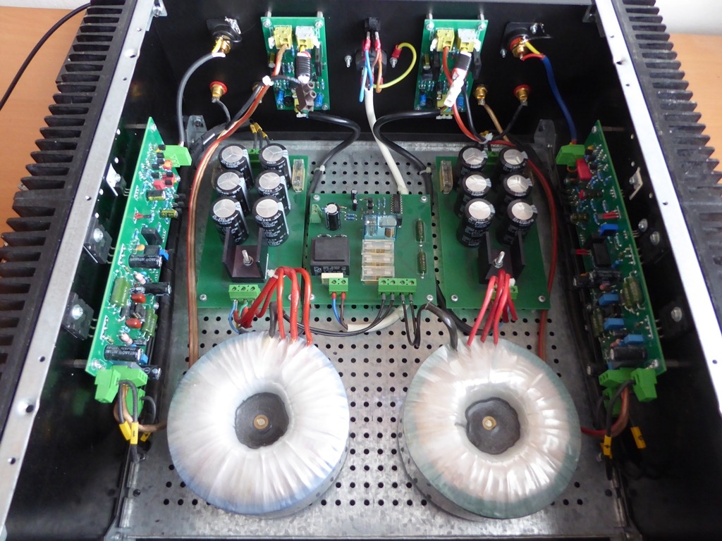

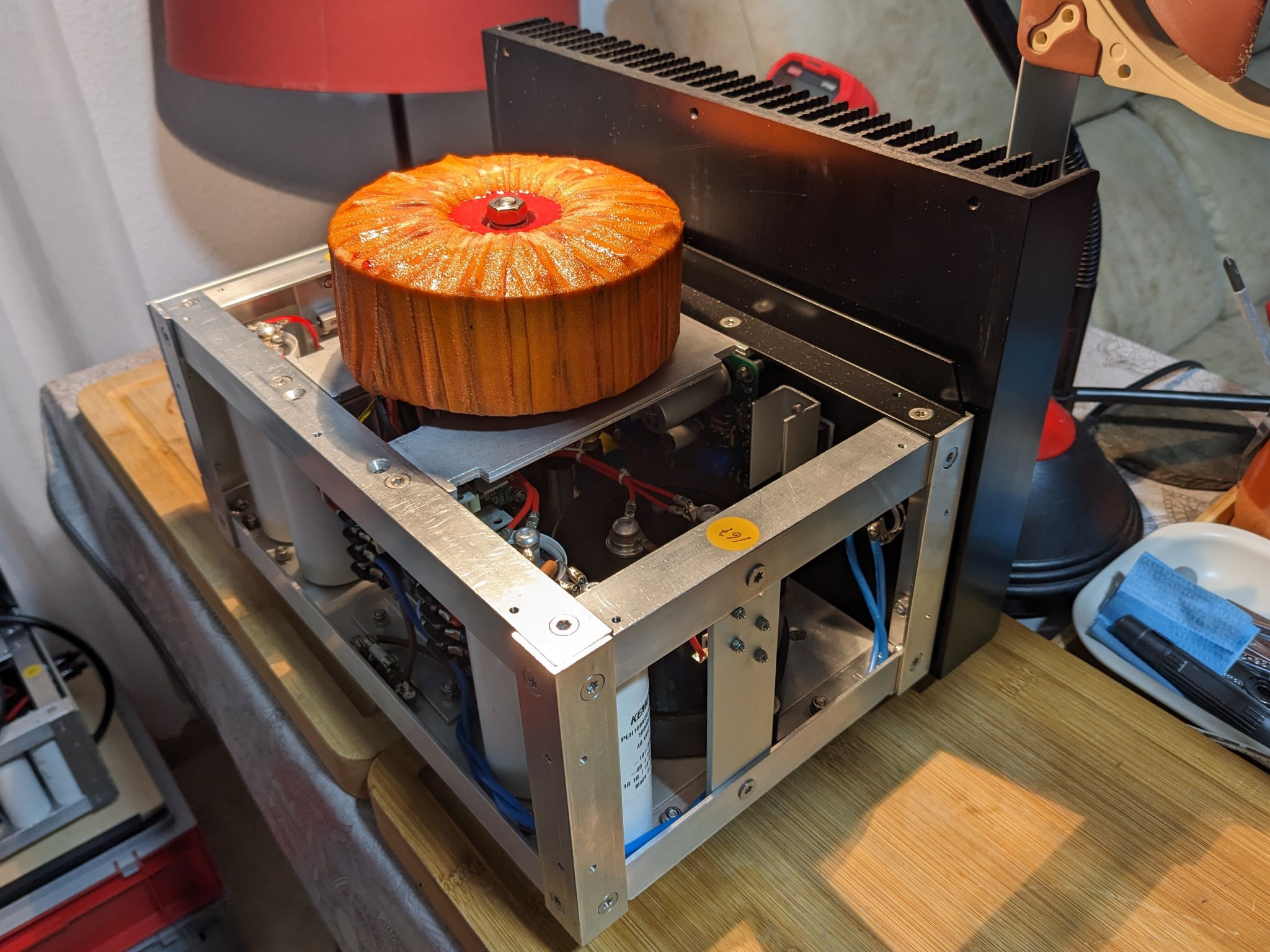

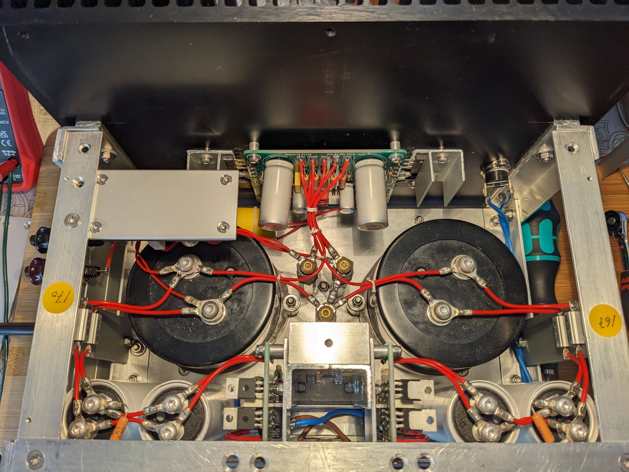

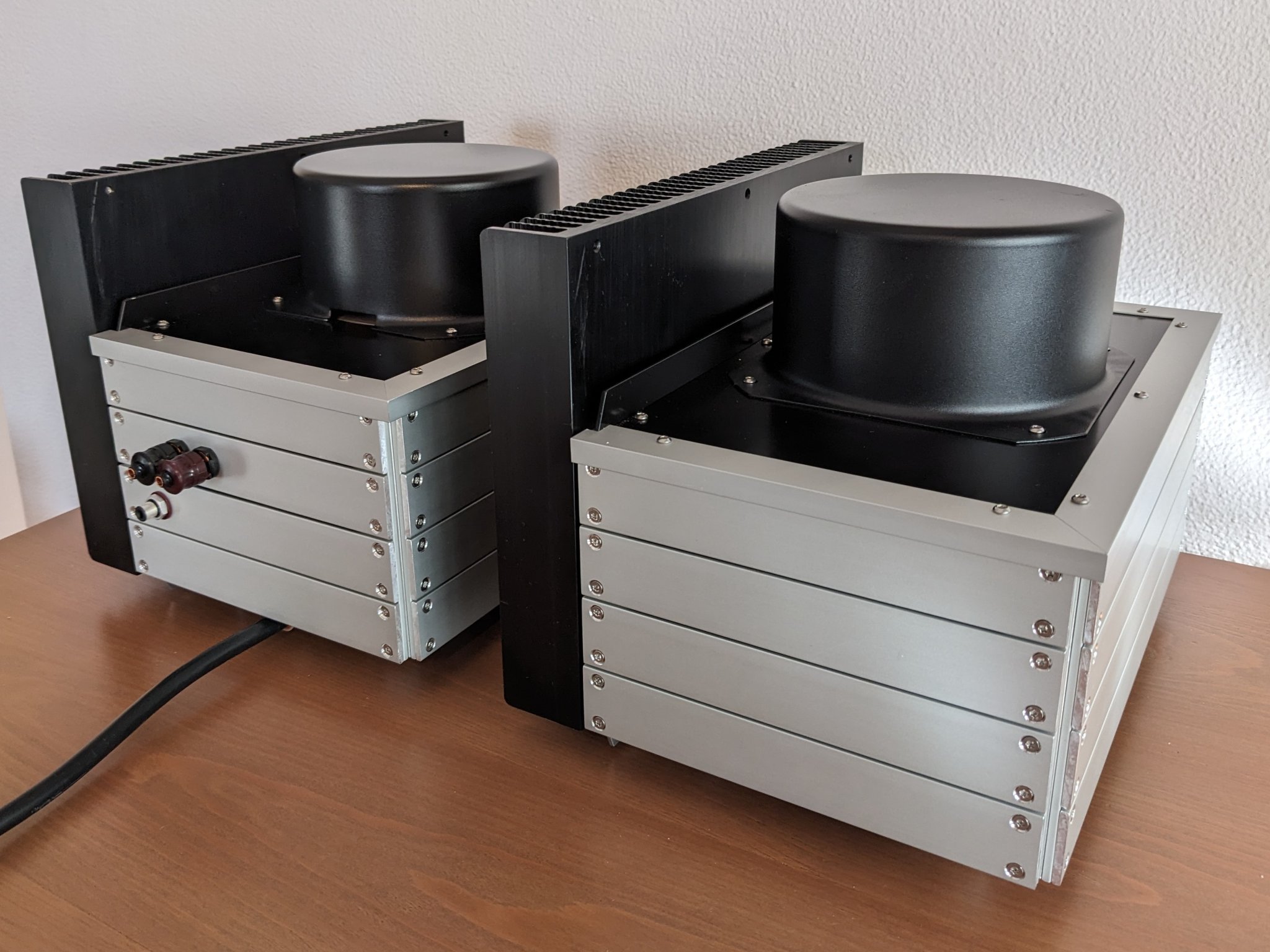

Happy New Year everyone.
I just posted this on ussa 5 build thread, but I would like to post it here as well.
I have finally finished my ussa 5.1 build.
The cases took a long time to build.
It's a dual mono build with:
400VA donuts.
LT4320 bridges.
120mF per rail ( crc ) ( 27 volt ).
1A bias for output.
xrk's ssr dc speaker protection.
Heatsink 300 X 40 H 210 mm ( 0.18° c/w ).

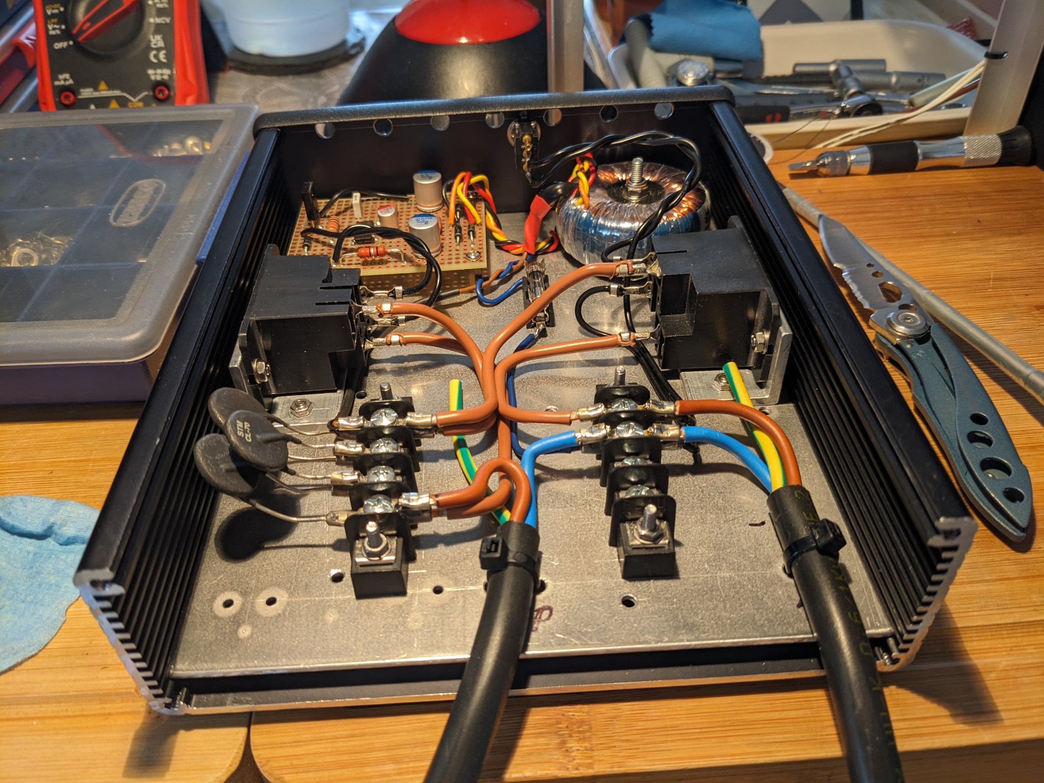

Soft start is in a separate box, common for both amplifiers.
With my 92dB test speakers ( Alpair 12p ) there is no sound of any kind at idle.
Cannot tell whether they are turned on or off.
They are quite compact and not so easy to work with but I'm quite pleased with the result.
They are still just burning in but the sound is quite promising. An easy swinger.
